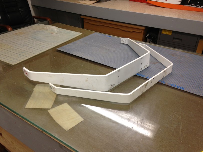

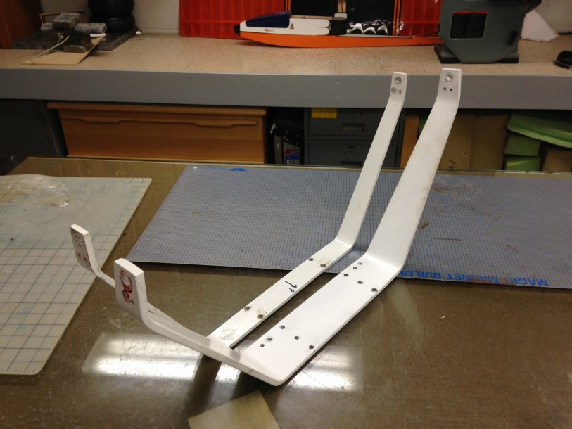

The Decathlon by design has spindly gear, add to that China metal and a 4o some odd pound plane, constant take-off and landings on rough grass... What do you get? Bending gear.

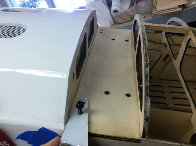

To fix this I made a quick call to TNT and we designed a different gear for the Decathlon. The new gear is as wide as the seat area, then tapers down to the bend where the axle bolts to. While not 100% scale, I think it actually looks better and definitely performs better. To make this all work, you need to make a spacer for the gear to sit on since the strut mounting tab is also bolted in this location too. A 1/8 or so plywood piece was cut to fit the gear seat area and then a notch made for the strut bracket. Carbon fiber was added for good measure ( if you're going to do it, over do it, that's my motto)
Drill the new gear to match and you're all done with that

I just regisered in , from Italy. I just happened to read about cannister tunnel length,so I thought i'd write something regarding my BH 38% Super Decathlon. I did the same mod a you did for my DA150 with KS cans and home made headers, I will post some pics maybe tomorrow, the other thing I am about to get done is the landing gear mod, A friend of mine has a machine shop and is about to mill down and cut from a piece of 6082 T6 aluminum a new gear that as you said , the supplied is very weak, I was just wondering how did yours work out? Isn't too rigid , I mean so wide and appears to be thicker also.
I designed mine to be only 5mm wider and 6.6 mm thick ...do you think it won't make much difference.
I will appreciate any advice... I got 7 inch wheels also so it will look awesome.
