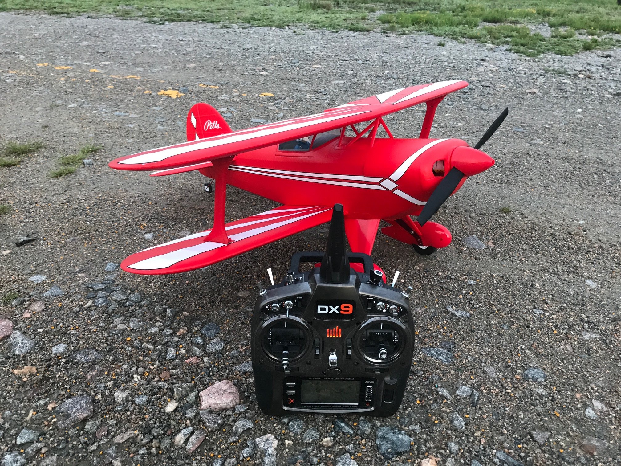

Before work maiden didn't go quite as planned. Plane flys great and here are my thoughts. Decent power on 3S so can't wait to see it on 4S. Flew slightly nose heavy as I expected for first flight with battery placement. Stalls are nice and gentle. KE had no coupling for me at all. I do think it needs more control throw all around and I will be adjusting my radio to match what I think it needs. Rolls are pretty quick but could be quicker and without more throws in the tail I couldn't get it to do a nice snap like I would like and like I have seen it do in videos. Could also be the forward CG that is affecting it a bit.

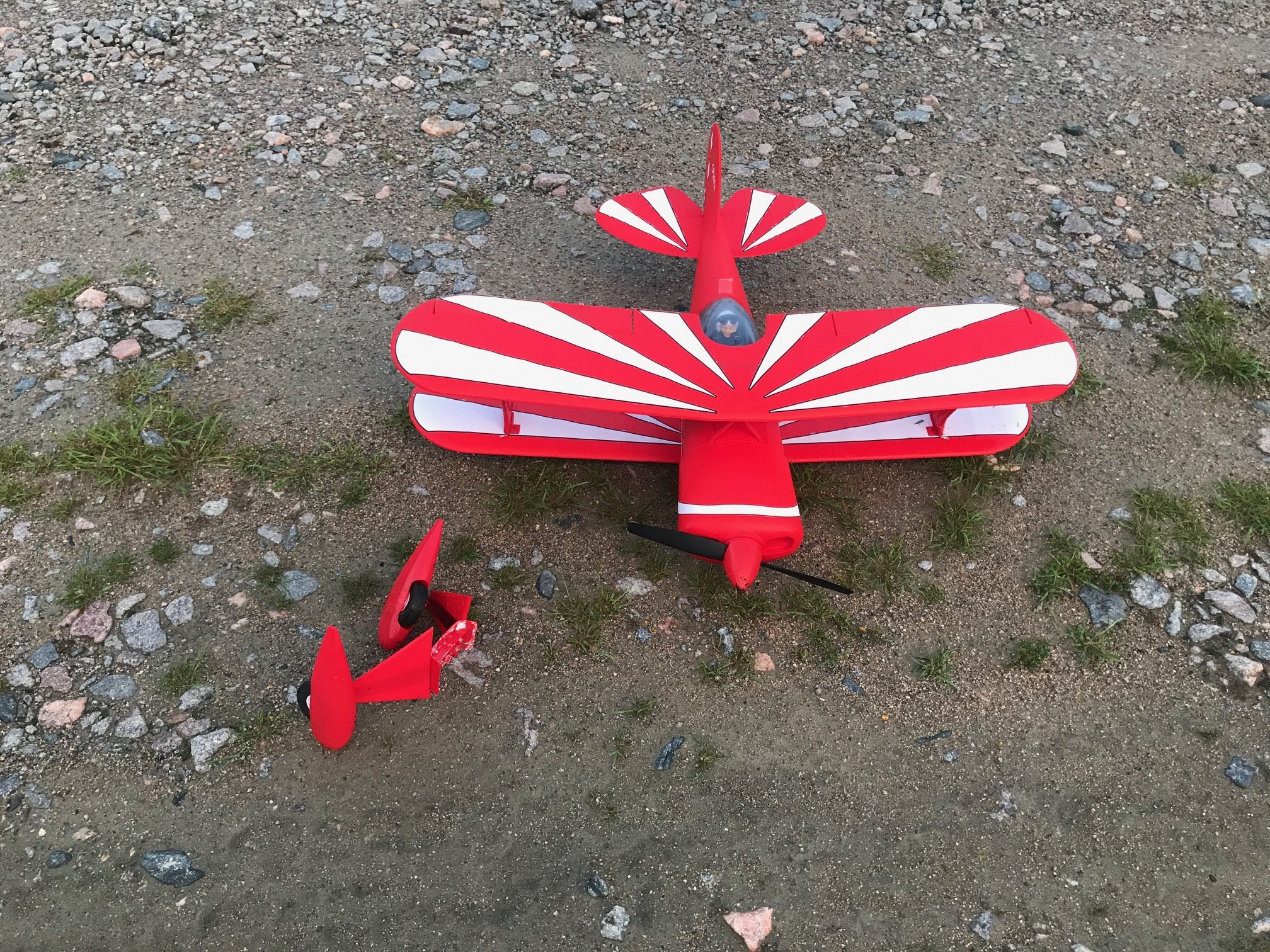

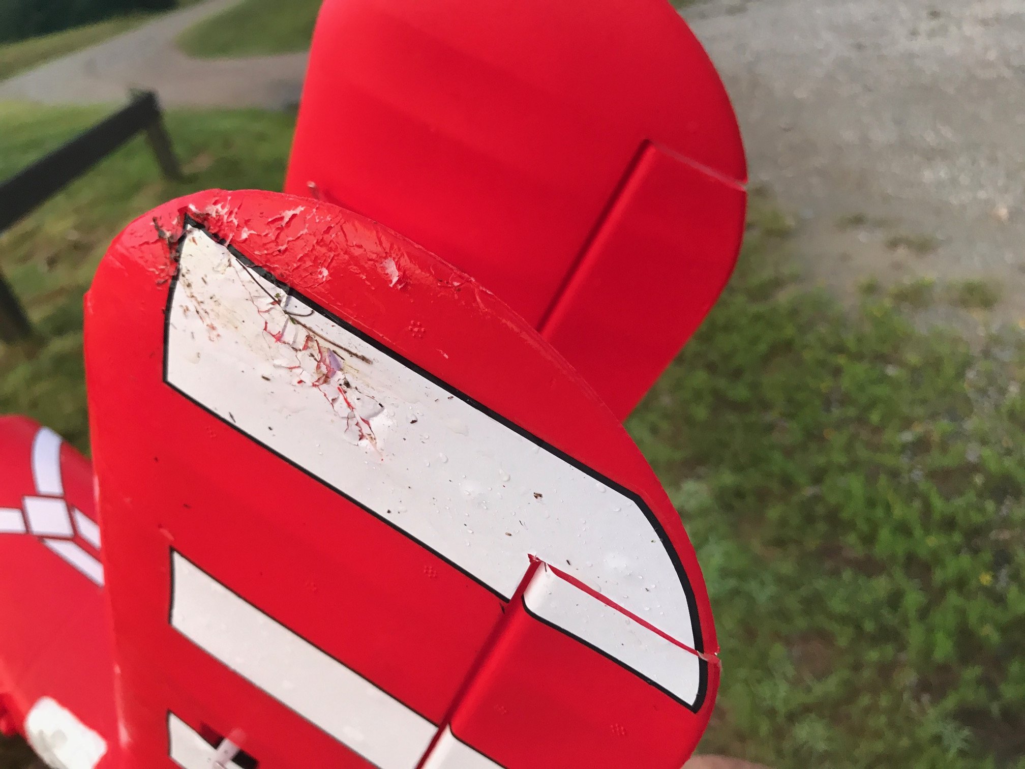

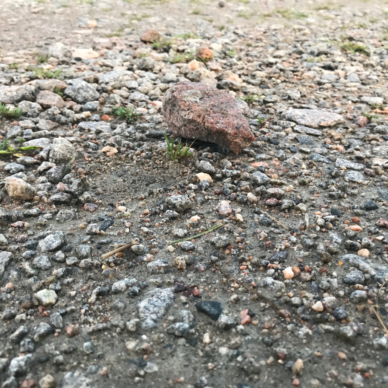

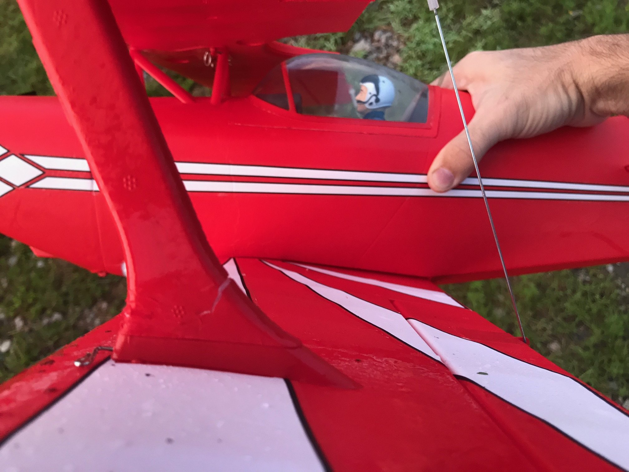

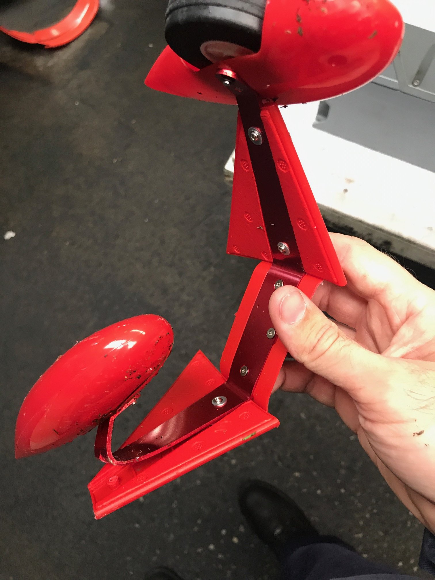

Now to the rough part. Bringing it in to land did a couple approaches to feel out the plane and it does need a little speed. Make a nice smooth touchdown but did not see the bigger rock in my path. Rock caught the right gear and basically caused the plane to do a high speed ground loop that when the gear leg bent and folded up the plane then cartwheeled causing the other damage. Will repair the gear at work today and so long as the prop adapter isn't bent then it will fly again soon. I'm thinking though the wheel pants may have to come off in favor of some slightly bigger wheels for when flying off of the grass runway at my club field.
