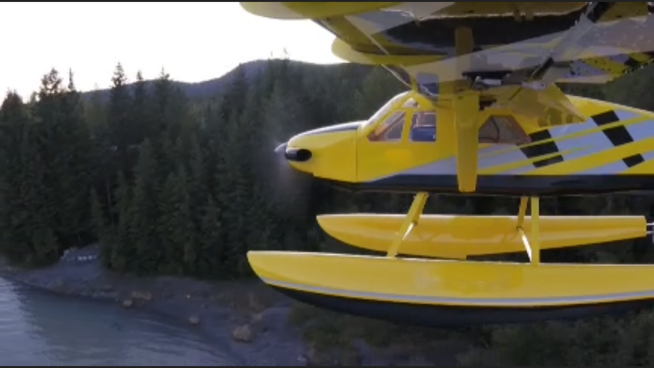

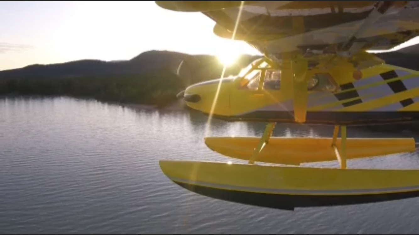

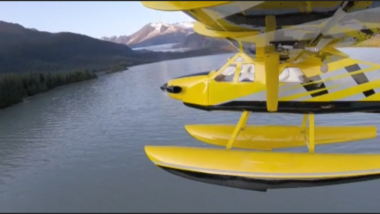

Burned through some batteries at the lake last night! Stuck a GoPro to the left wing and crossed my finger it wouldn’t fly off. Here’s a couple screen shots. Man it turned out not too bad!!!!
There was quite a bit of drag, maybe six clicks of right aileron. Slowing down for a landing it would dump the left wing every time.
