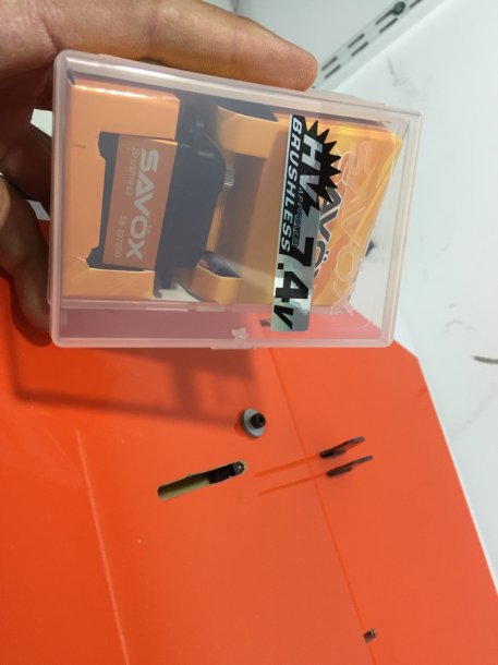

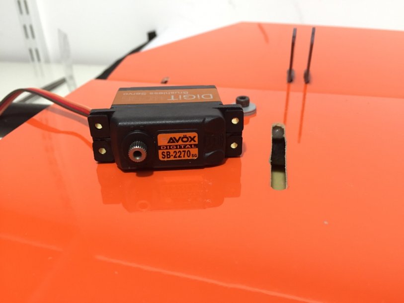

I've waited for a long time for the servos. Finally I've got them.
9 Savox 2270 brushless with 444 oz and 0.12 at 7.4V.
I'm going to use HV Fromeco regs and adjust them to 7.4V so the servos will get 7.4V constant.

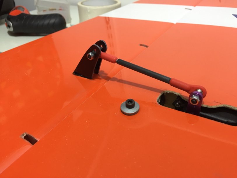

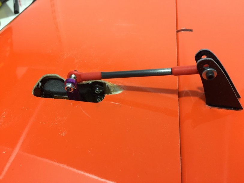

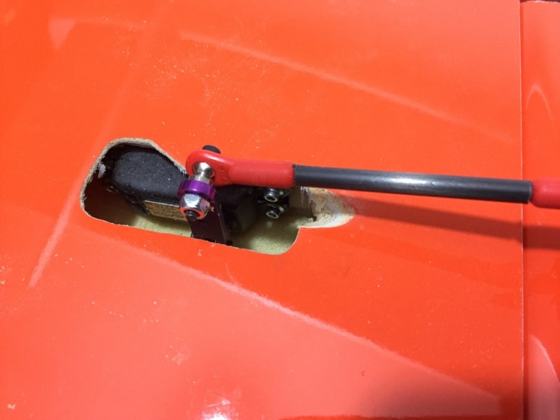

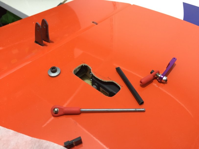

Today I worked on the Stabs and elevator after all this s is what the IMAC plane is all about, the throws on the elev so after some thoughts Ive decide to use the 1" route.
It will give the most linear fill and with the right geometry it will even make the force bigger due to the leverage.

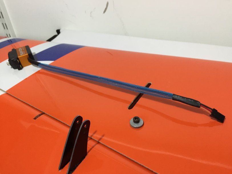

The slots I did will also be a way to cool the servos on very hot days.
I used a home made threaded rod with carbon as the pushrods and Dubro ball links.
Overhaul throw is 30 degrees up, 35 down.
I literally got the arm inside the skin to get enough throw yet still use 1" arm.
