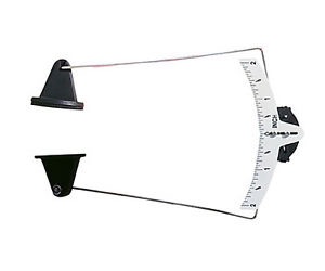

Nothing wrong with that approach to flying but do you check if the left and right ailerons and elevator halves are even matching?
pawnshopmike
Staff member
Ohio.AV8TOR said
pawnshopmike said
I just set all my throws to the max and let er rip!
Actually I do. I have a pair of Aeroworks meters that my Uncle Bill modded for me. He added bearings, flush fit the springs and made them into a right and left. They work awesome!
Ohio AV8TOR
Just Do It
Ah I see and Uncle Bill did you good.
Hoosier06 said
https://www.hobbyking.com/hobbyking/store/__39434__Control_Surface_Throw_Gauge_USA_warehouse_.html
http://www.donshobbyshop.com/product.aspx?cat=5
I bought two of the CRC throw gauges from Don's Hobbies years ago. I found this to be the best of them all. I see Hobby king has one similar to the CRC gauge
Have to admit...when I clicked on the first link, I noticed it was a hk link. I was expecting to see something really cheap and chinsy. Ha... Had I known these existed when I bought the Aero-Works, I could have saved myself 30.00 bucks. (Cost of meter and shipping)
Ah well....live and learn right? LOL

I've recently downloaded and been using the iPhone App Clinometer by plaincode. https://appsto.re/us/nV0dr.i Peter Breitling s the developer.
It is very accurate ( I've verified it) and can be quite convenient...definitely worth trying...but there is no replacement for the convenience of a simple throw meter!
