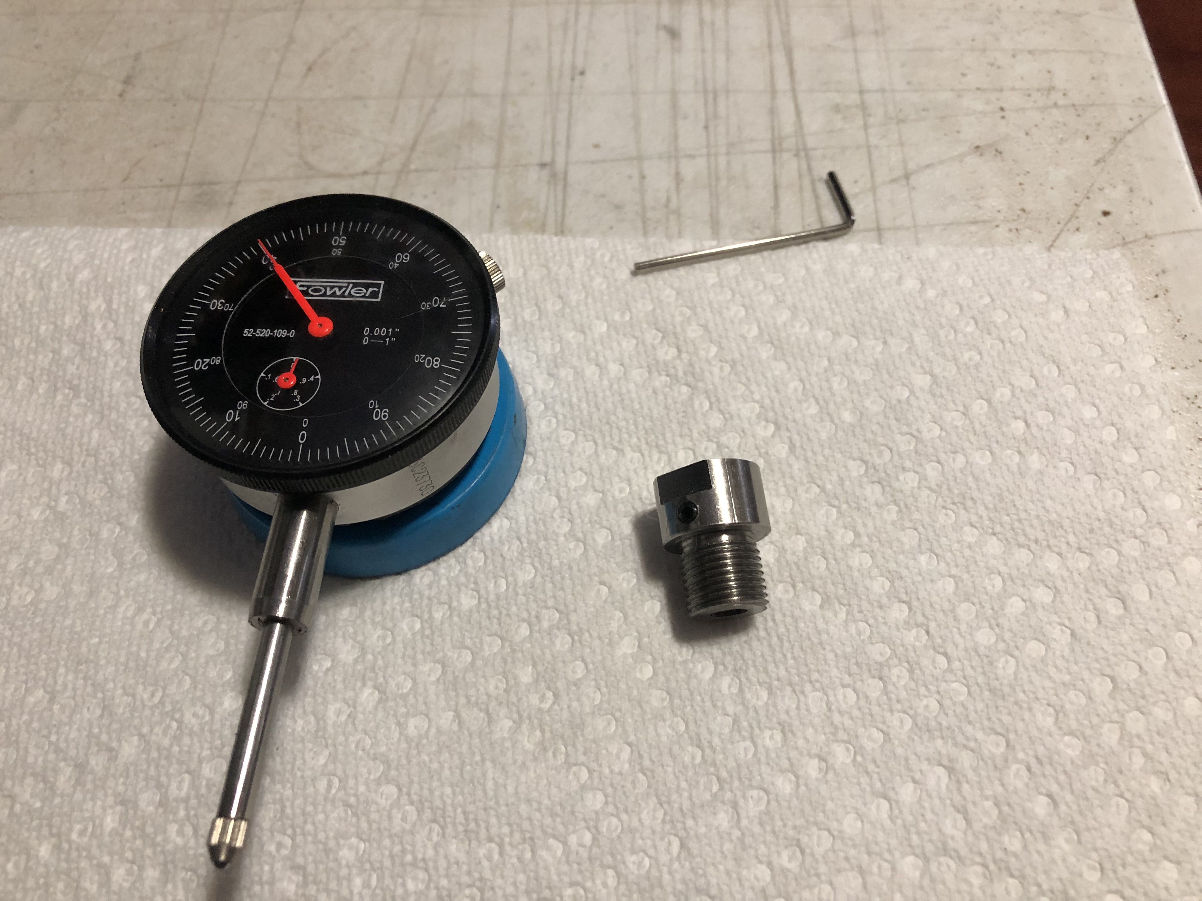

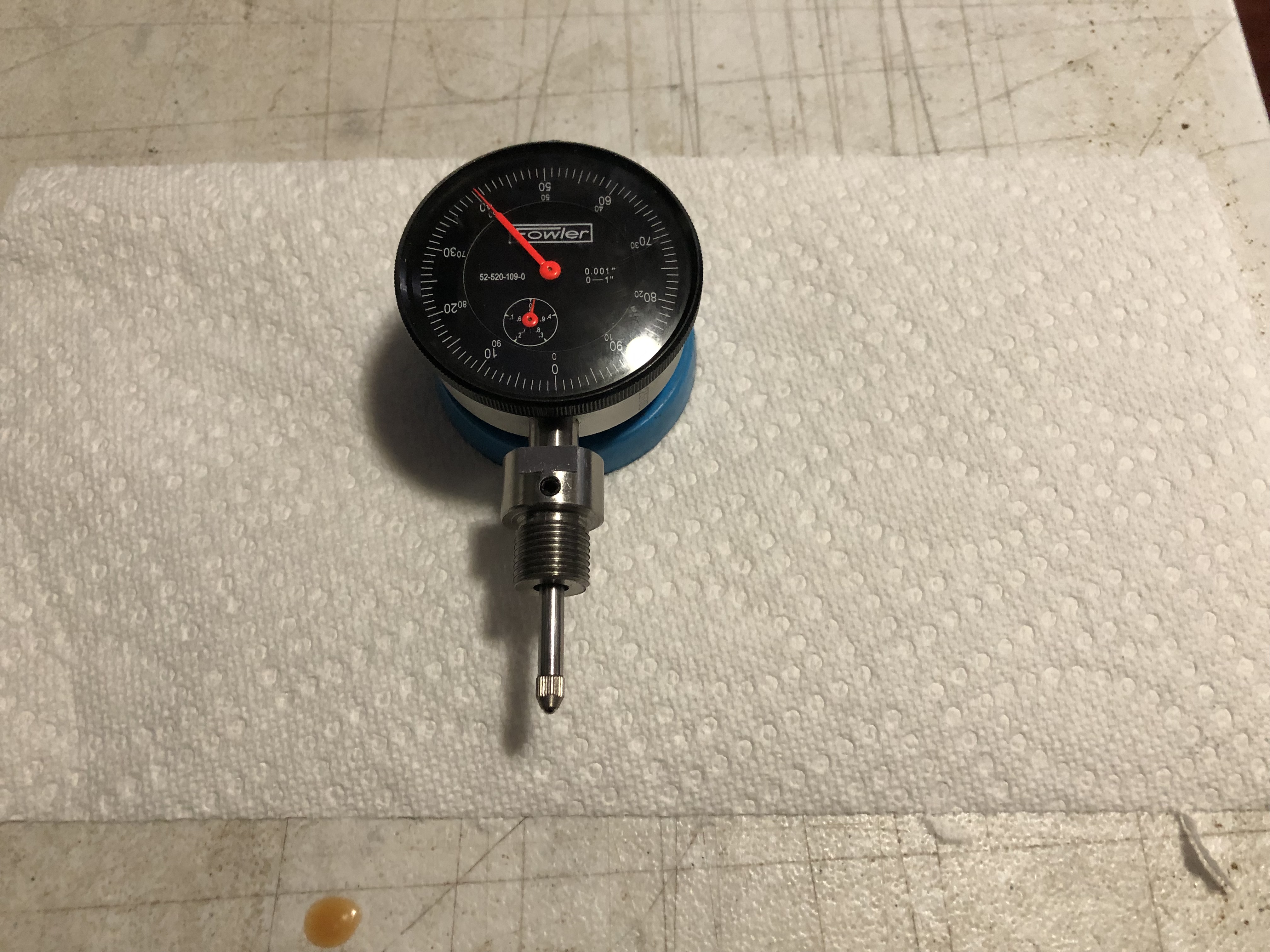

My kid is rebuilding his snow machine engine so I built him a squish adapter for his dial indicator for properly shimming the cylinders.
To measure the narrow squish band around the head?
Yep,
You set the cylinder head on a surface plate with the dial indicator installed and set it to zero. Then install the head onto the engine and bring the piston up to TDC and you have the gap. Shim the head to proper gap and your done.
TonyHallo
I was wondering how you would use the dial indicator, I see now. I've used to old fashion method, smashing solder with the piston and measuring the resulting thickness.
