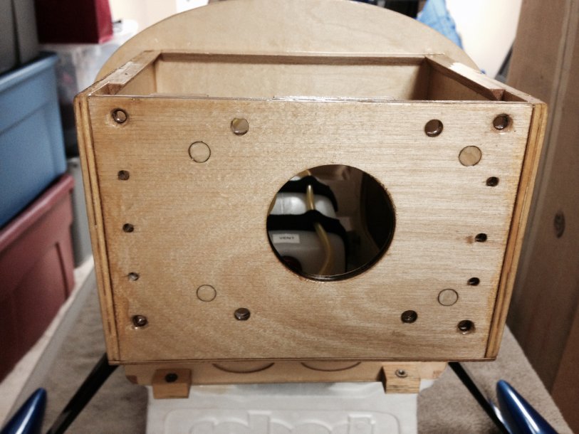

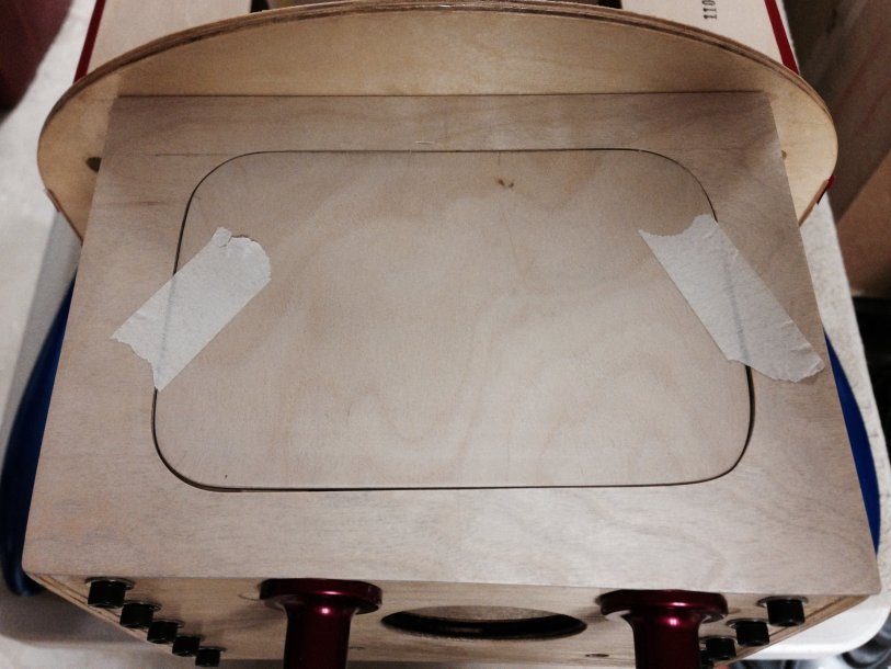

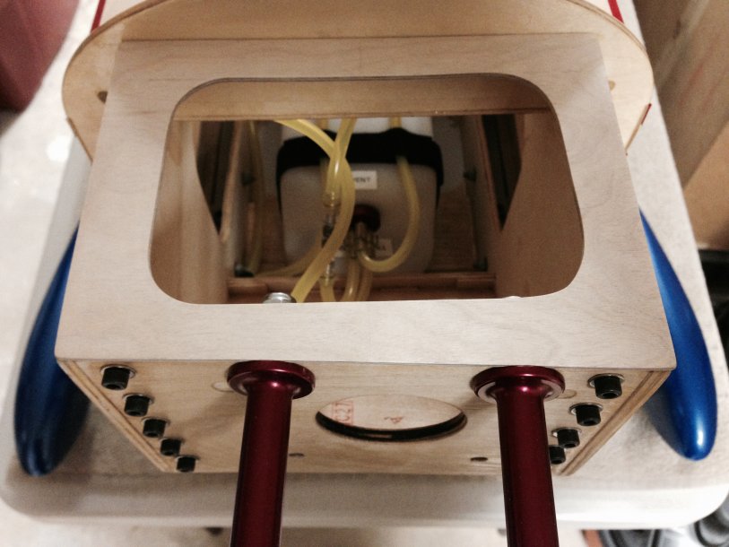

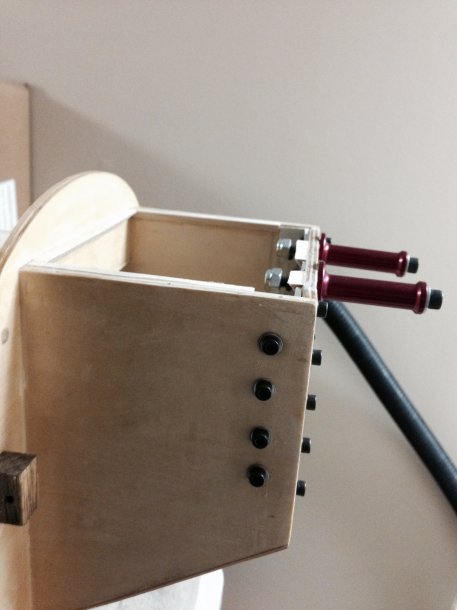

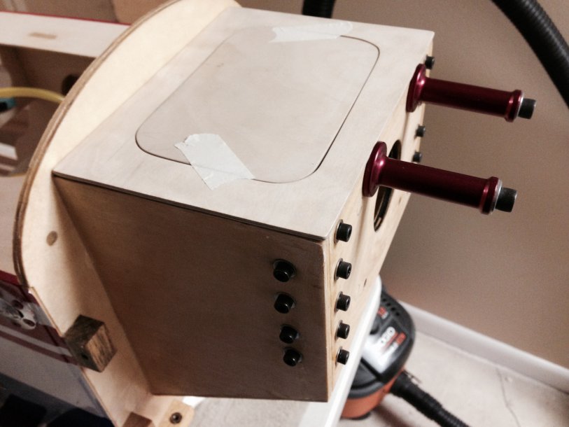

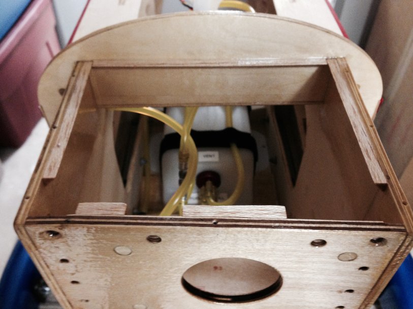

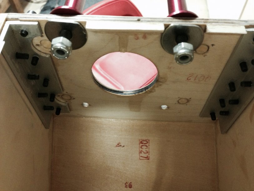

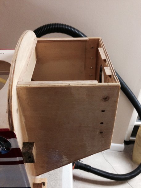

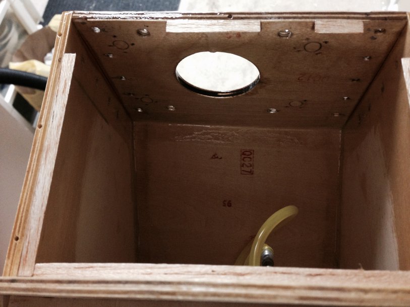

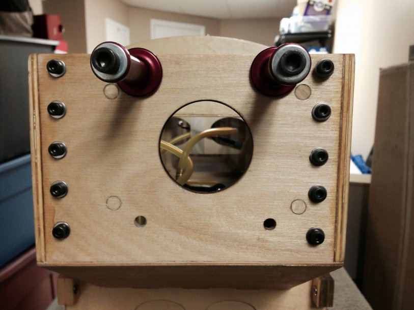

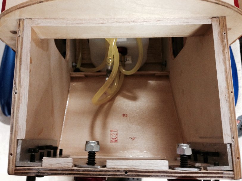

OK guys,
I got some time tonight to work on the motor box. I feel better about it, I tried to put to use a lot of your advice, I feel better about it lasting past the maiden . Hope you agree.
