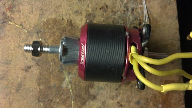

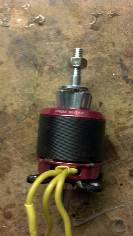

Running the Motrolfly DM-3615 (lightened version) in mine, with a Xoar 14x7.. Awesome power!
I've used 2200 and 2600 batteries and with the 2600 (300g) the CG is a bit on the nose heavy side of neutral with the bigger motor up front. The 3615 is actually only 15g or so heavier than the 2820 once you add the cross mount and prop driver (the 2820 is 170g, the 3615 is 195g)
