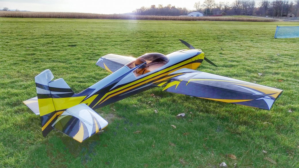

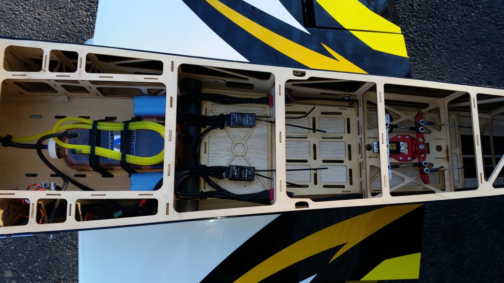

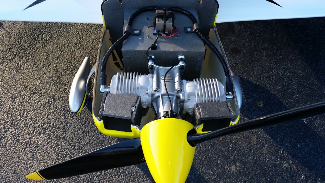

Thanks Guy's I ended up using 2-fromco 5200 li-iron the wolverine sw,ibec,7-savox 1270's 1 savox 1267 2-7008 futaba receivers. Plane flys great. The GP123 w/smooth pipes comes in at 93db at 25" away 2' off the ground in line with the prop
View attachment 3447View attachment 3446View attachment 3445
Looks great! What prop did you get those numbers with? My piped 123 gets stupid loud on the 29-9 Wide Falcon, but OMG it is strong!
Twister
That was with a beila 29x10 carbon but it rips like crazy in the air. I have a few props I will be testing as soon as the weather co-operates. stay tuned
For what ever reason I do not know. However after trying Beila, Mejzlik and a few others, I have found Falcon to be about the quietest props available. Not to say they won't rip. Any prop will indeed rip when the tips go supersonic.
