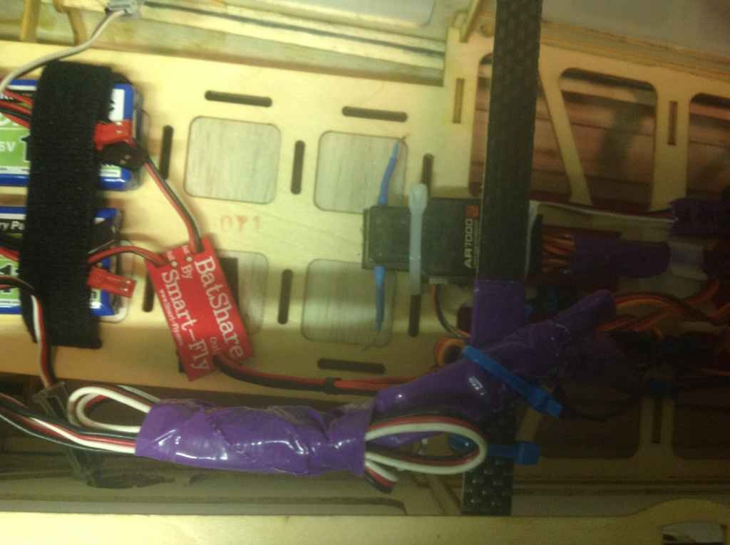

The only thing that might cause some interference is the close proximity of the BattShare to the Rx antennas. You might try and move the Rx back a couple of inches. Can't see where your satellite for the Rx is but you want the satellite antenna 90 degrees in relation to the main antenna.
One thing I noticed was the AR7000 DSM2. I fly spektrum, so I'm not radio bashing or intending to start any wars. But consider upgrading that receiver to DSMX if you have a DSMX radio. The DSM2 can lock out in very rare circumstances, and I've not had my old ones do that, but on this plane (of which I own too) I'd do the X for peace of mind. Just because I tend to fly this model in big spaces. I have DSM2 on smaller planes like the 51 slick, buck huck, & foamies. Never had a lockout.

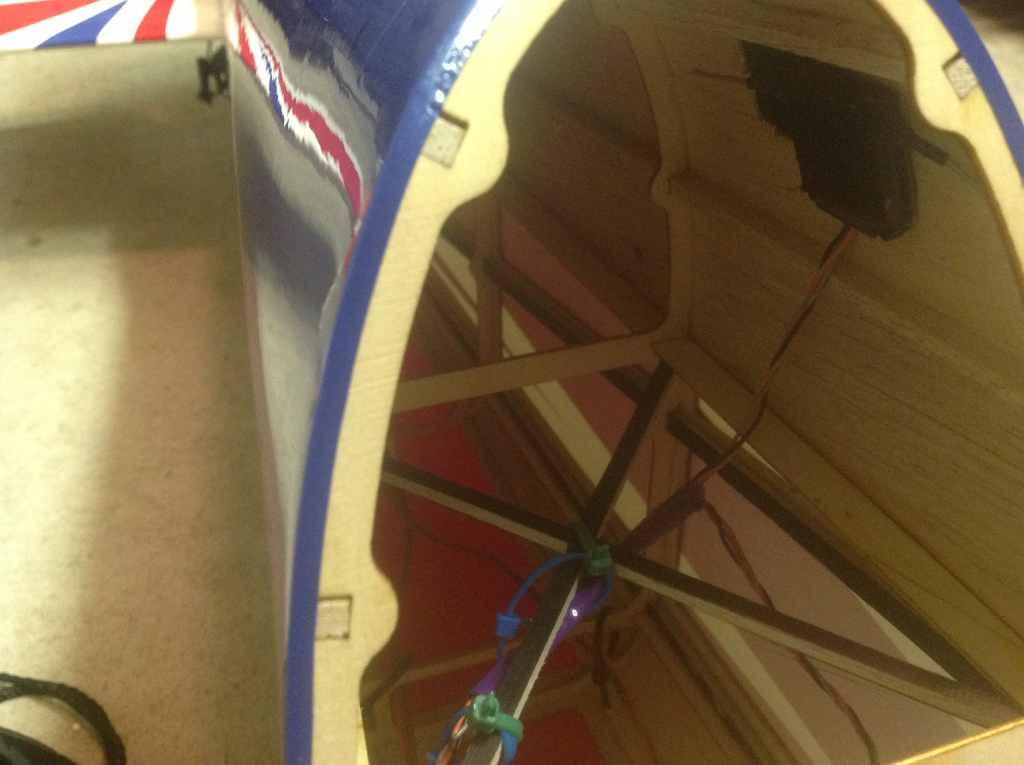

I don't think they were really connection issues cuz I was standing next to my plane and got hardly any engine response, but my throttle servo was still moving. So i think the throttle butterfly is loose.
And here's some pix, I moved my batshare just in case that was interfering. ImageUploadedByTapatalk1349469280.212534.jpgImageUploadedByTapatalk1349469286.825658.jpg
Wow, that's crazy that it was a mechanical issue after everyone kept thinking that it might be an electrical issue. I'm interested to hear what you find when it's all fixed.
RC Girl
Nope, I lied. The butterfly's nice and tight. Ugh! I took the engine off for nothing..well I guess now I know that's not the problem.
