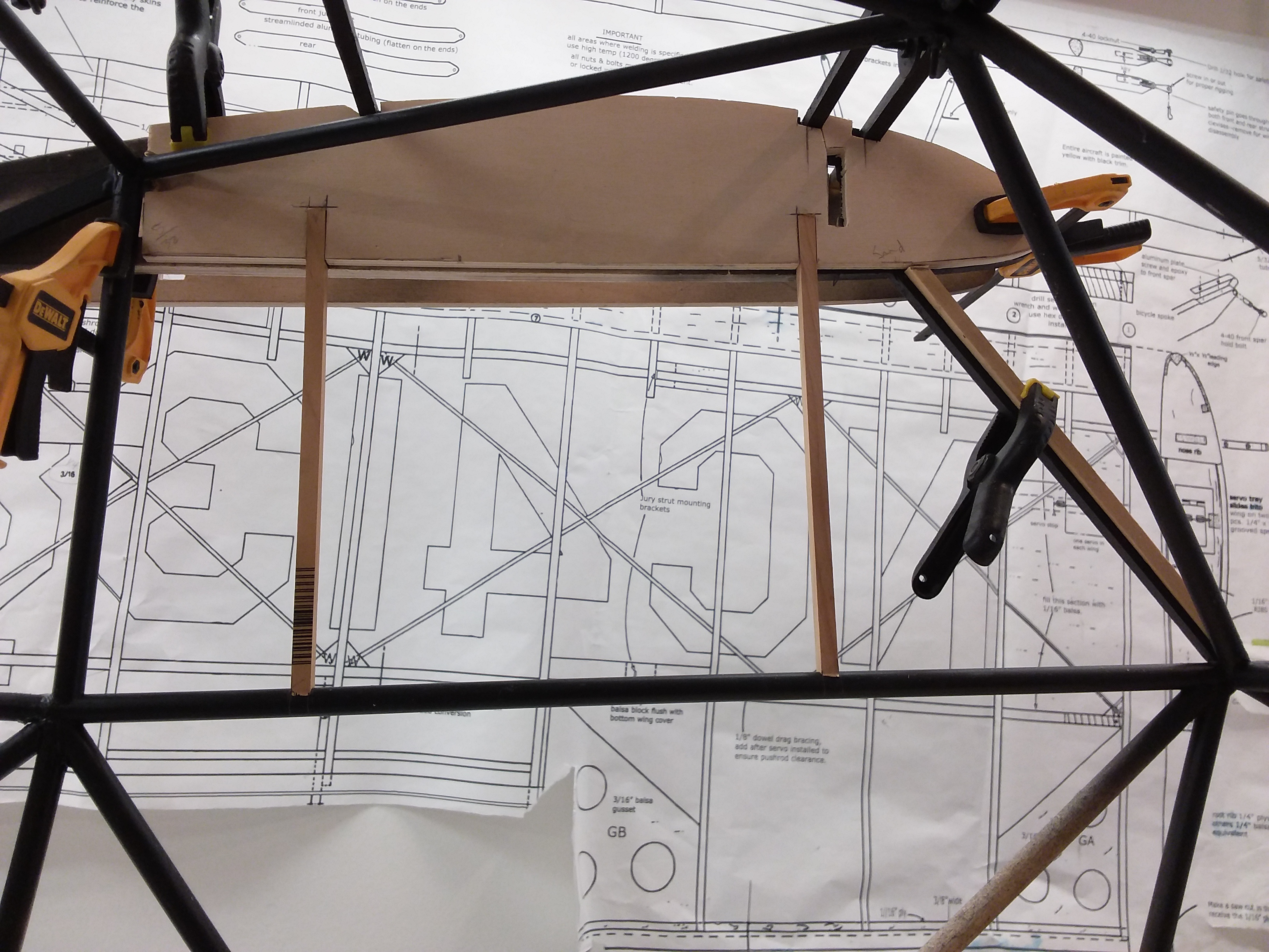

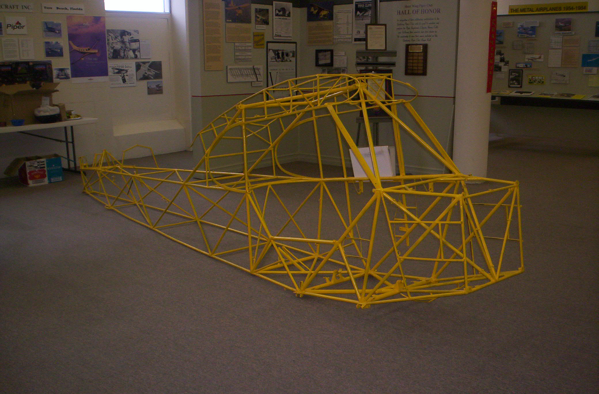

The inner root rib has to go outside of the cabin therefore I need a filler rib piece for the windows. Which I've done but the main upper support is a major problem.
AKNick

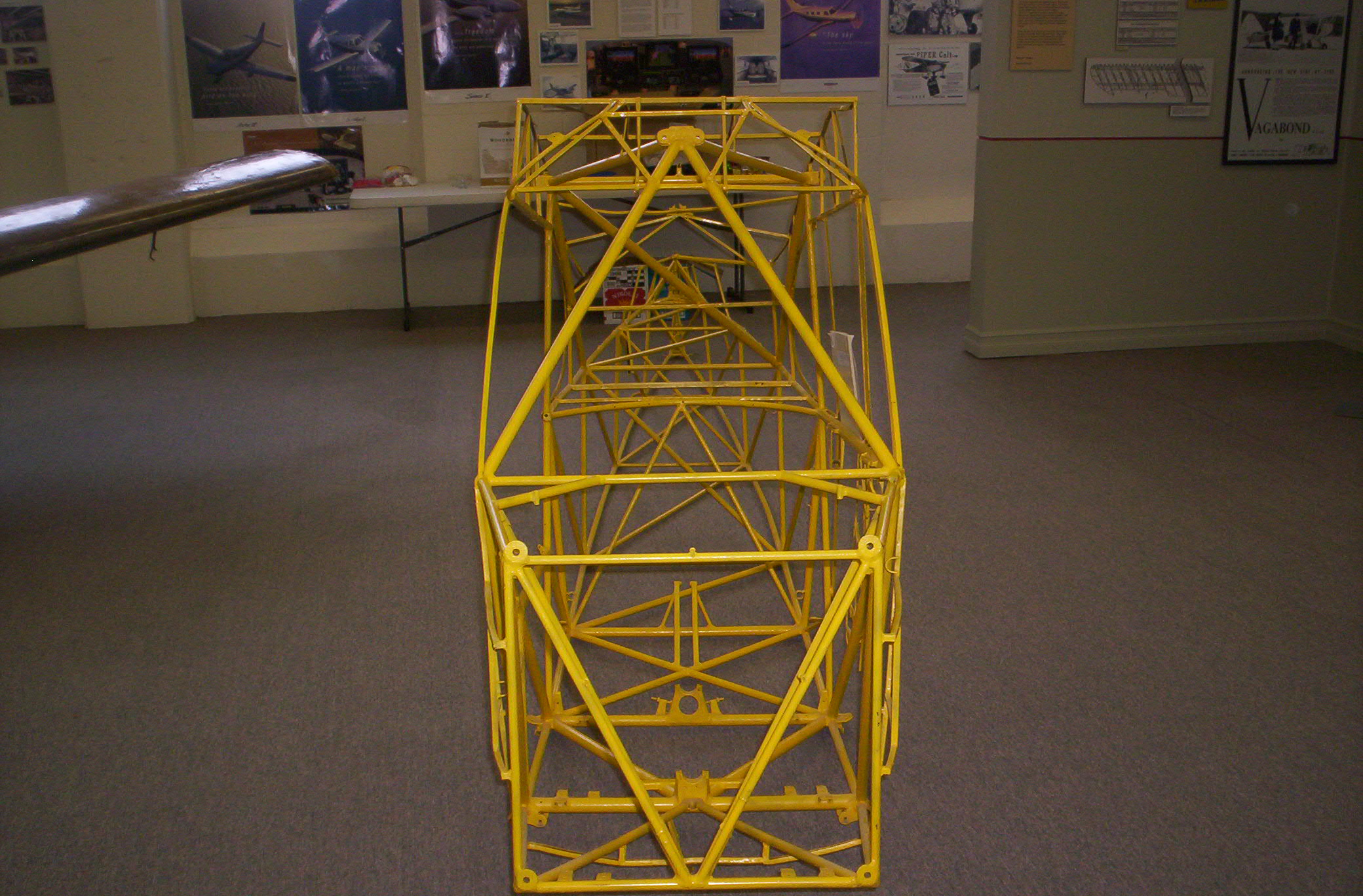

So the painted window post is not inline with the cabin side window posts? I'm trying to remember if there are some exterior longerons on the cabin side that would spread the cabin outward a bit or not. This would have allowed full scale access to the stab trim I think... but maybe that a PA-18
TonyHallo
Don't know if these will help?
Time to look at the longerons and see how they play into outside finish at the window area. A small puzzle in a big puzzle. Just a piece at a time.
Working on cabin posts today.

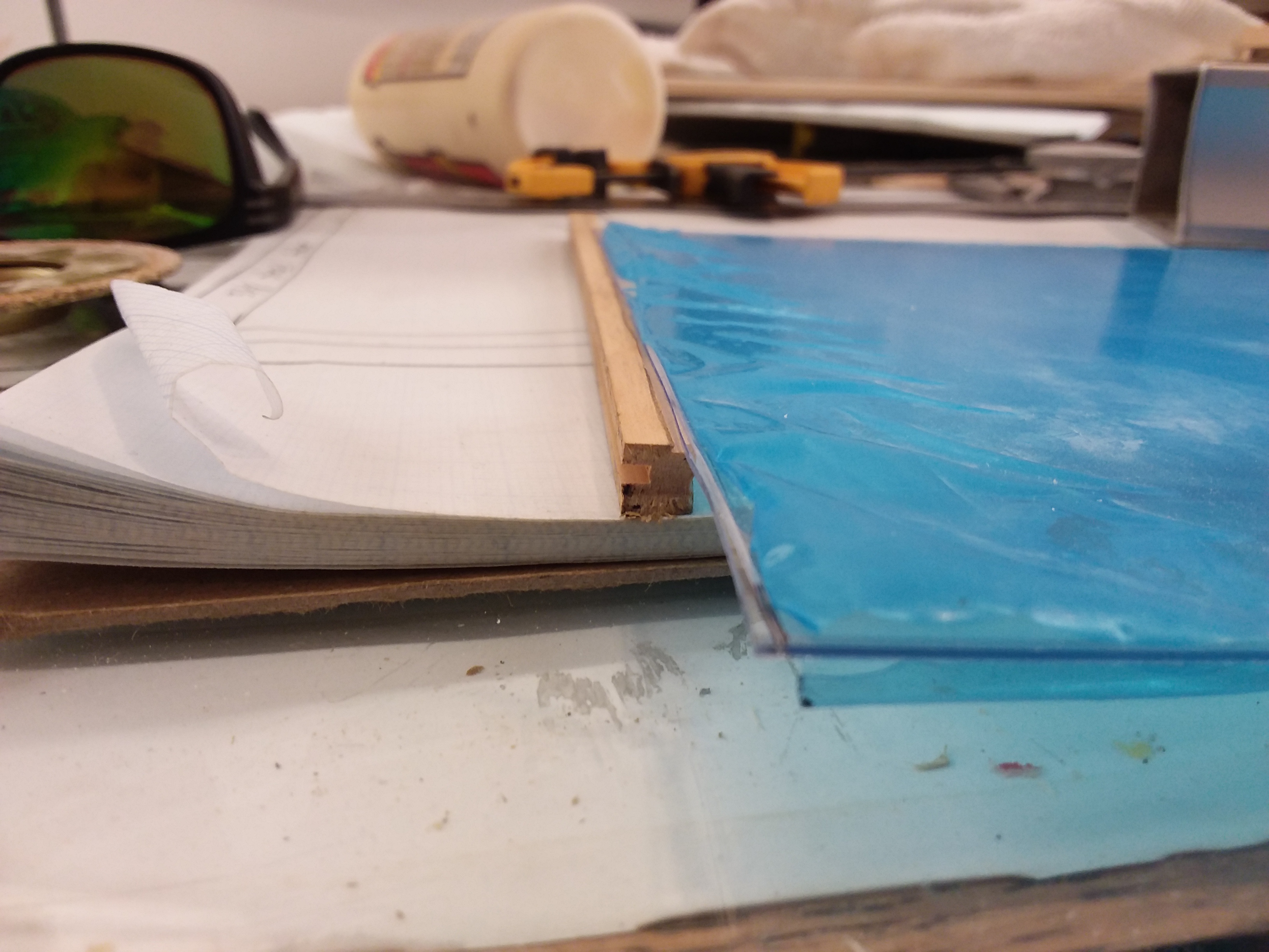

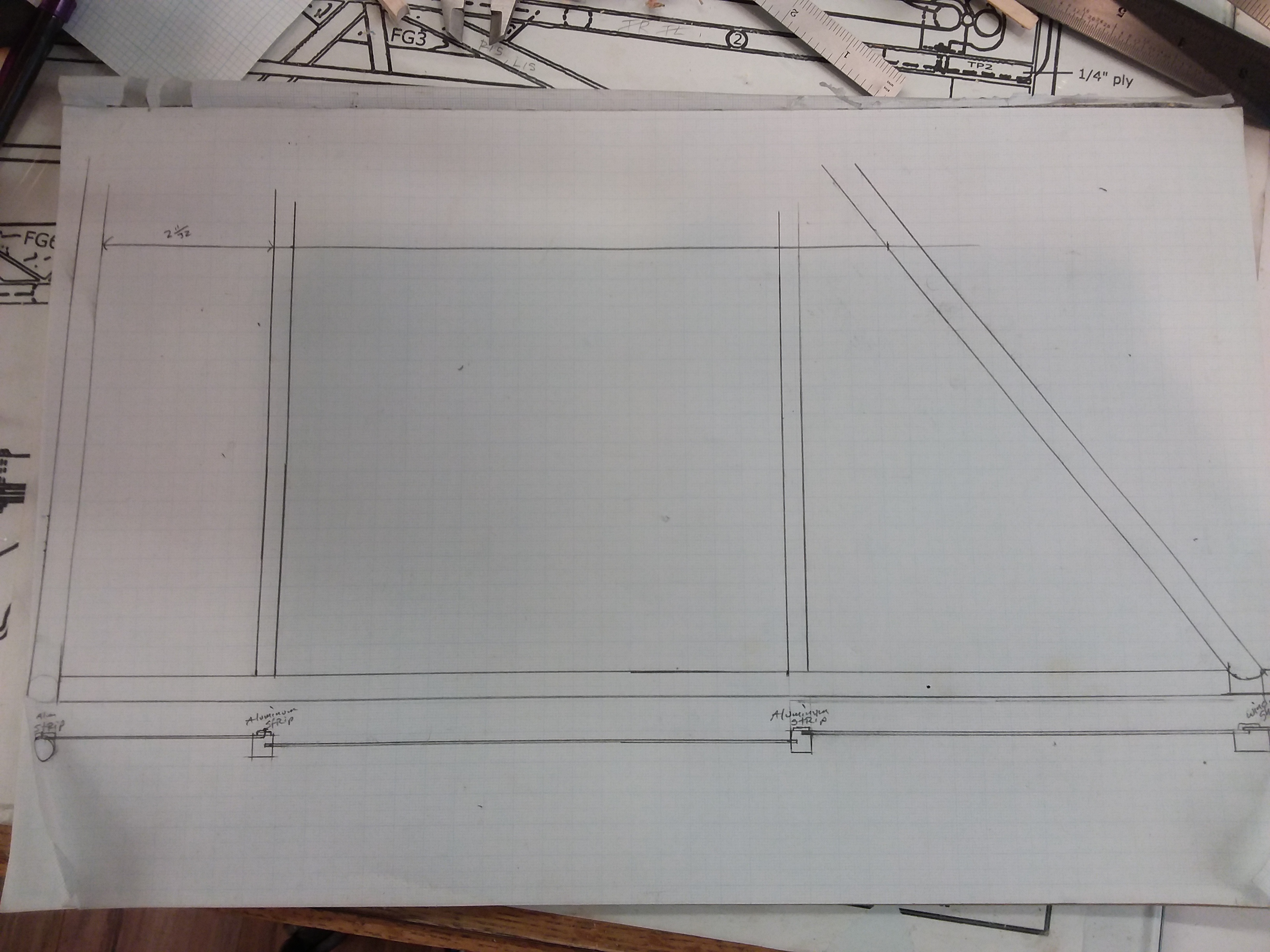

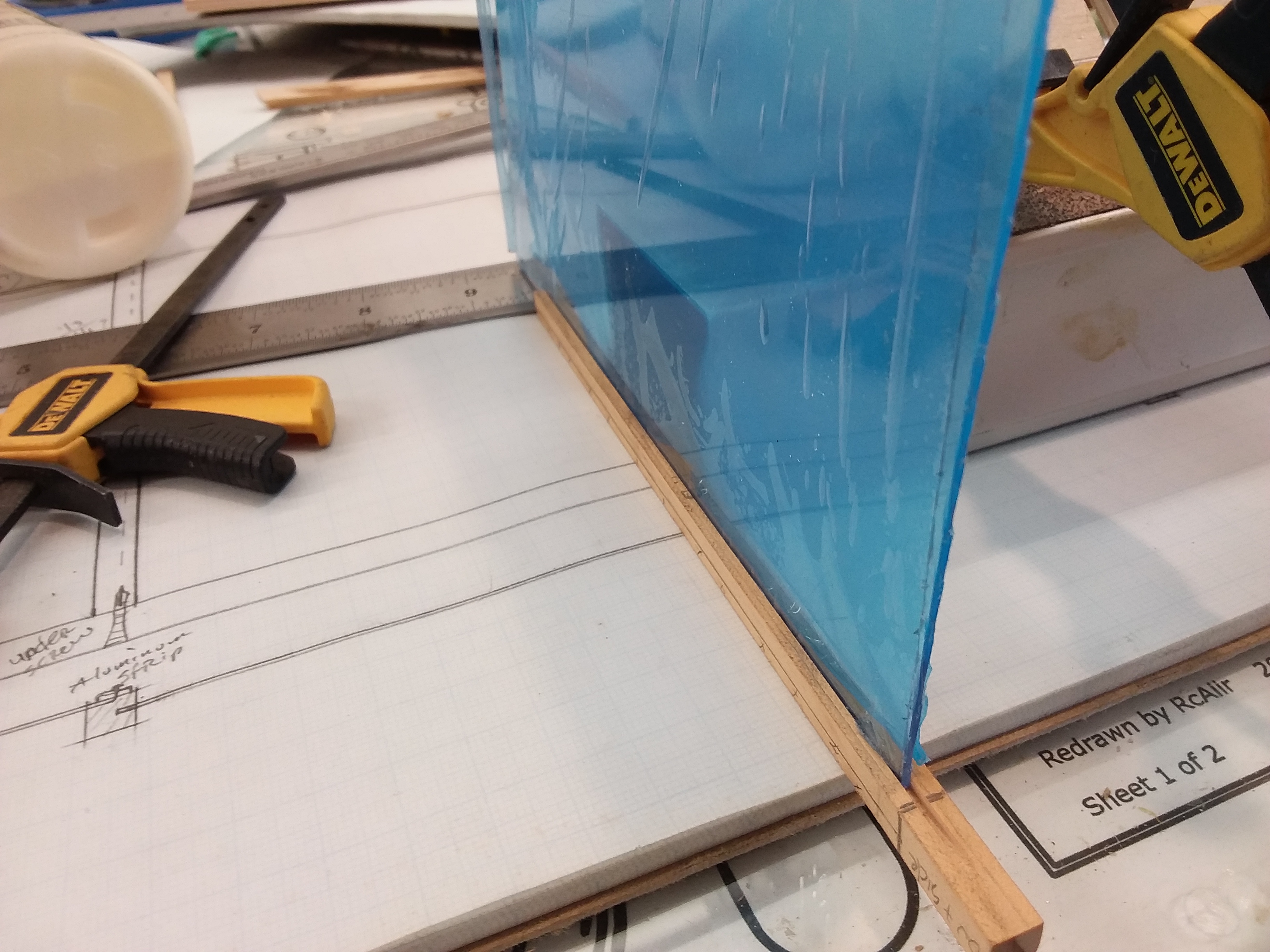

With questions about the 3 window pieces I decided to draw up actual size and resolve the issues on paper.
Does the center window slide up? I can't find anything online. I could make it a sliding window relatively easy.
