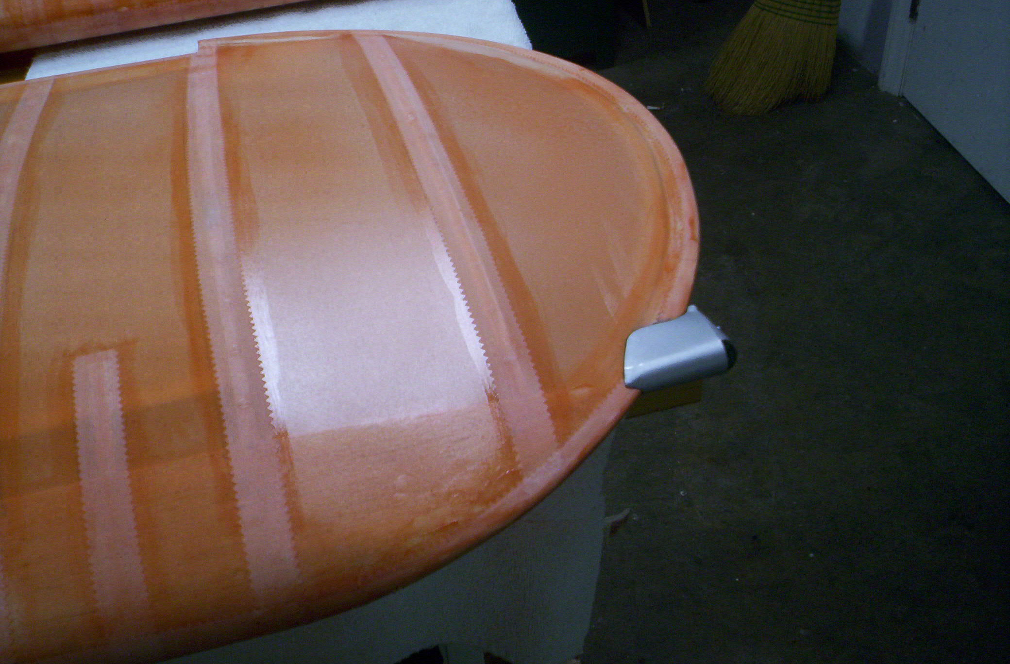

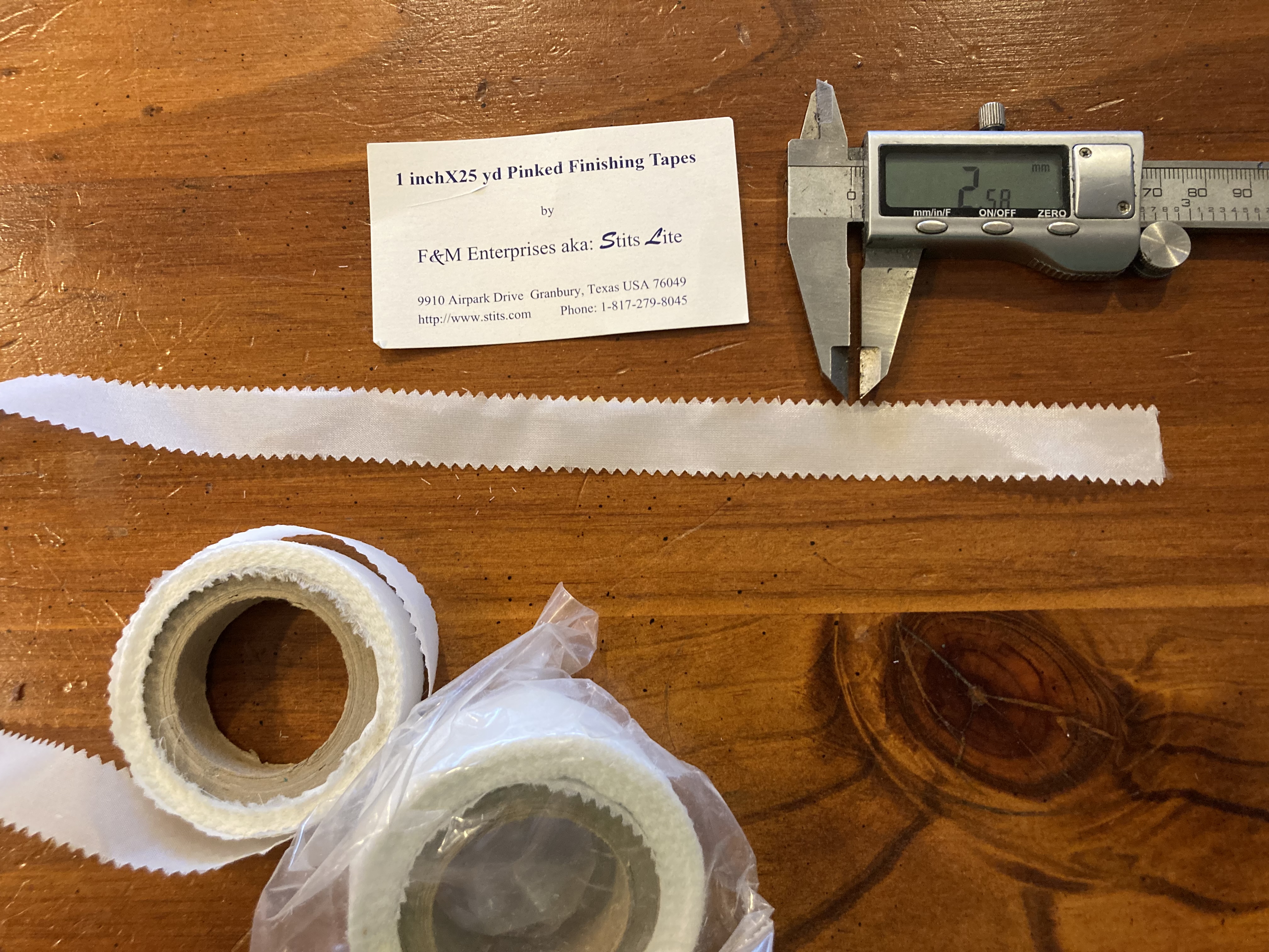

The pinking tape sold by F&M is just about 3 mm, would be great for making odd sized patches and such. Just wondering why you are cutting the tape rather than buying from F&M? Each rib takes about 4' of tape, that is a lot of cutting.
F&M?
Just starting research. Adding your suggestion to the list. I'll find the 3mm shear link and post it here.

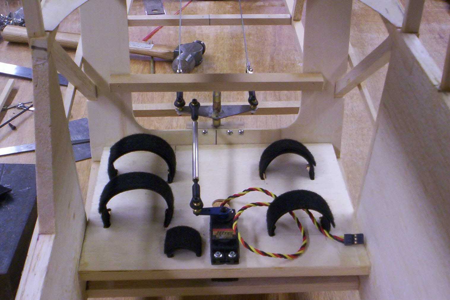

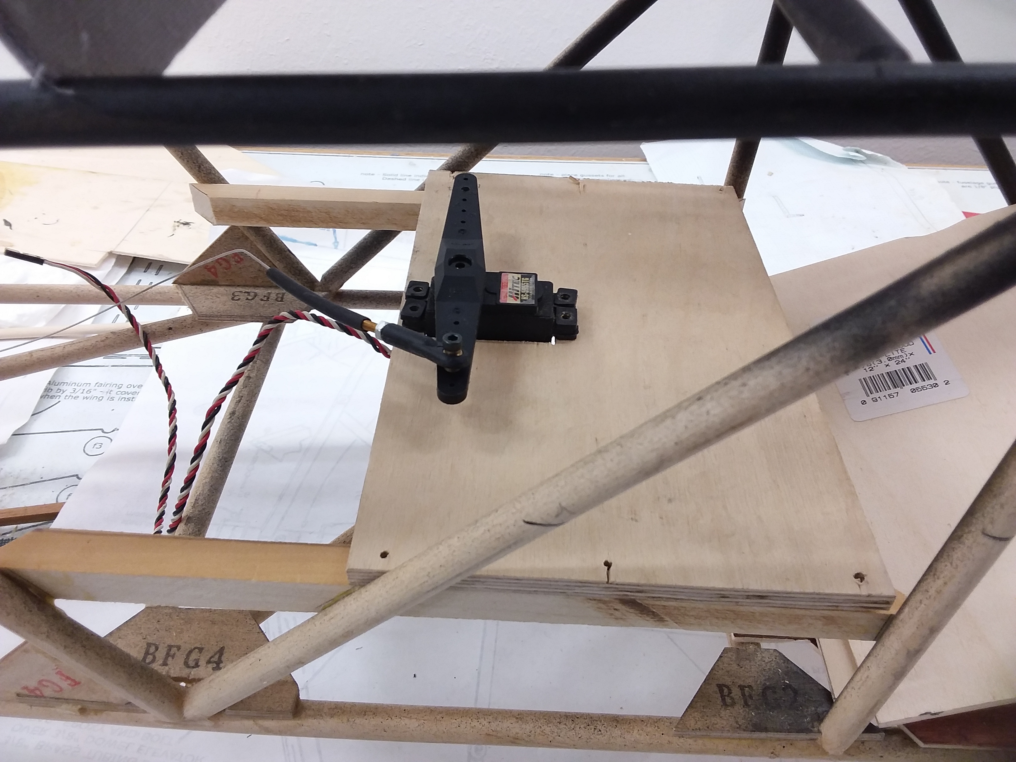

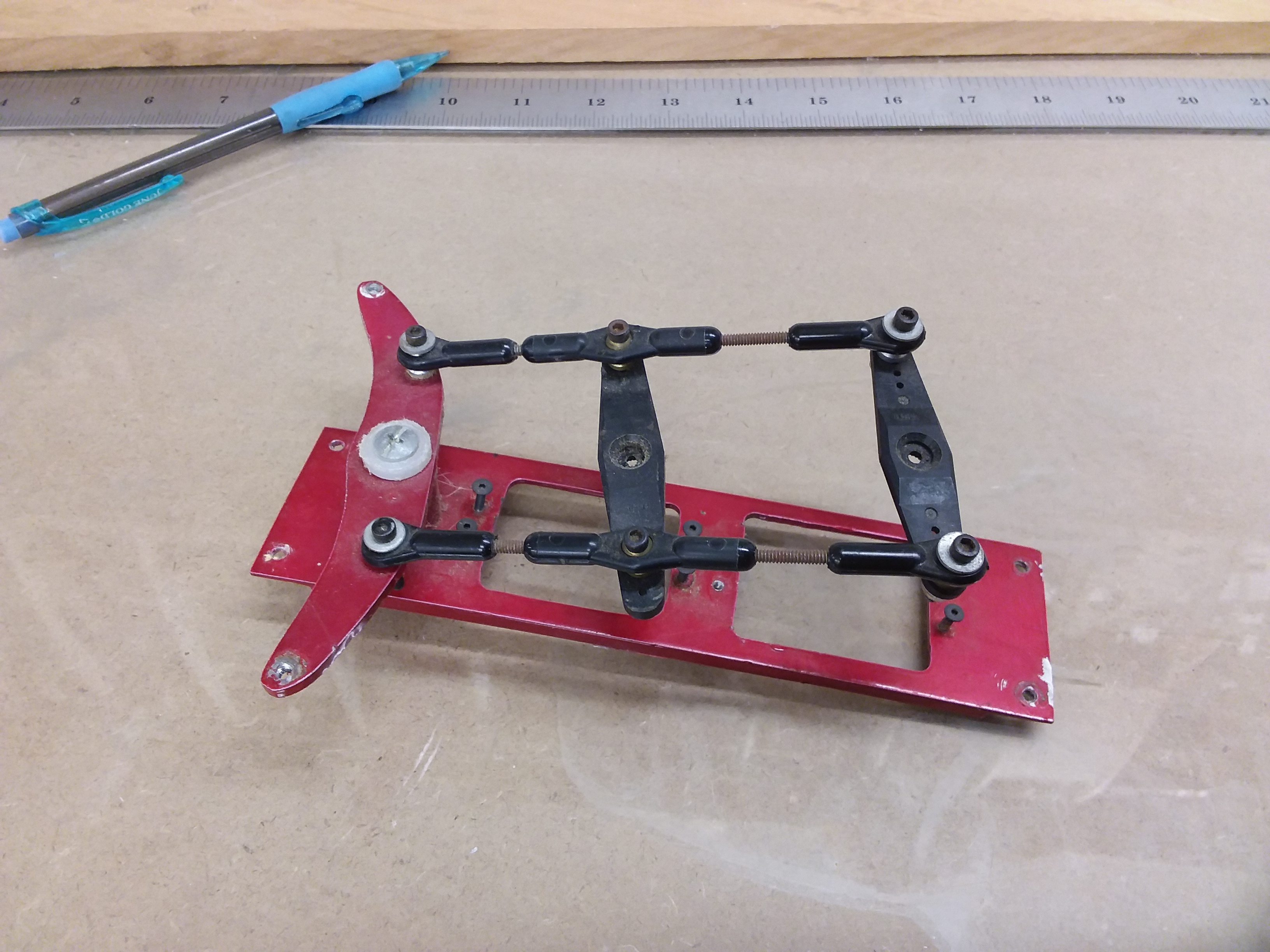

Making a rudder servo (batteries, elevator servo?) station tonight.
I might make this accessible from the back seat or underneath.

F&M Enterprises
I found the 3 mm shears on Amazon and have them on order. I looked for quite a while for shears with smaller pinks but never could find anything. I even spoke with Chip Mull at the Toledo show, he said that had a pair that he had bought at an event in Las Vegas but could never find them again to sale. I'm kind of excited about these and will make the recovering of the Champ better. These reinforcement patches will now have pinked edges
So is this tape sold by F&M already pinked/sheared?

Yes it does. The card is old, I believe they are located in California? I thought most were leaving CA and going to TX and Fl?
For 33% I use 3/4" for the ribs, 1" for longeron reinforcement and edges, and 2" for wing leading edges. You buy the tapes the same place you can get the fabric and covering liquids. They recently began offering the 2" tape for models, the photo below I used 1" tape for the leading edge.
