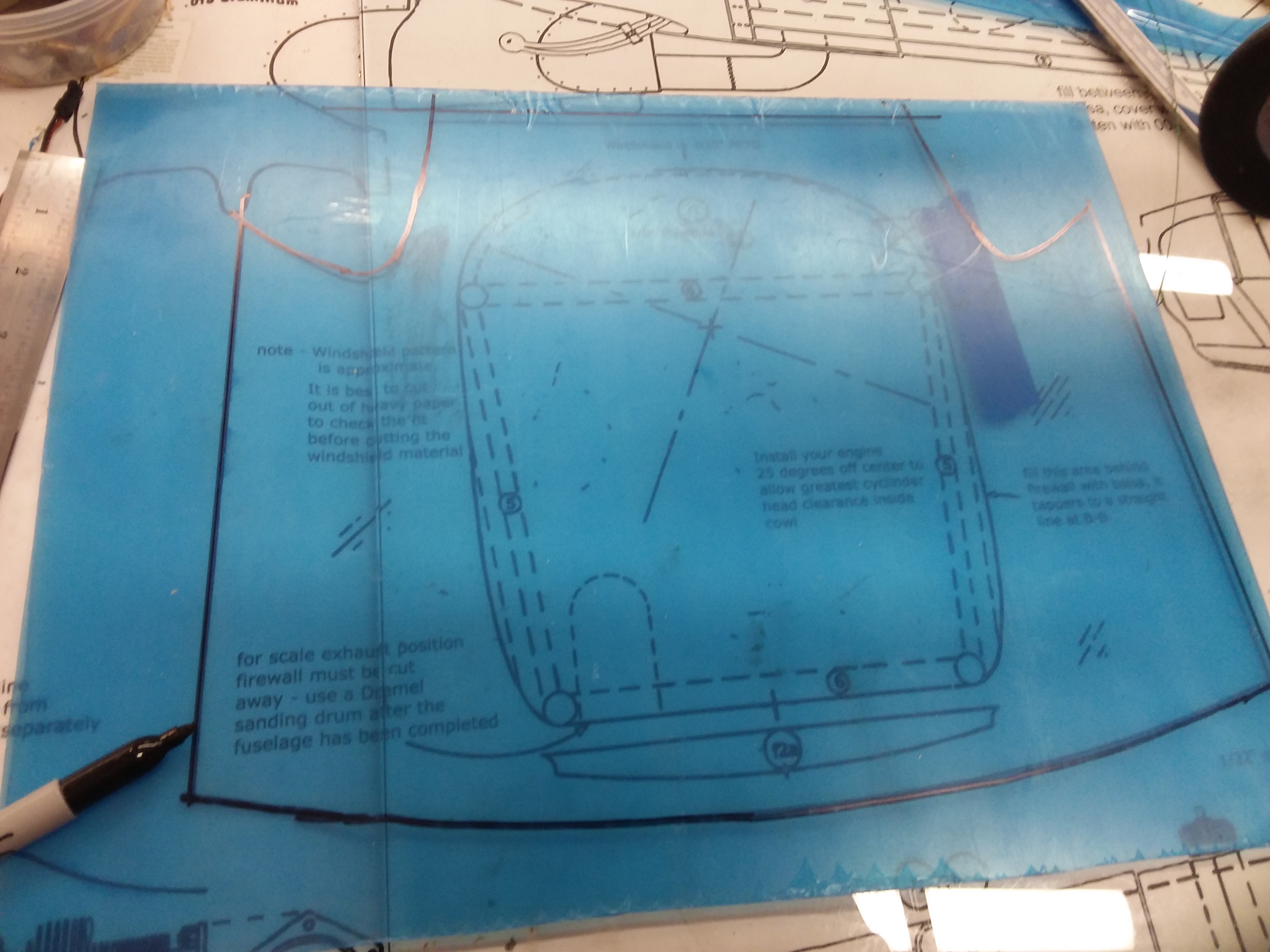

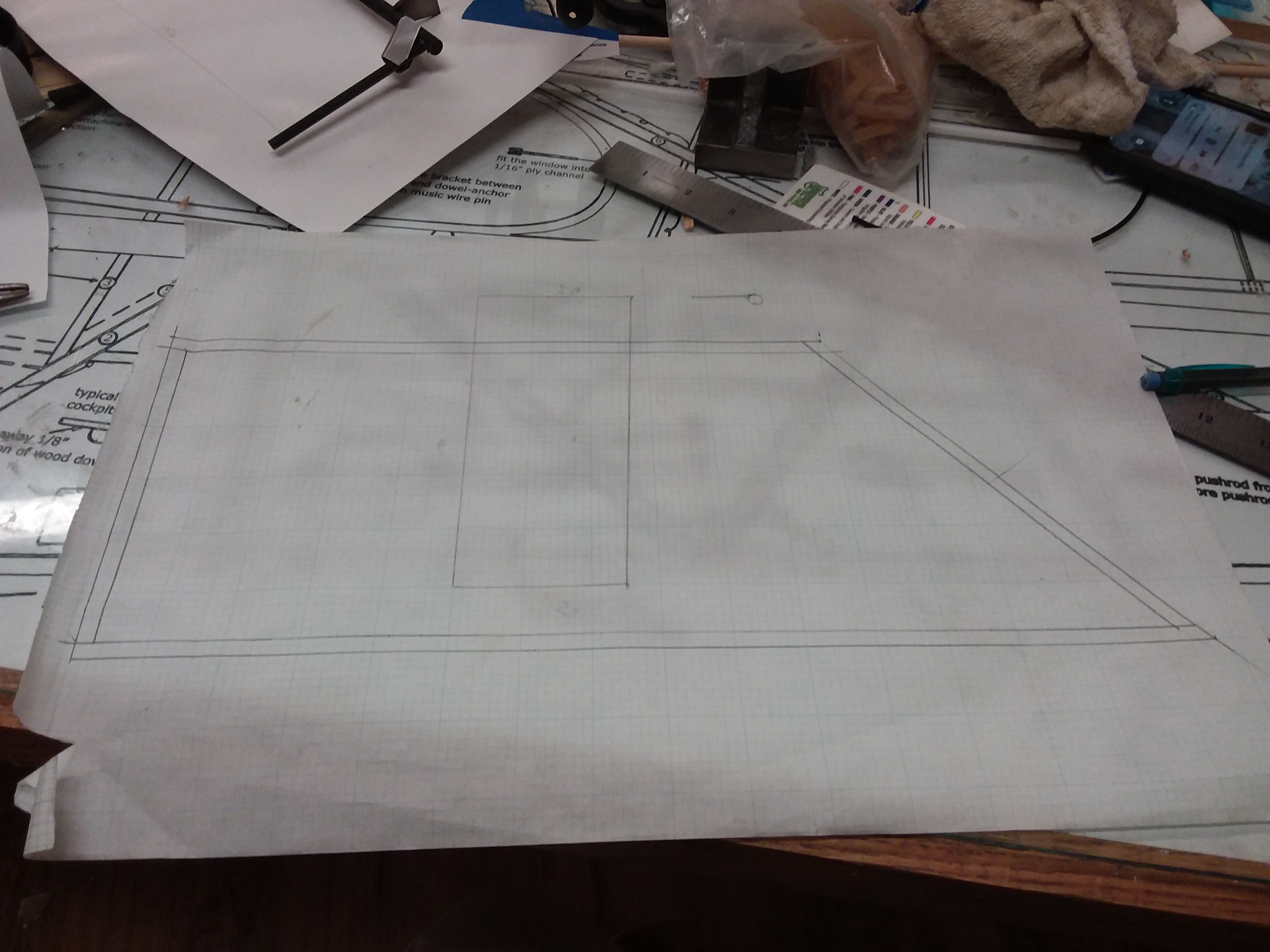

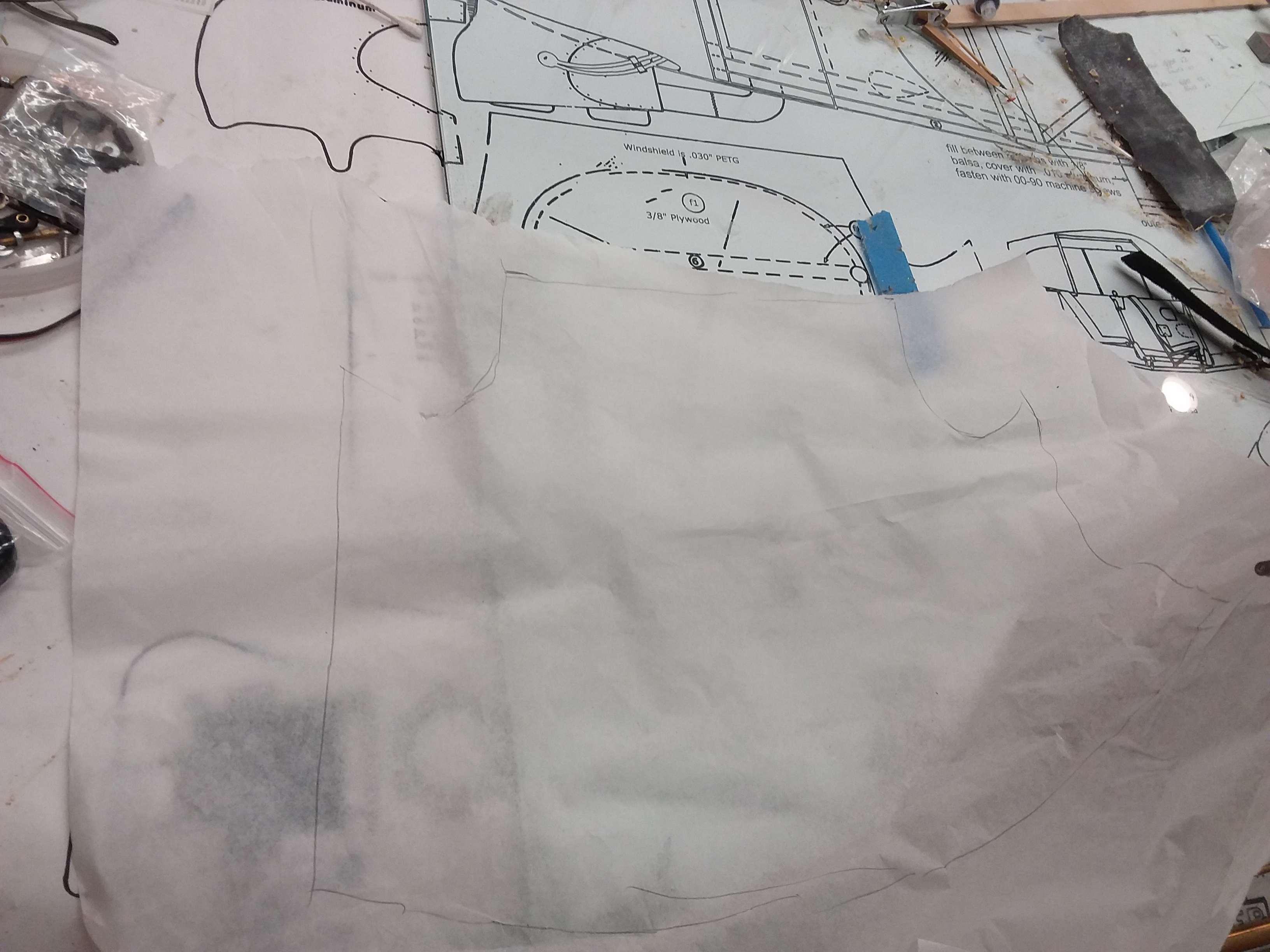

Looking around for poster board after tracing the front windshield on paper. Probably will find some on Amazon...........
TonyHallo
Seems like an unnecessary step, the poster board will not bend like the PETG will so what you think looks good may not when transferred to the PETG. I would transfer the pattern provided to the plastic and trim it to fit on your model. Plastic is like money, you can buy more tomorrow if you mess up!
