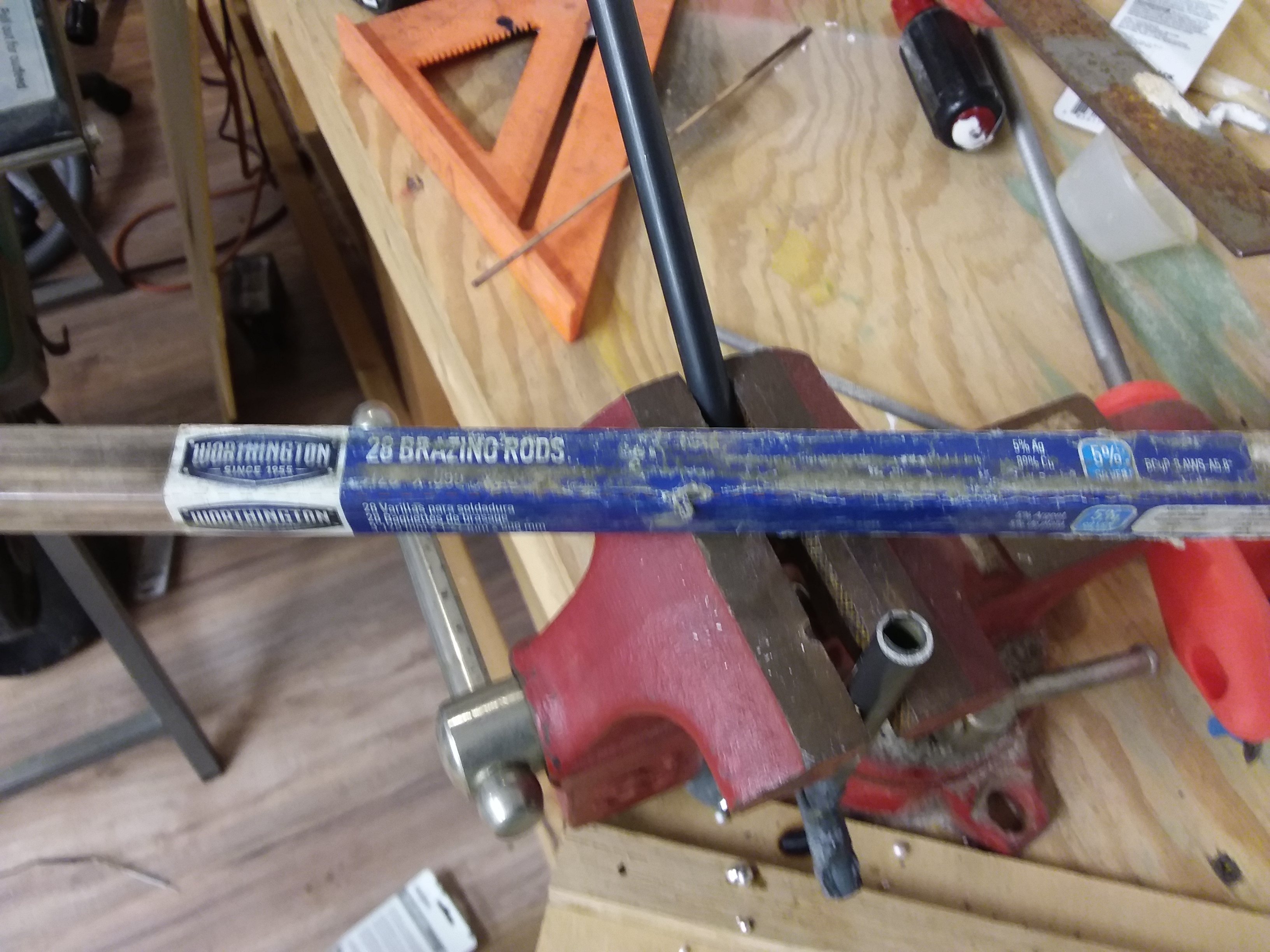

I think I’d make up a couple test pieces and try it both ways. Then take a hammer to them and see which one is strongest.
Oh and you’ll need high content silver solder like the Harris 56%.

What silver solder please? My plumbing silver solder doesn't work. I see 5% silver on the box. I have silver soldered 10's of 1000s of copper joints with this style solder.
