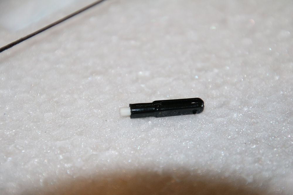

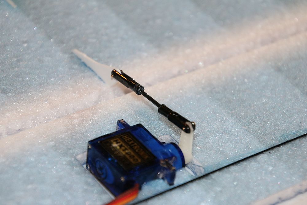

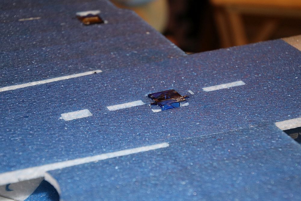

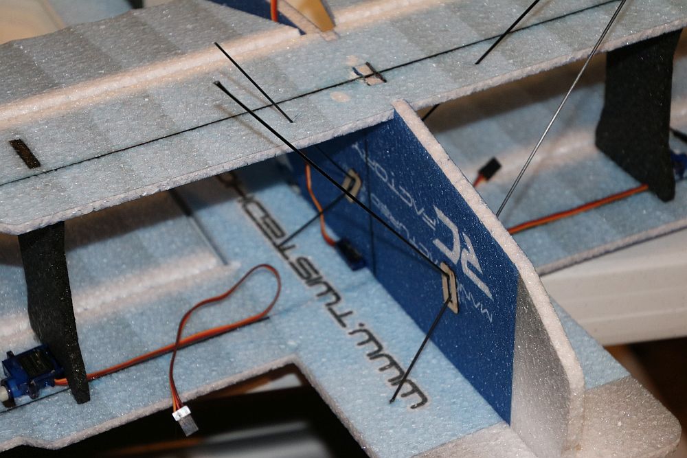

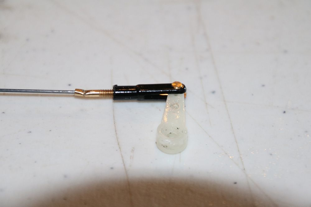

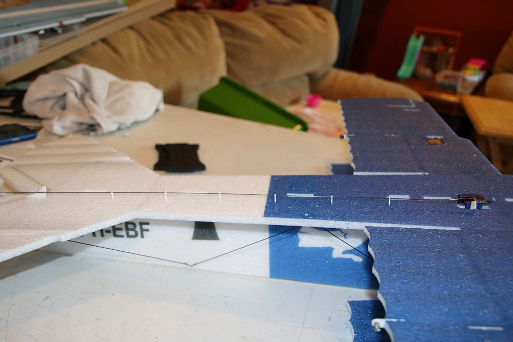

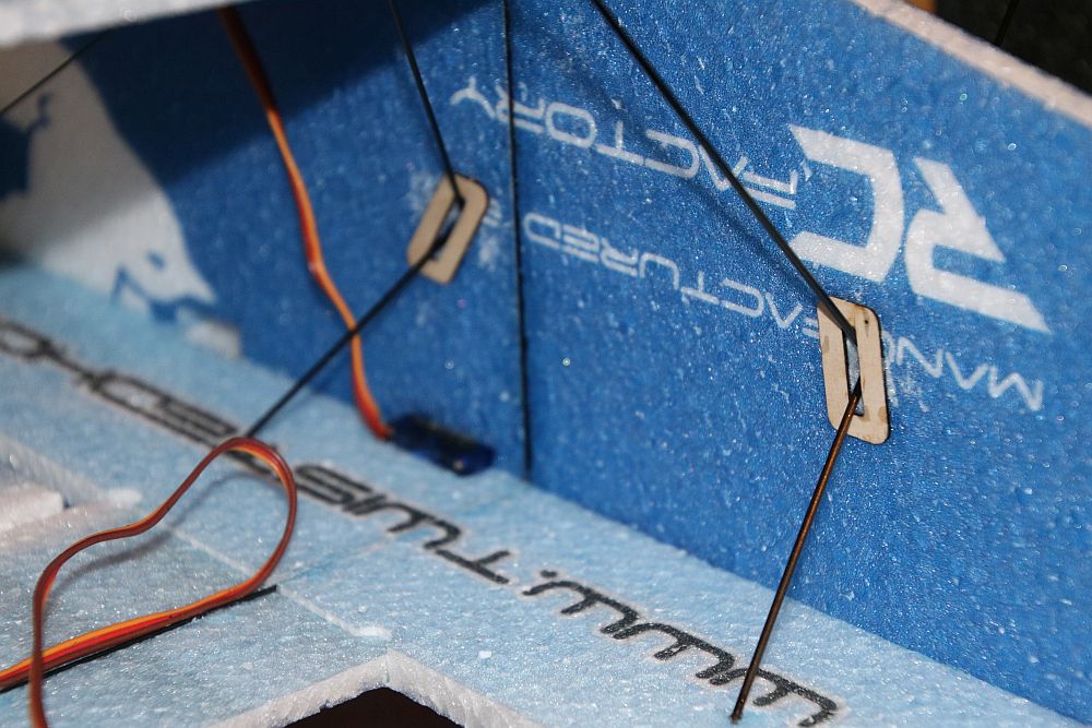

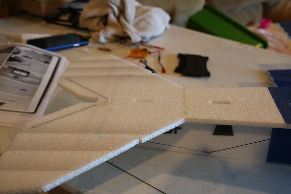

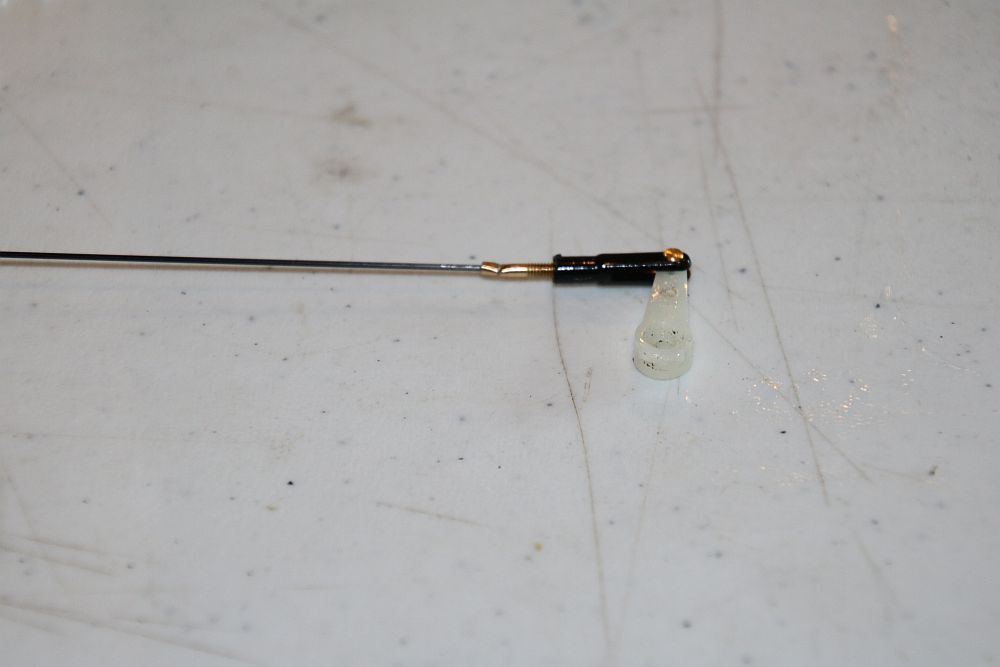

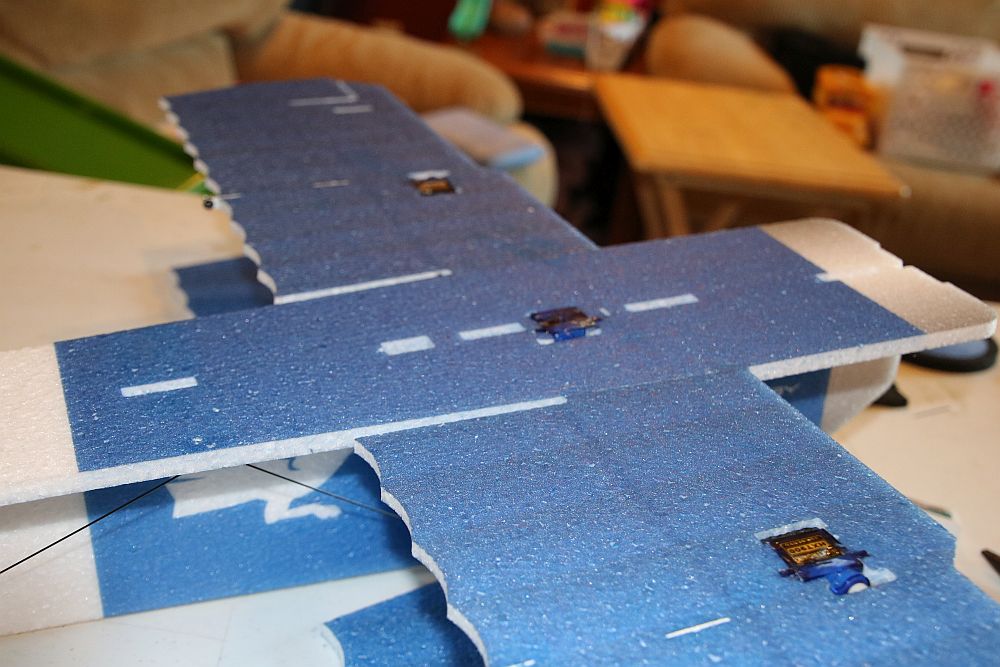

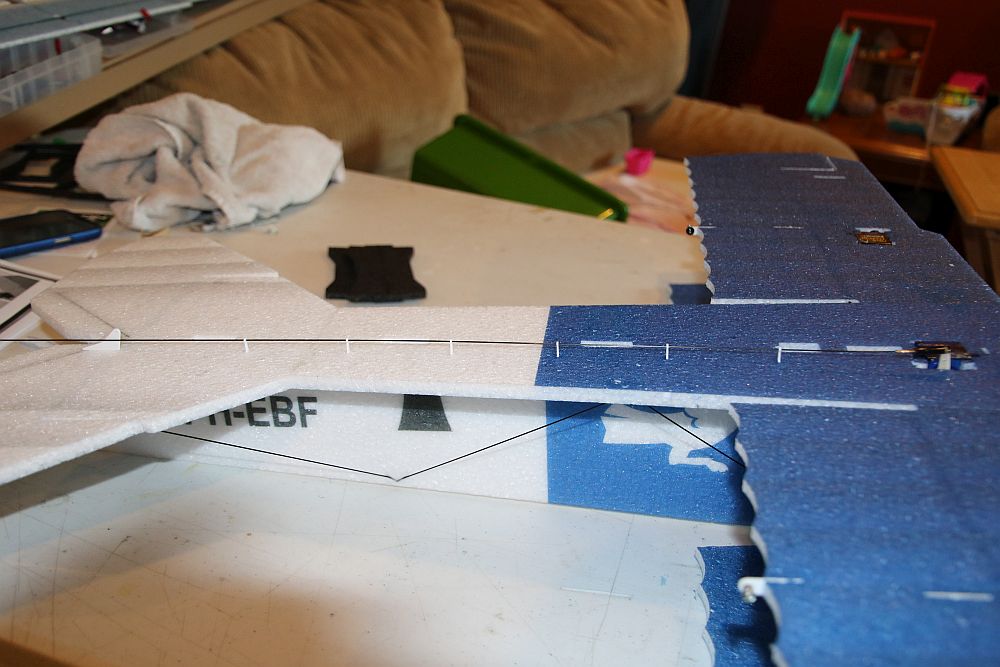

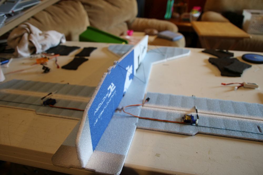

Next I set up the control rods for the ailerons. This system is pretty neat. Basically a CF rod in between 2 clasps. Set everything at neutral and glue the rod into the clasps. Added the bottom vertical fuse and some bracing.

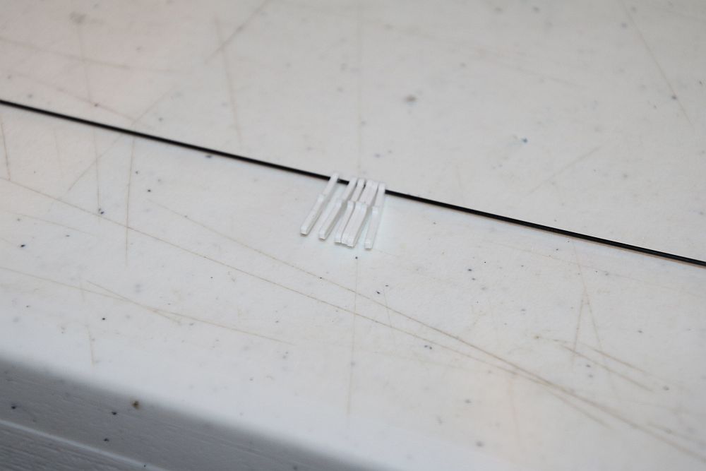

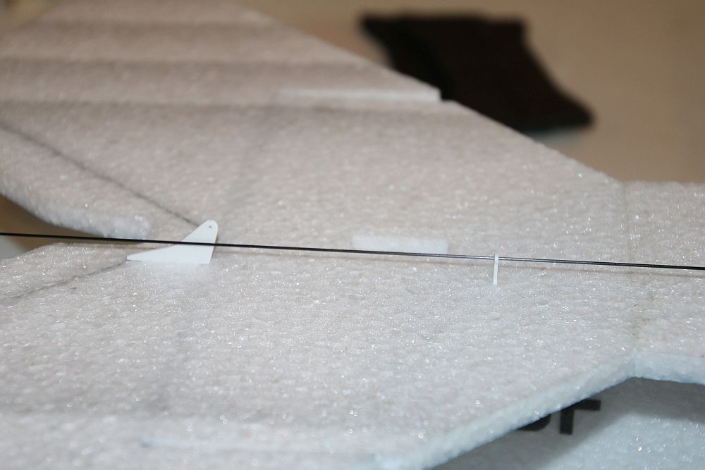

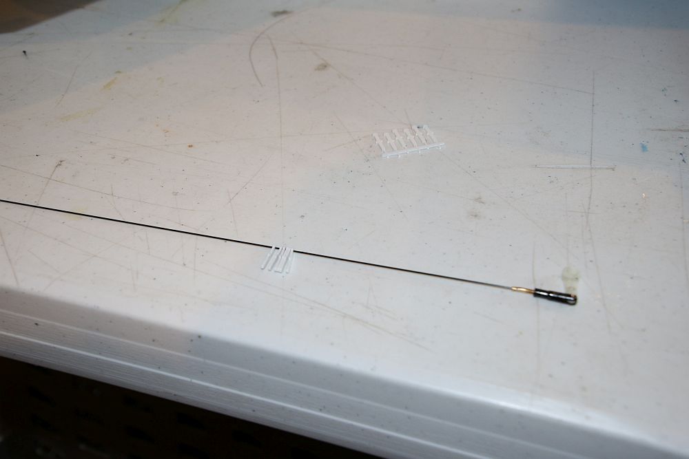

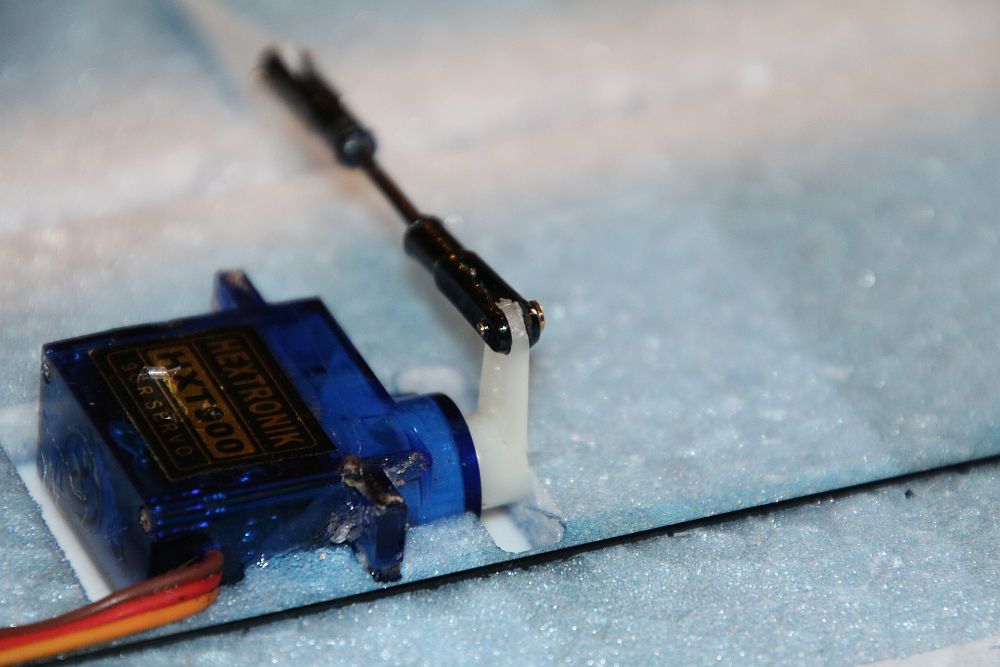

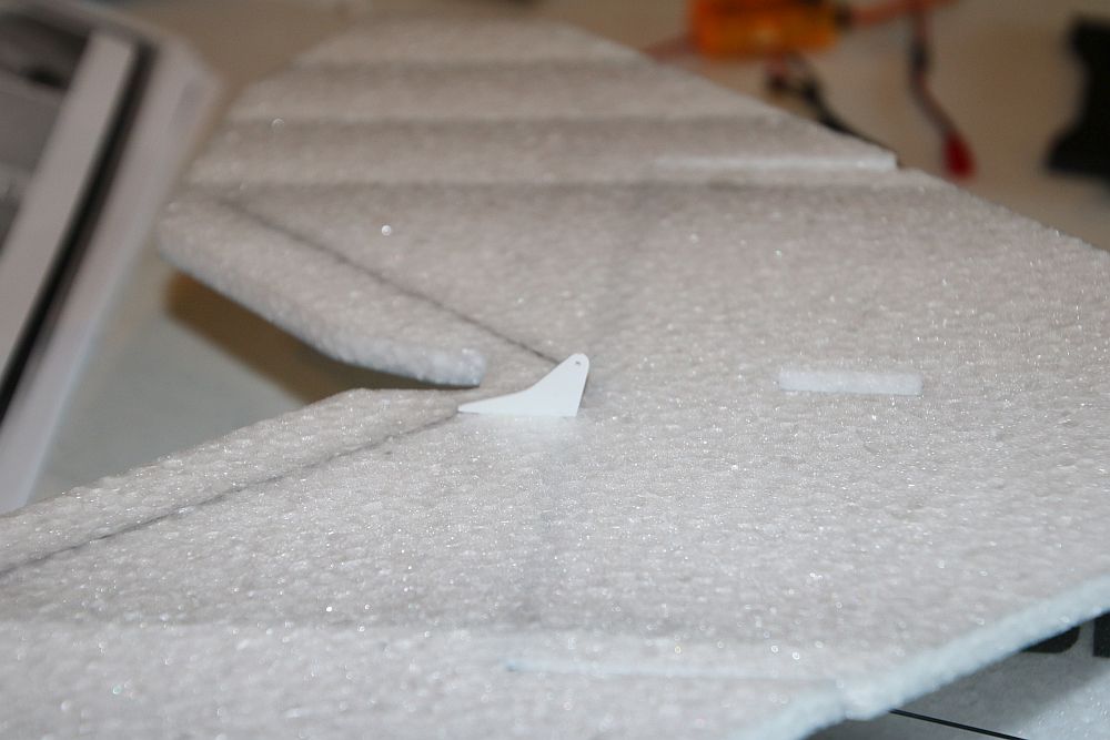

Elevator control rod. Very simple. Put the little white guides in the holes and thread the rod through. The rear clasp gets a white plastic tube. I had to open up the hole in my clasp a little so the tube fit inside of it.

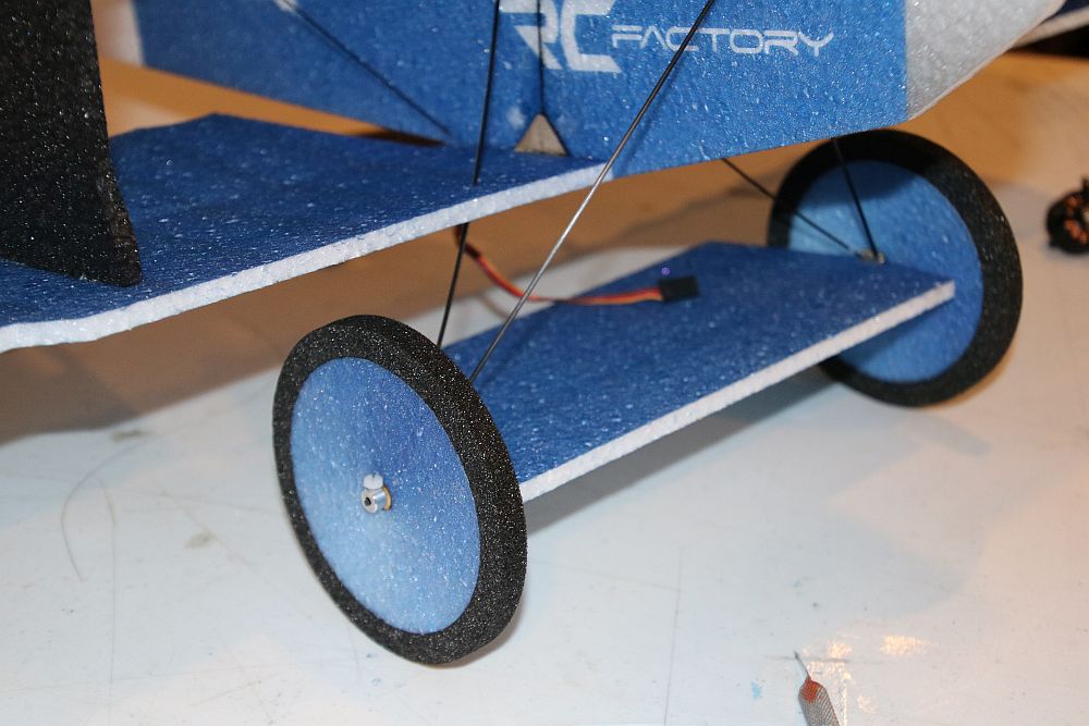

Team WTFO

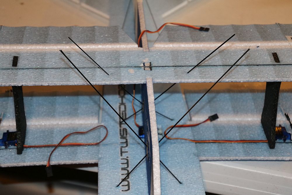

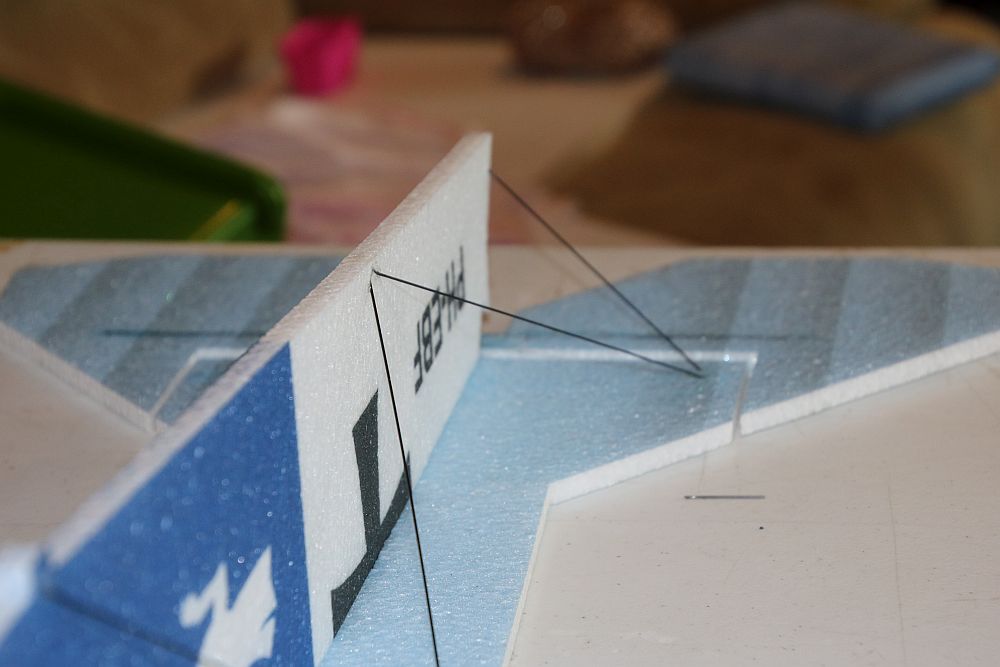

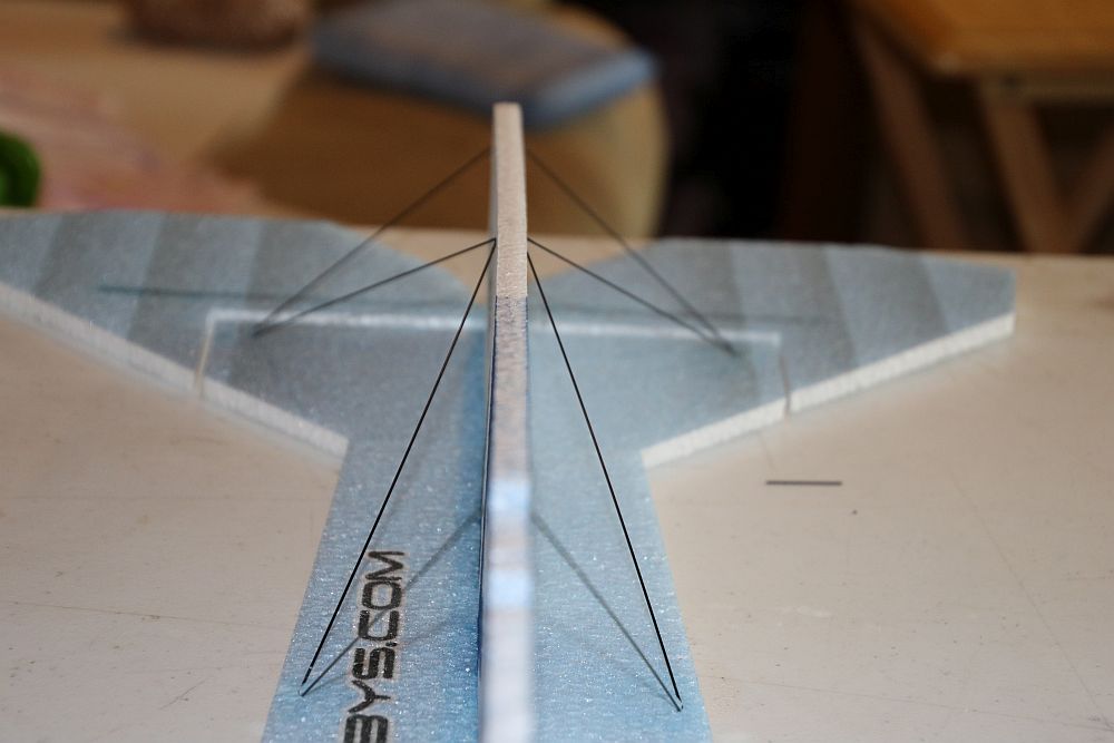

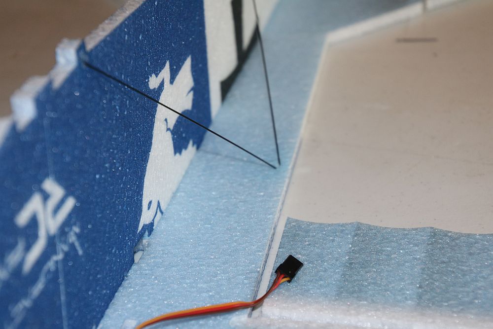

Landing gear is pretty straight forward. The instructions show how to thread the cf rods. I accidentally used 1 incorrect rod. There are 6 rods that are the same length. 4 are a diameter, and 2 are a different diameter. I used one of the thinner ones on my gear. After everything was installed, I put welders where the cf rods cross. I fill the space in the fuse and it really strengthens things up.
