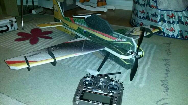

Thanks. For the flaps (flaperons) I have one problem hoping to solve. Where I fly is the ground very rough so I always handstart and land somehow, seldom smooth.. I use little flaperon on my Sbach so slow down the landings.
Since I live in Sweden among polar bears and peguins I need a Tx glove half of the year, fine when I fly helis but I do not know how to get the Yak in the air since I cannot hand launch it and quick enough get the hand in the Tx glove, with some flaperons possibly it could take off in short enough distance. I'll see when I try.
I've been hand launching mine pretty much exclusively. Just hold the plane at about a 45 degree angle, push the throttle stick up to about 3/4th, and let her go. She will climb at that angle hands off for enough time to get your hand in a mitt. For landing, I wouldn't overthink it with flaperons. You will be amazed at how well the CY flies, even at very slow speeds. With just a light breeze, point her nose upwind and you can bring your groundspeed down to a crawl without stalling. No flaperons needed. Piece of cake.

uploadfromtaptalk1416123439368.jpg Sounds great!
AKfreak
Yeah nose in the wind or no wind, use the elevator to hold the nose up, and pull the power. Keep pulling on the elevator as you reduce power, and the plane will just park on a spot on the ground. No flaperons needed, then later on just learn to hover catch.
