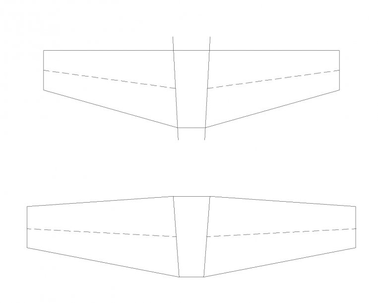

The wing shape of the Edge lends itself to stability, slow speed and post stall stability especially. As I always say that has proven true in my redneck airplane design theories....to gain something, you have to take away something. For Edges it is precision. The MAC in relation to gravity changes as the airplane rolls, so if you do a long slow roll with an edge if you you have to give it extra rudder correction to keep it from sinking when it goes towards KE. Where an extra has the swept leading edge and the MAC remains more constant and so it does not do this "bob". During "rolling harriers" this is not really evident because the wing is no longer flying.

Attached is a picture that illustrates the center of chord on which the MAC and CG are determined. If you visualize the plane rolling the wingspan shrinks in relation to gravity and changes the MAC location (in relation to gravity). I've done some reading on it, and I don't fully understand how all the mumbo jumbo works but it plays a roll on ability to maintain a horizontal line in a roll.
