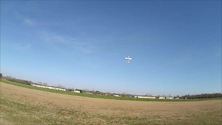

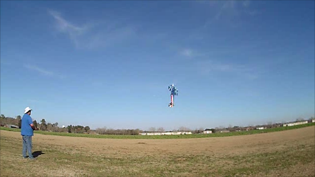

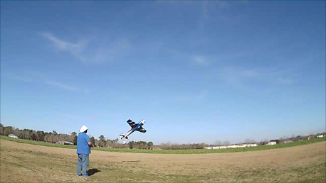

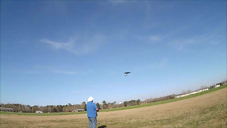

See....I can FLY!!!!!

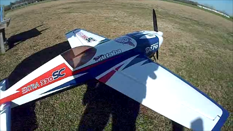

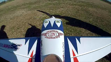

Ok. Things to do still.......Cut and glue in some foam baffles! Engine is still new and has good cooling with the louvers but I need to make a drag lip for the bottom of the cowl and get those baffles in for extended harriers and hovering.
Got a short vid processing and the best part of it is the landing. It greased in slick! Way better than the last time out. The plane tracks true in KE flight ( now ) and this thing does some really awesome walls. I will be a bit flying this thing to get comfortable with the HUGE control surfaces (have 80% expo on my elevator!) but the more I fly it now it "feels" more and more like my Edge :). I really needed this day today. I was getting bummed about the plane. The Muffler system sounds and performs great. The Falcon prop is a bit noisy though and I will be switching to a Mejzlik.
