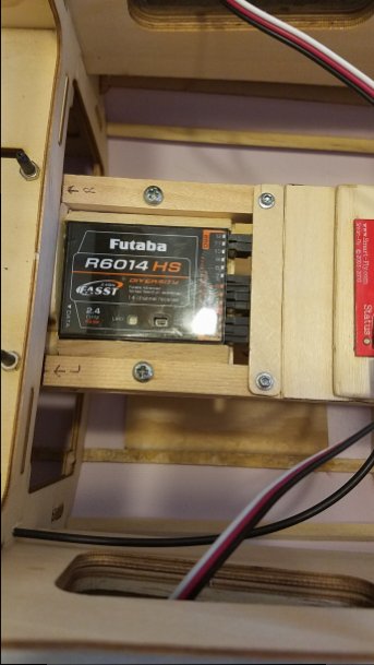

Just an update.......I started having problems with the R6014FS channel 6 port and the H 50 B servo that was plugged in to it. The servo would respond erratically. For some reason the signal voltage fell to about 3 volts so I swapped it out for the R6014HS. Got right at 4 volts signal voltage at all 14 channels and the H 50 B's all working as they should. I may install the Smart Fly board so signal voltage gets a boost to about 5.5 volts. Going to get a few flights on it with just the swapped receiver for now and see if all holds up well.
That's a little spooky Kelly. Correct me if I am wrong...but shouldn't a rx have more than 3 volts? Perhaps that's why the servo was getting all sketch on you? I have been told that while some rx are safe to around 3.6 volts, others will brown out at 3.0. I've been really pleased with the Smart Fly boards. Servos get a constant voltage of the battery you have plugged into it. 6.6, 7.4...whatever is plugged into the SF, that's what the servo's get. Also, signal strength never falls below 5 volts. The rx on the SF get a constant designated and uninterrupted 4.9 to 5.1 volts. Though many are using Powersafe rx's, I really prefer the SF. A huge plus for me is unlike a Powersafe, if a servo jams or freezes, my understanding is the battery(s) will be drained and your rx browns out. With the SF, same scenerio and the SF will isolate that circuit and your rx will "NEVER" starve for power. Now if I'm incorrect on the Powersafe rx's, someone set me straight. I may not have to run SF boards, but I don't ever want to lose a plane due to an unforseen possible power drain.

:ghost:Not only was the old receiver faulty but the older 6014FS receivers where known by Futaba to have lower signal voltage than "standard". It was mainly because of the new generation chipset at that time the 6014FS was fitted with. I posted in @Bunky.F.Knuckle servo thread about the same thing you explained but because of receiver issue. The 6014HS that's in it now is fine. Measured 4 volts on all signal channels. Servo's work great.
