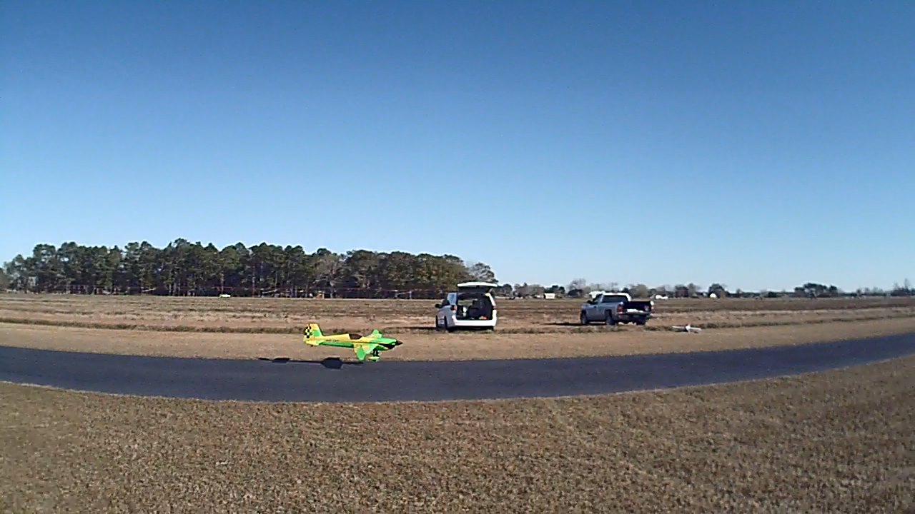

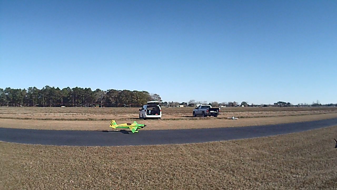

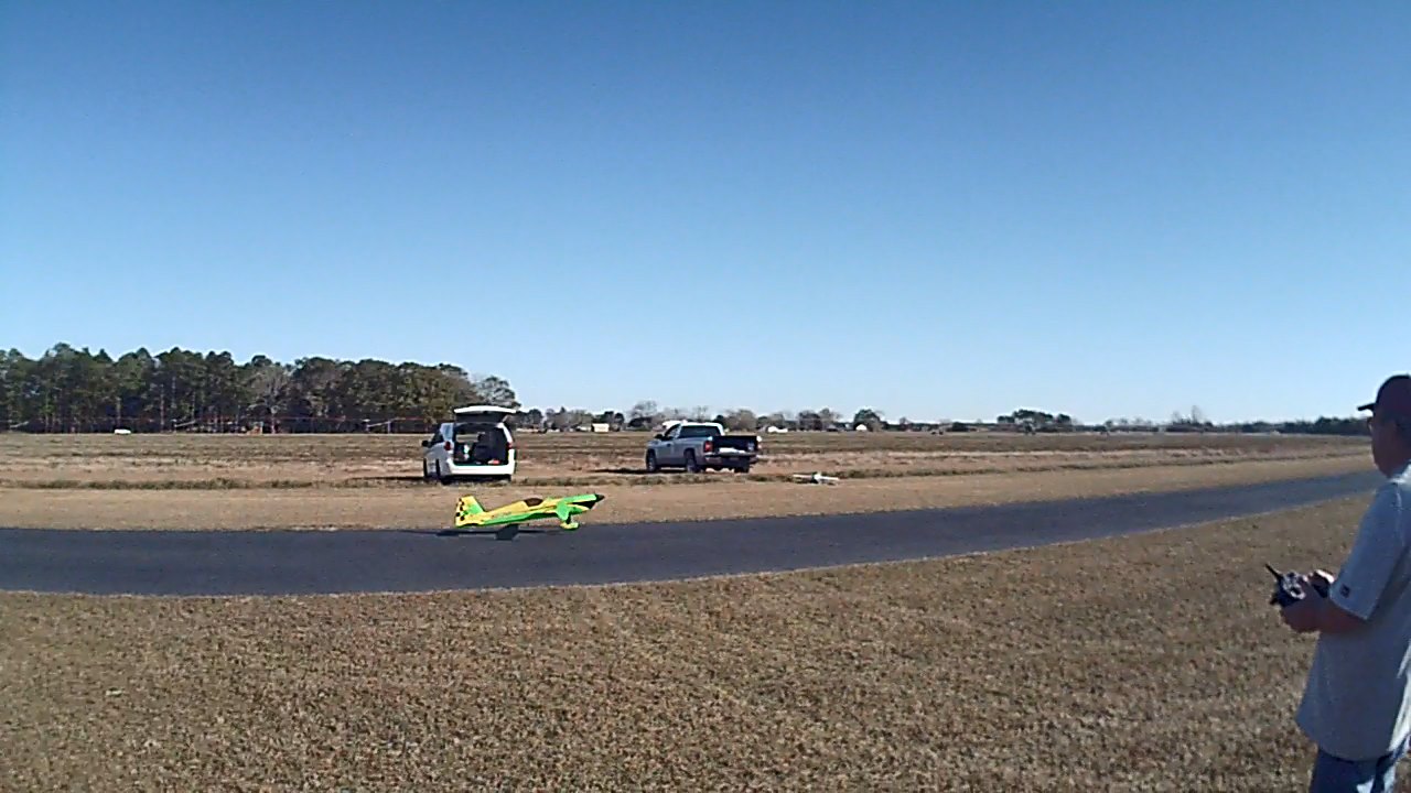

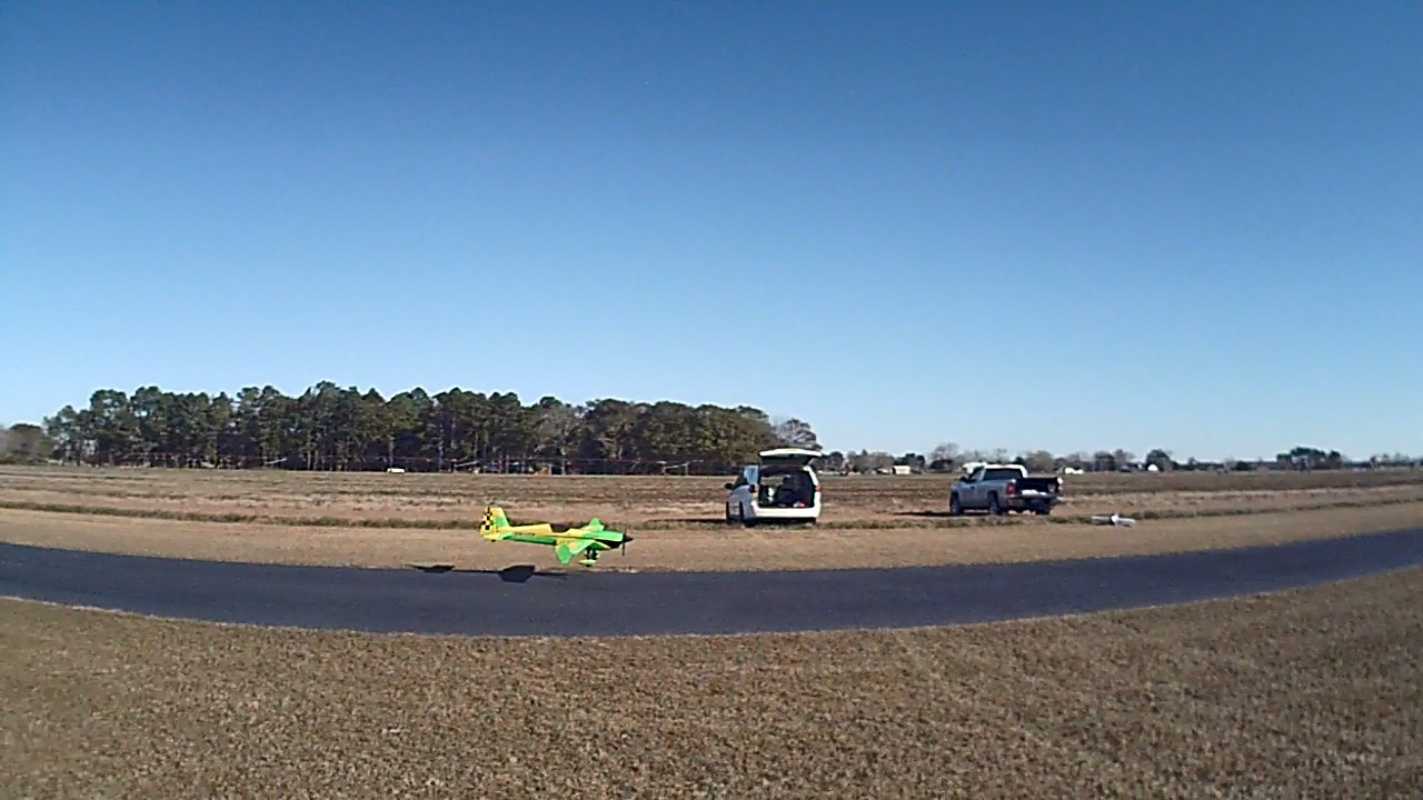

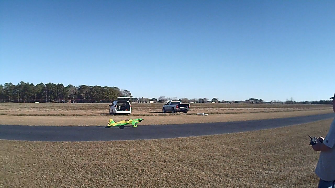

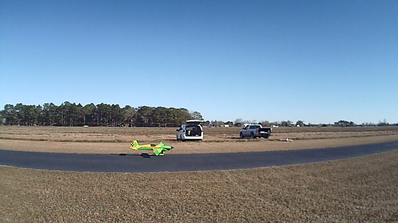

Thanks so much. Really appreciate your support. Here are some pics you can scroll and see that it's really more a stab incidence issue over CG.
The only reason I like to video a plane now is to use it as a tool to see what's going on while the plane is flying. This plane has a super huge elevator and in the pics of the landing attempt you can see that the stab and elevator are in a completely stalled state even with the elevator deflection for a flare. Main wing was stalled or starting to allowing the undercarriage to absorb the landing force and then spring back forcing the nose up and having to immediately apply power. The stab incidence at the LE is set too high or "positive" rendering the elevator useless even though it is a huge one. Proof is in the pictures......
20171211-173854.JPG 20171211-173908.JPG 20171211-173945.JPG 20171211-174012.JPG 20171211-174109.JPG 20171211-174151.JPG
Here are full images so you can better see the elevator deflection......
