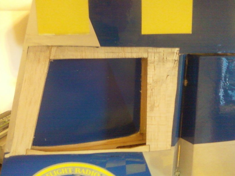

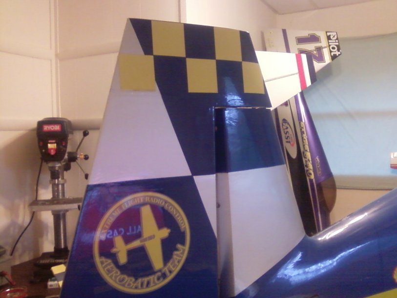

Some little wrinkles around the numbers that will never come out and the seem overlap above the numbers is ok but prone to wrinkle again because the two pieces have been stretched differently. It's ok and flight worthy. A new one is 35 to the door. I would spend that just getting the other covering and decals to make it match exactly. Glad I had some silver left when I fixed a friends EF edge. Photo230.jpg Photo236.jpg It just takes a bit of time to get the part in.

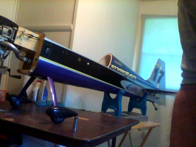

I will put the original wheel pants on when the new rudder shows up and get her looking factory new. As long as I don't "bag" it first. Sure hope not. This is the longest lasting plane I have had to date for what abuse and stupidity I throw at it. It has been a great "go to" plane. Well...I'm get'n to it:).

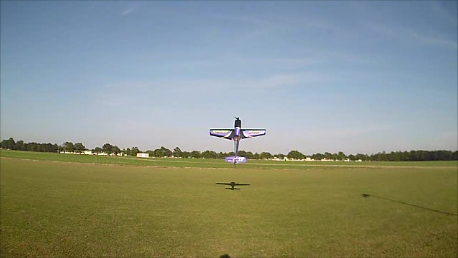

The weather has changed down here. Not so much of the crisp stuff. I reset the needles to 1.5 turns out each and leaned the low just a hair. Barely an 8th turn. The vid shows what I got. Will fly it now to see if the needles are good.
87 ethanol pump gas red line 32:1 83 deg F humidity 82%.
