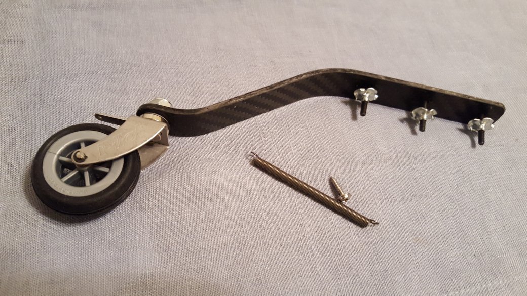

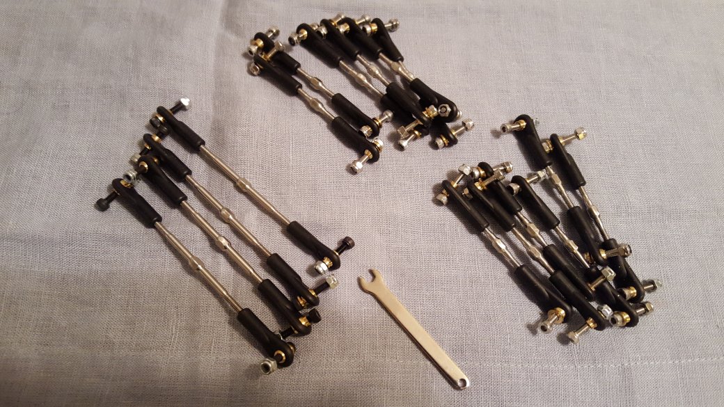

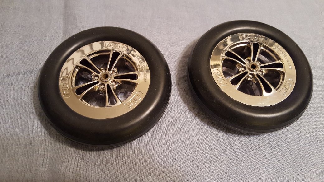

The wheels make good book ends, Tailwheel is a great back stored in the trailer, the ball joints are fine on 50cc or smaller but the recycled plastic starts to wear on the ball and flutter begins. I have a collection of Pilot fuel tanks in a box somewhere. The plane itself is fantastic. Fly's better for me than most any other 40% or other brand for that matter. Needs to be a slight tail heavy. I have used the DA 170 on it but lacks power for me. The GP is what was on all of mine. The ZDZ is heaven

That is some good info, right there! Okay, my favorite saying is "a word to the wise is sufficient." So, I won't run the tires! haha Toss the balljoints, too, huh? Okay, I'll replace them with DUBROs. I've had some offbrand ball links snap in two, but never a DUBRO. Was looking forward to not doing any plumbing (crazy Smok'n Joe McBride took my H9 Sukhoi included fuel tank out of the box and didn't inspect it or anything and is running it in his Carden DOD :O lol). But, okay, I'll put together another PSP/Fiji tank.
