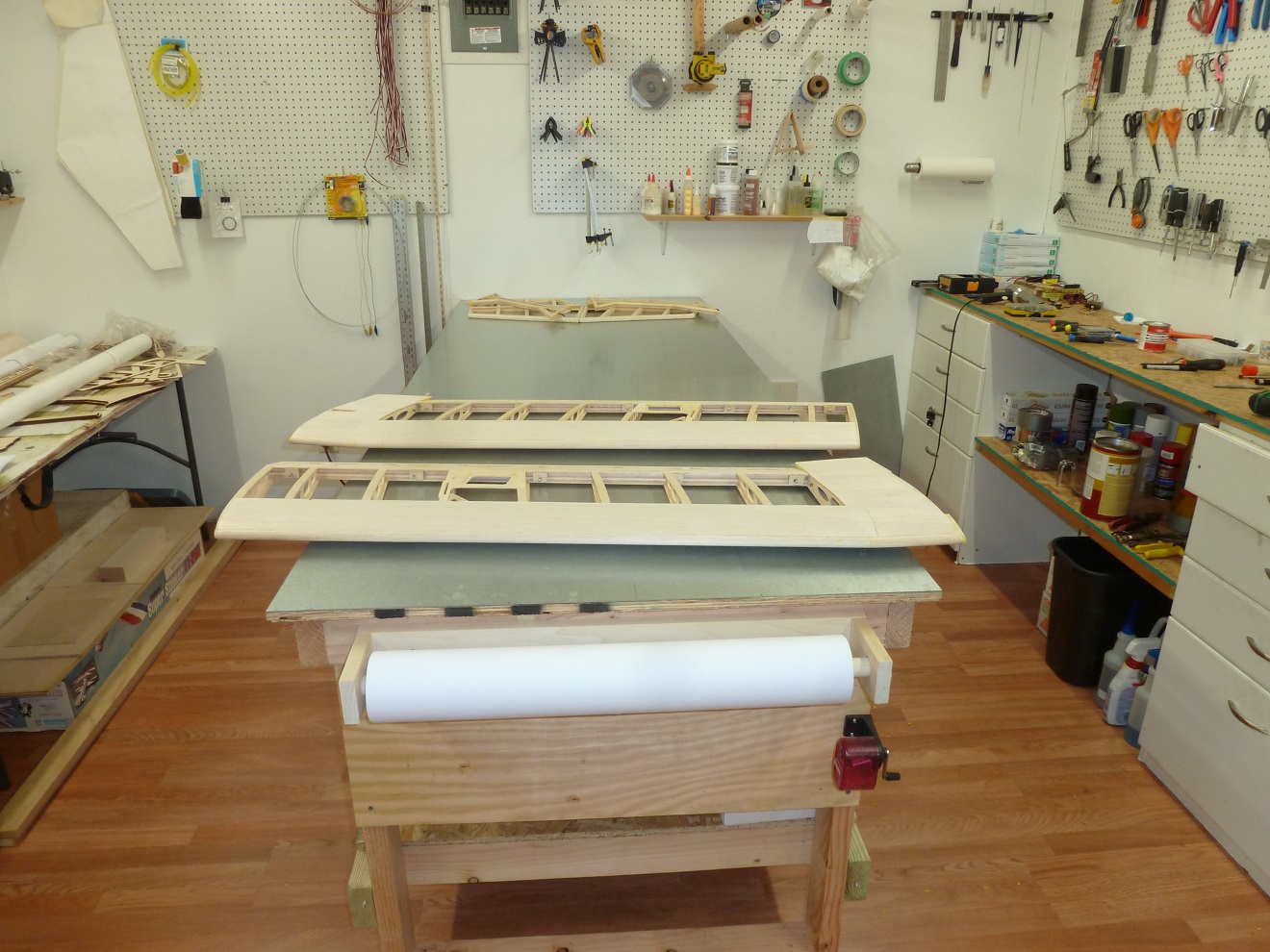

And the top wing, now to move the electronics to the rear of the cockpit and maybe give it a light sanding.
