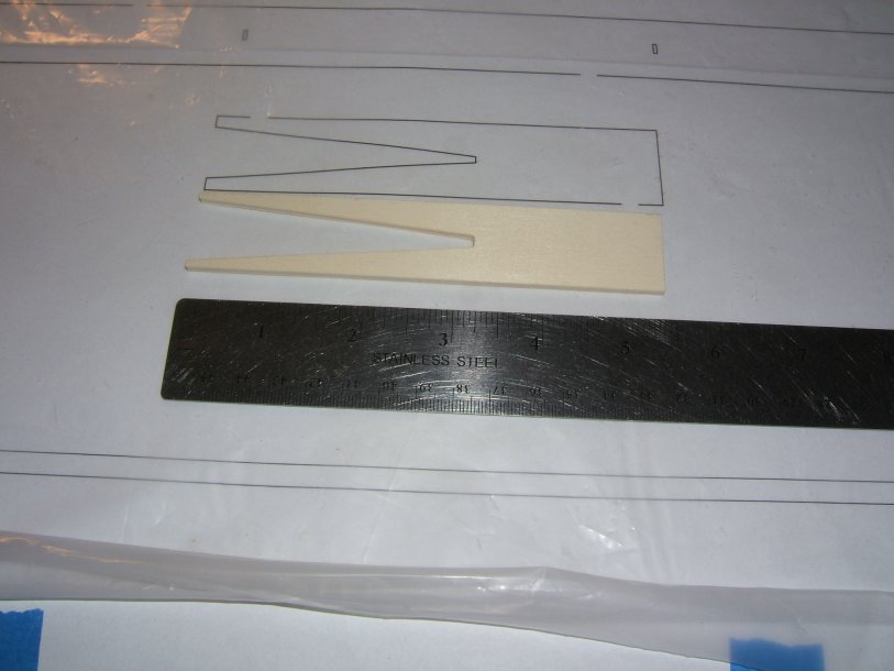

One part on the Pitts 3.04 lower wing can't place. Can you tell me what and where it goes????

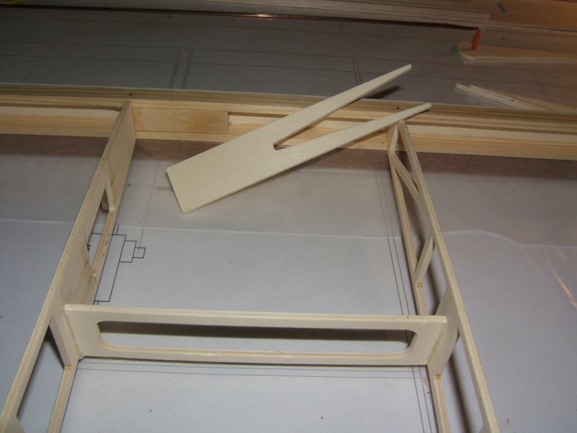

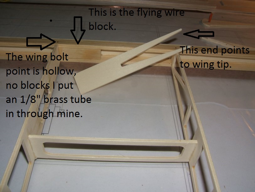

That goes on the front side of the rear wing spar and the rear side of the front at the flying wire mount. In the pic they are laying in their respective position, the open end points outward to the wing tip.

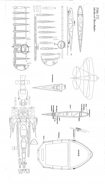

Jaketab
Ace,
Reference the attached pic, is this the location where its to be pasted ?????
Since I already have a hard block of ply there to support the strut mount - is this part relevant ????
It appears there is no 1/2 round pine blocks in the kit for the wing strut bolt through mounts.
Did you have to make your own??? Could make out of pine dow rod ????

I would imagine it is relevant some how, as well engineered as this kit is I don't think anything would be there if not needed, how it is needed I do not know. See pics for added detail.

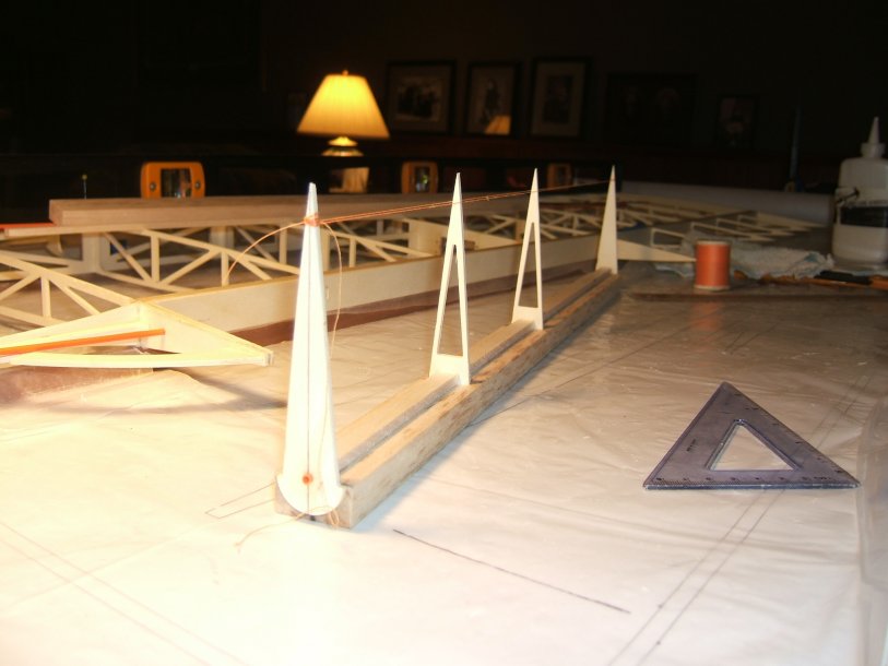

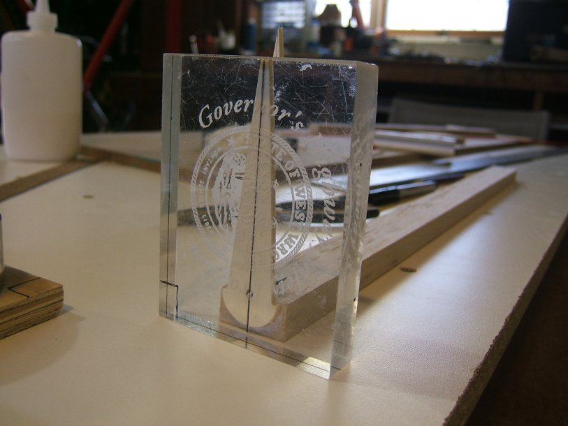

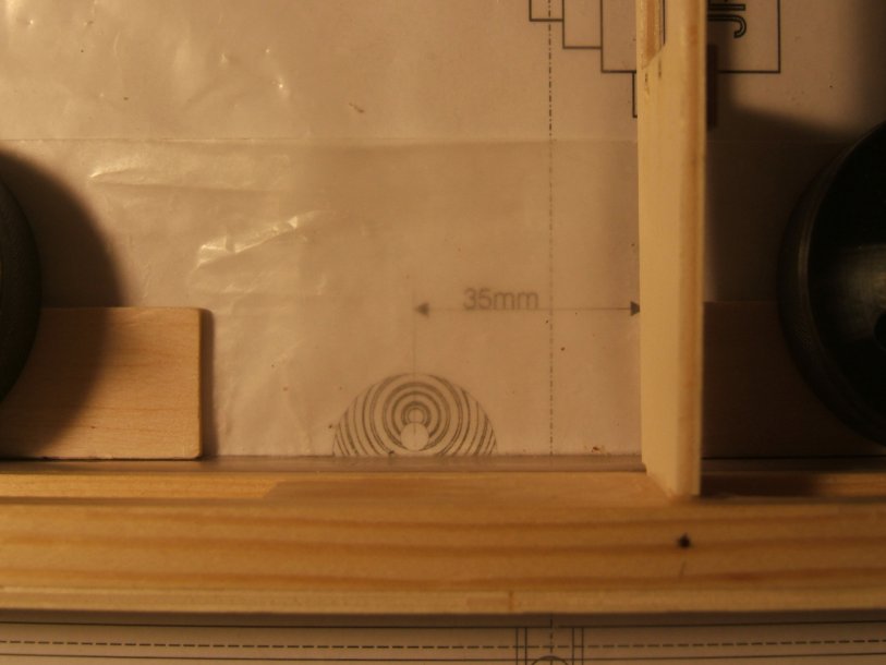

The strut attachment points on the big Pitts is just inside the leading and trailing spars.
Other 2 pics show lining up the aileron ribs and use of a paperweight collecting dust for 20 years.
