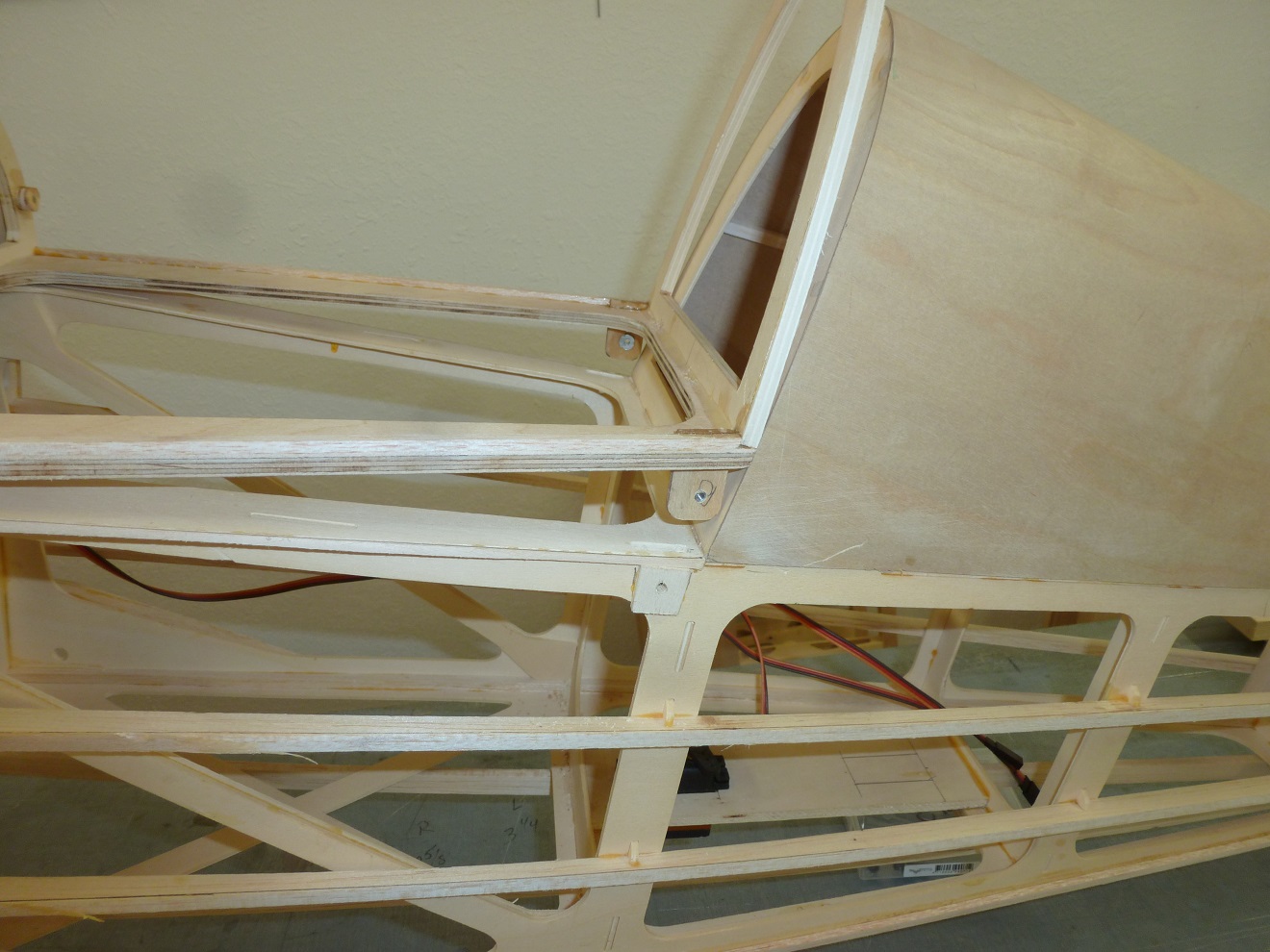

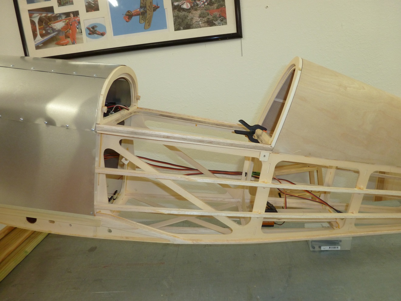

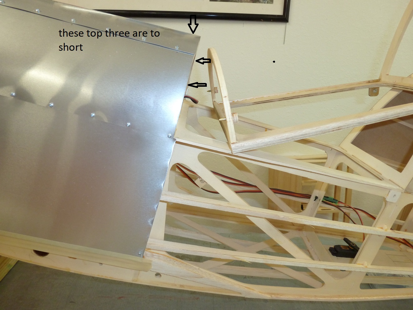

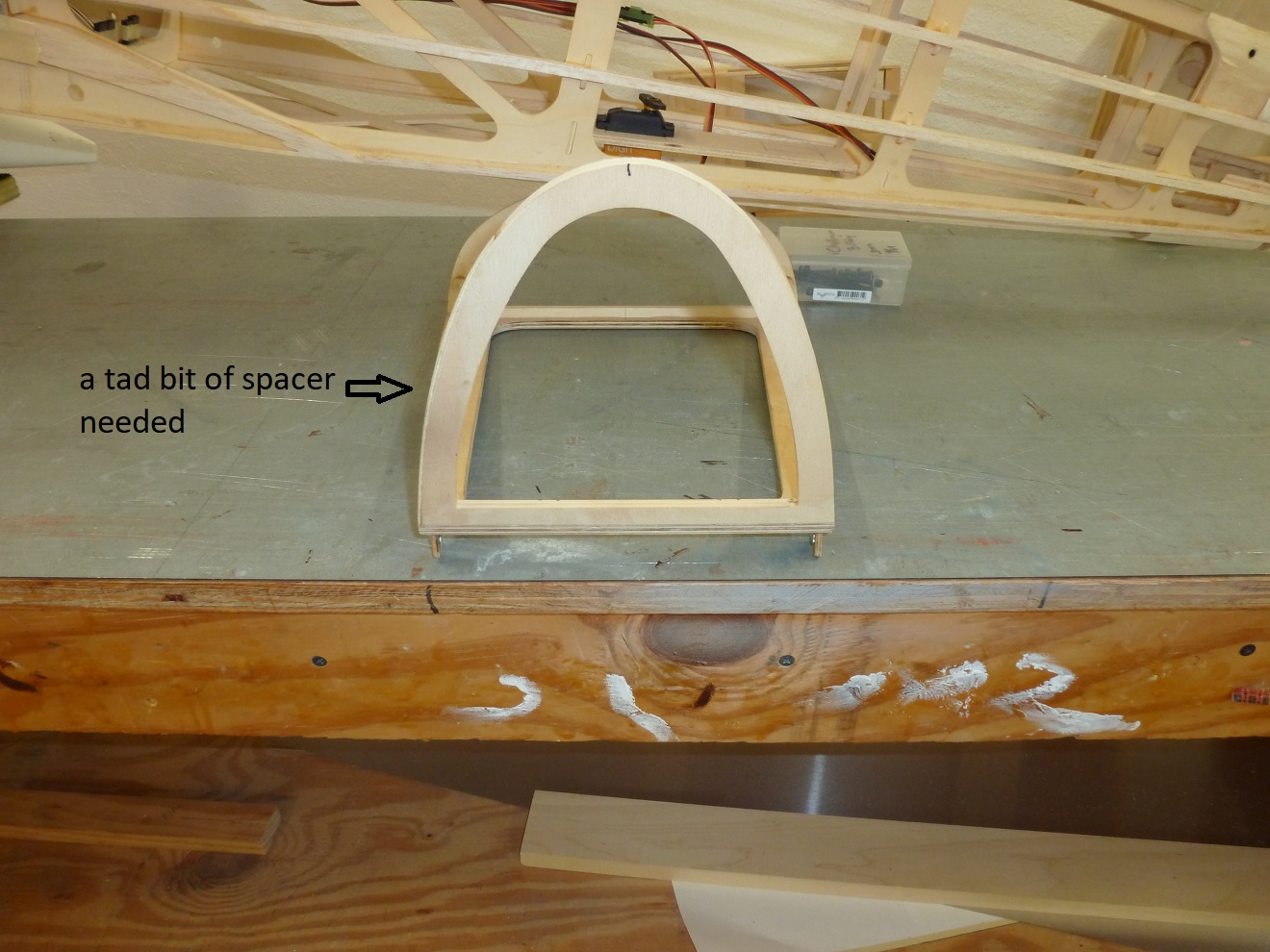

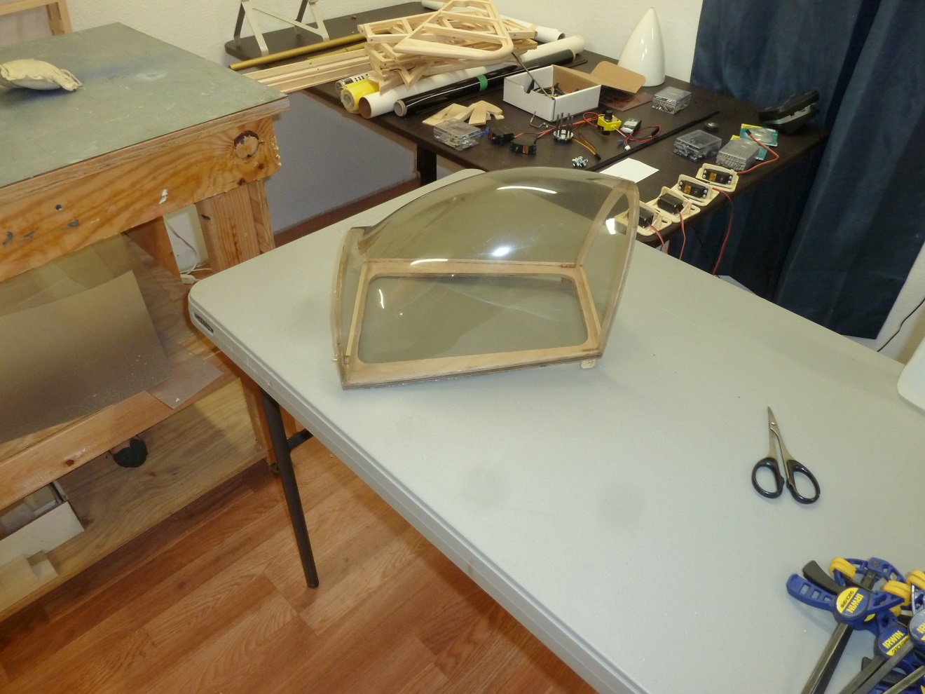

The hatch has had the front pins and the rear bolt through's installed. It fits well but had to make a tiny bit of shim on one side to match the fuse. The canopy has been trimmed close and a trial fitting done, it fits real good, I won't trim it flush until it is glued on. Now I just have to figure how I am going to add the adhesive around the perimeter of the frame and put the canopy in place without getting adhesive all over everything. Also will have to go back and recut the top three aluminum panels as they are a bit short, the canopy should slide under just a bit instead of fitting flush.

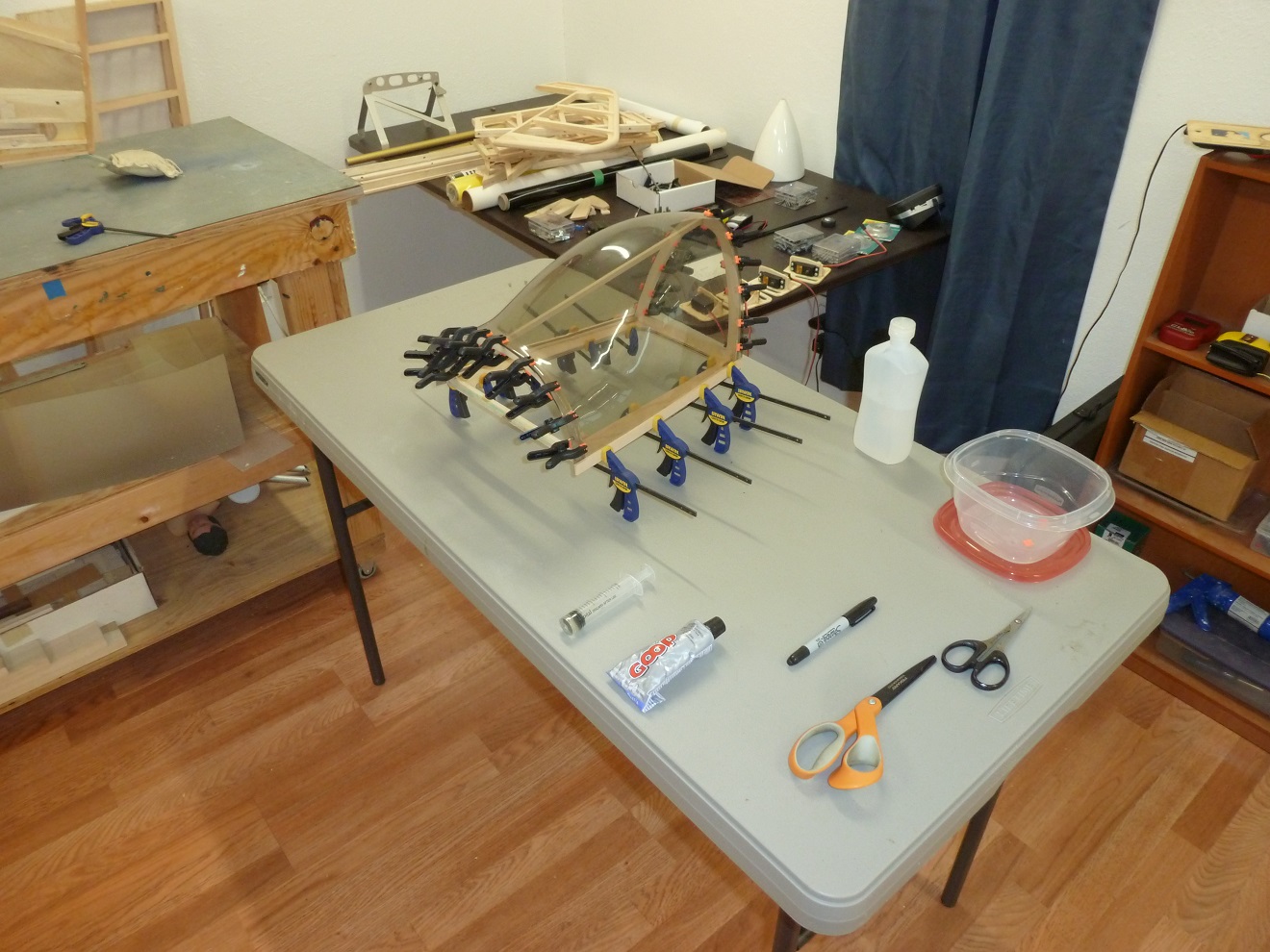

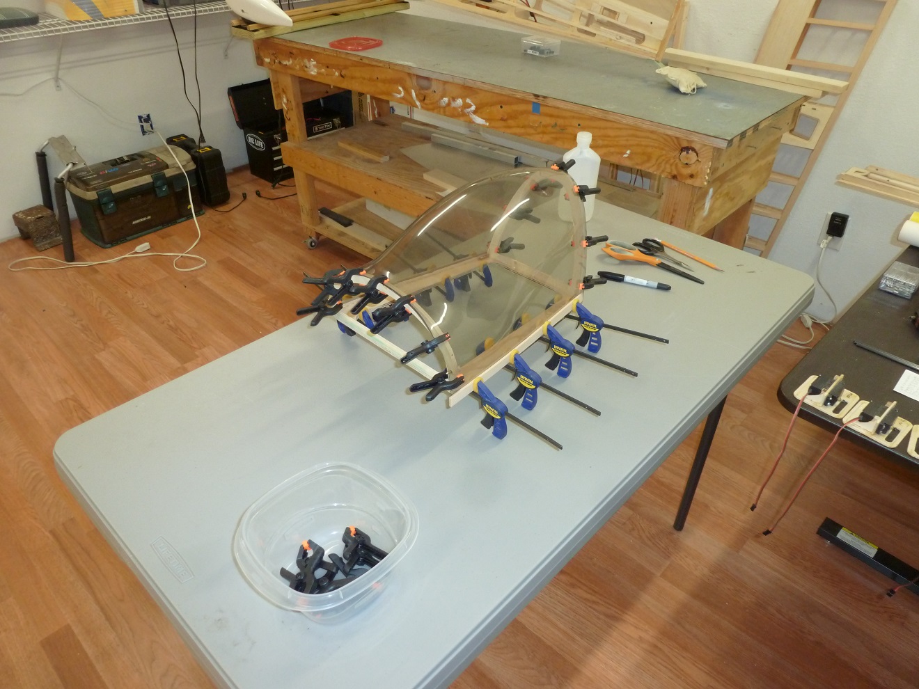

I was sitting here pondering how I was going to keep this neat and clean. Then it hit me, I don't have to, it is going to get some trim paint around the perimeter, more than enough to cover the glue joint. So I ran a bead of Goop and clamped it together, now to wait for four hours.

You are committed now, now you have sit back for a few hours and see what you have ended up with looks good though, looks like you have sufficient clamps on it to keep it nice and smooth and straight.
Using the syringe placed a nice 1/16" bead mostly centered around it, when clamping it on it looked to spread evenly within, or on, the frame.

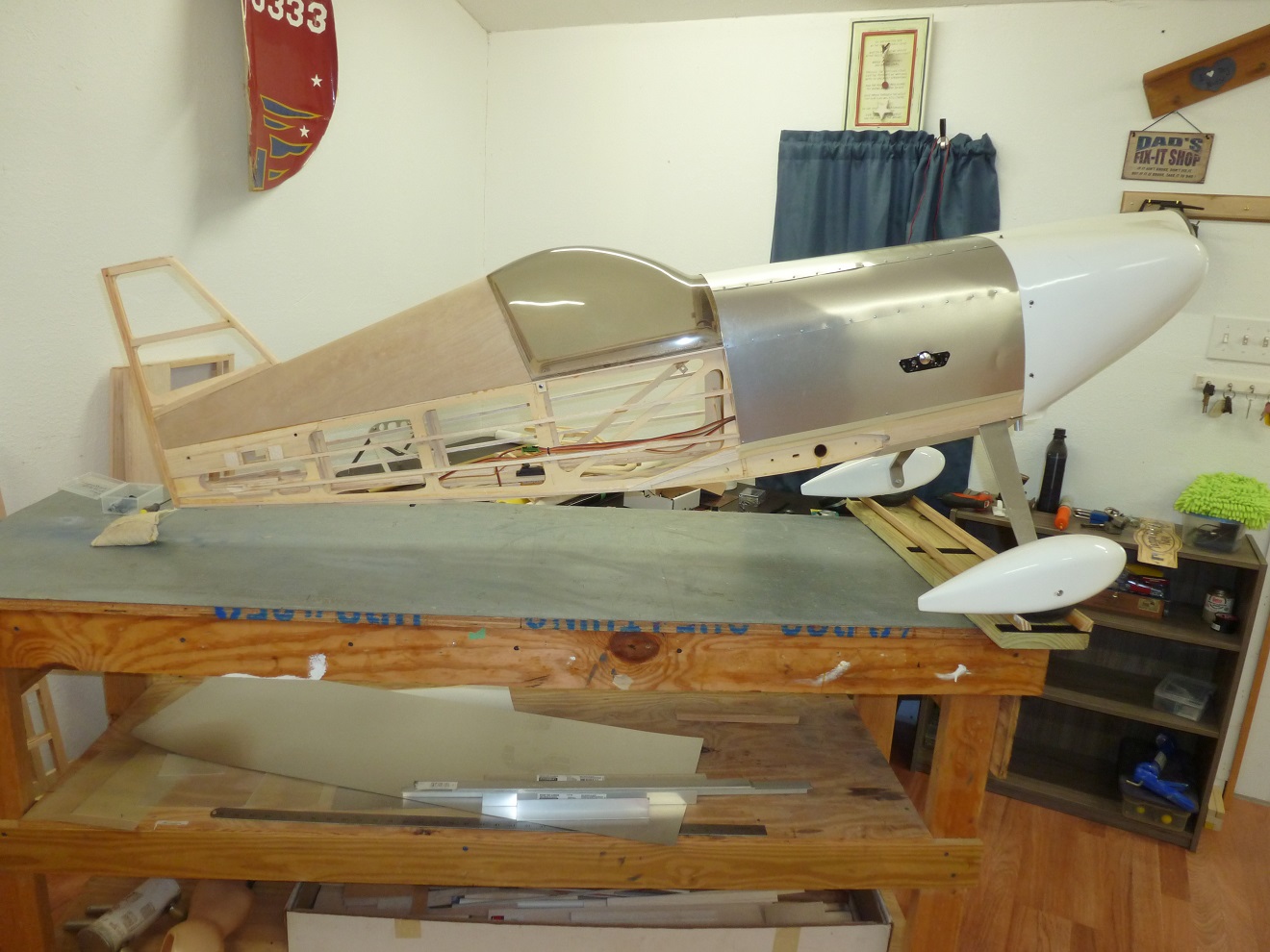

That was the last thing needed built on the fuse, now I am thinking about the cowl. I really hate that smiley face and am not about to cut it out. Was thinking about using some of the expanding foam to fill it, sand it, glass over it and then cut out the openings but as with anything not yet tried I do have my reservations. As thin as they make these cowls I don't think cutting it out then glassing it would go well, but then, I could just leave segments in to hold the nose's shape.
I'd consider any suggestions, might give me an idea for a different method.
