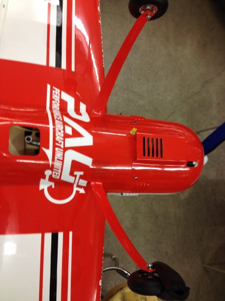

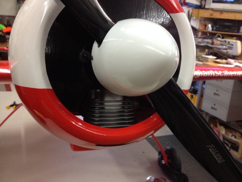

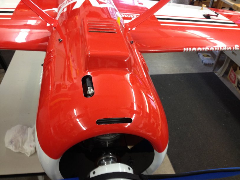

Smitty,
the 61 is a great fit for the Sukhoi, I run a Mejlik 24x8 carbon and it hauls it perfectly.

Smitty
I really like the way you did your cowl, I will be putting a Pitts style muffler on mine. I am in the process of ordering everything so when the plane gets here I will be ready.--Smitty
