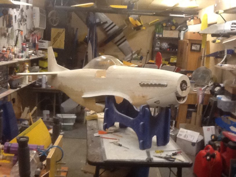

I just looked at this picture closely for the first time. Holy Crap! What a mess. I'm Embarrassed, big time. I've been really busy at work and with issues at the house. My time in the shop has been limited and so I've been stepping over stuff and leaving things where I used them and now the perfect storm. Next pic will be in my shop the way Im used to having it.

Your P51 looks AWESOME ! ! ! ! BTW, Don't worry about the messy shop. Cleaning it up will take away too much build time:big_yes:

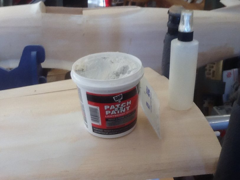

I've been really busy lately and haven't had a chance to work on the Mustang. I've spent 5 minutes here and there but nothing to write home about . This weekend I did get some time to make some significant progress. What I want to show you is finishing technique that I'm using. Now, before you think I came up with this, I read about it on RCSCALEBUILDER. There's 3 things you need. To find out what they are keep reading.
Red Raider
The idea is to spread the spackling out as thin as you can with the spreader. I've used water to soften it in the can before, but the new thing here is to use it on the model. As your spreading it, it starts to dry and starts making crumbs.
