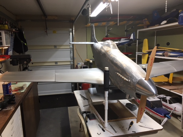

I forgot to put the exhaust stacks on for the first picture. They were difficult to do, but sure turned out better than my usual attempts.

I know I said hinging was my least favorite thing to do when building from plans. It’s not. Sanding is. I sprayed the plane with the Montana Gold spray paint. As it turns out, it’s not as horrible as I said. I think buffing it out and spraying it with clear coat, it might’ve been ok. But, since I’m using Wingswestrc paint, I sanded the entire plane twice. Once with 120 wet, then with 220 wet. Trying to find a bright spot in all this sanding, (3 days worth), I was able to fix a lot of small errors that showed up under the Silver. Now, the spray paint makes an excellent primer/base coat. Ordered the paint tonight, expect it probably Thursday. Until then, I’ll finish the hinging and install the power box.
