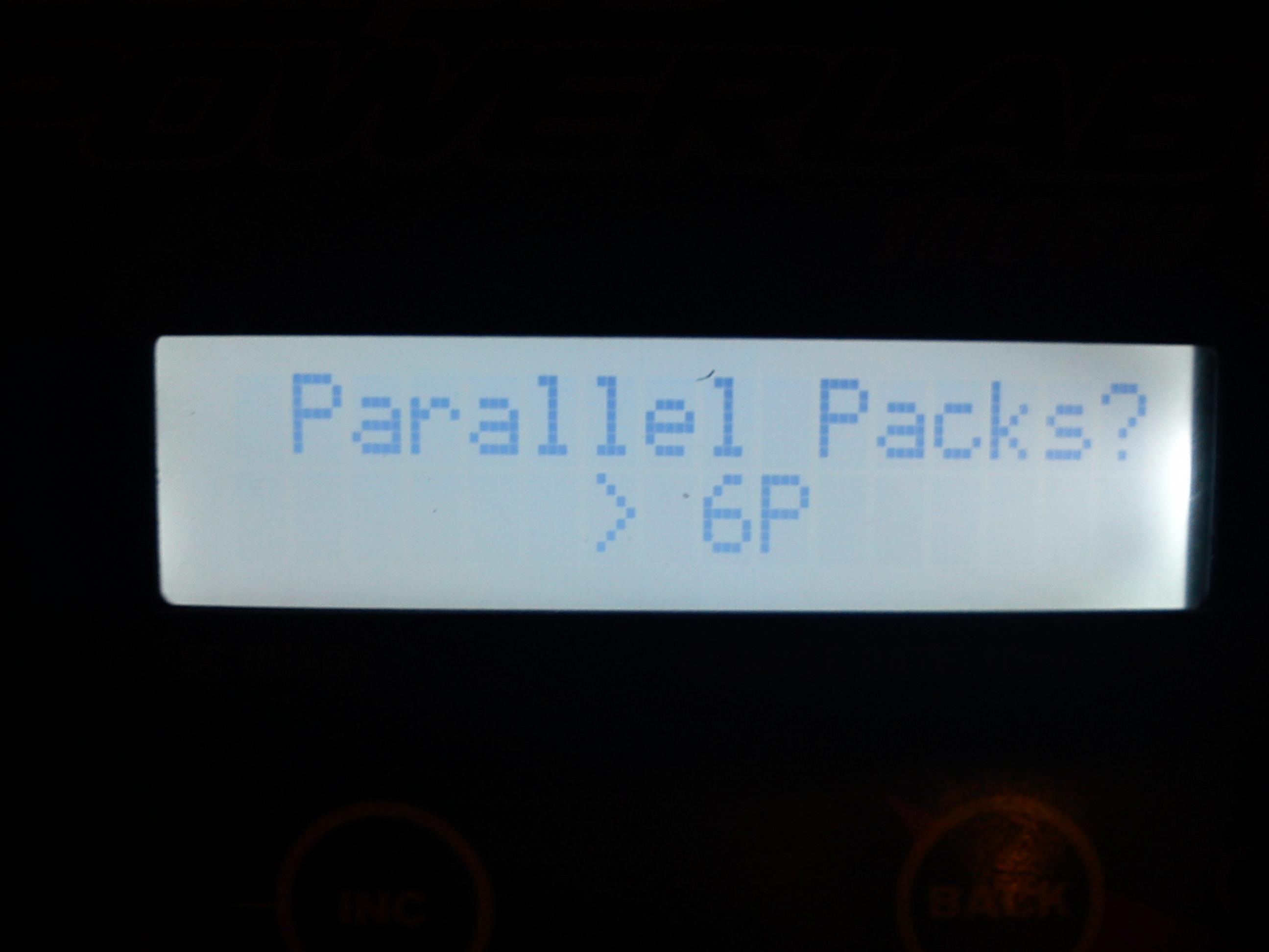

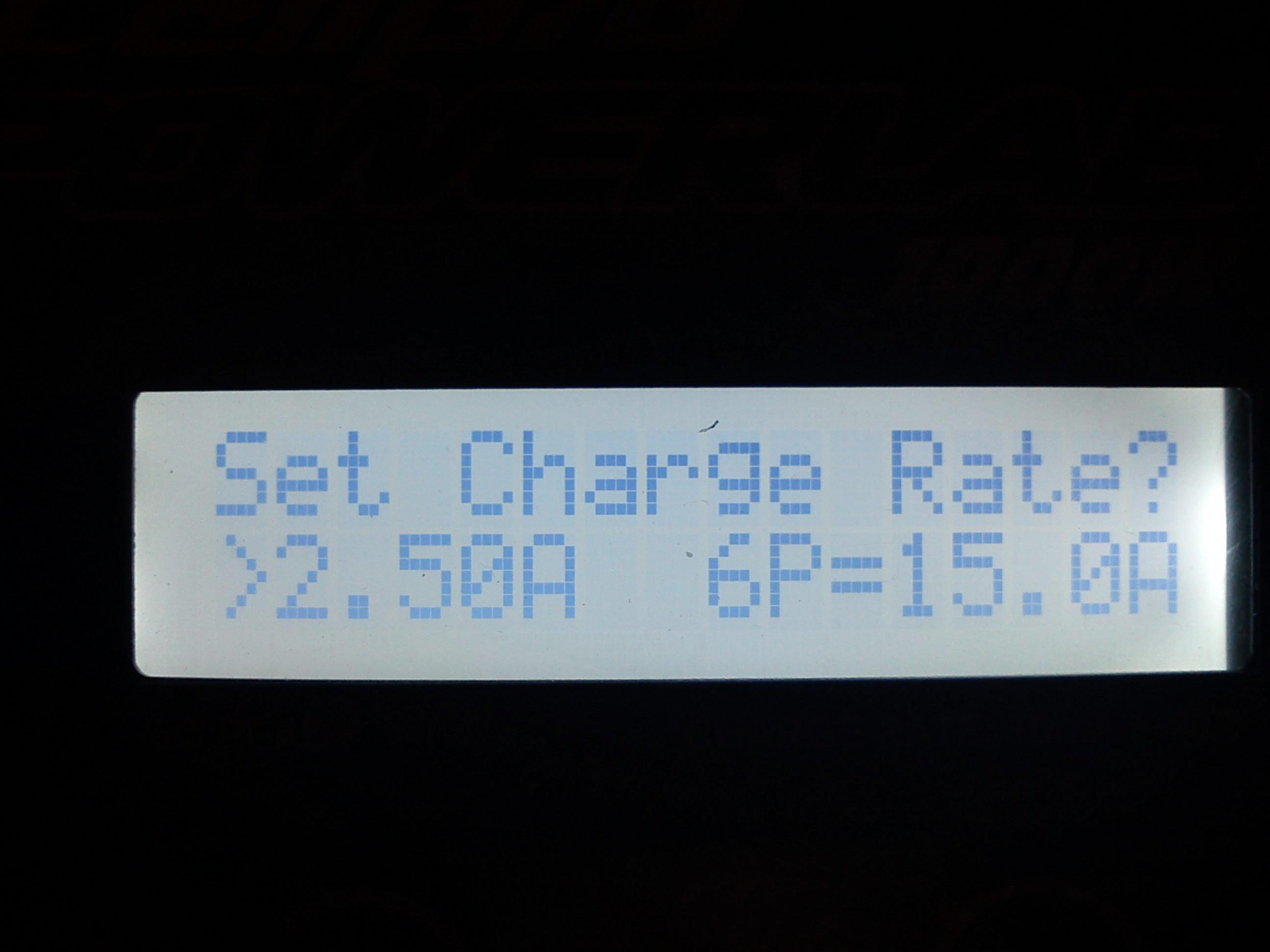

I've personally been using the powerlab 6 40A 1000w "battery workstation" and have loved it since i got it. I would sit at home and charge for 4 hours before i could go out and fly for 20 minutes before i got this powerful charger. Now i can safely charge six 6s packs in 30 minutes! The best part about this is, of course, more flying time!
There are many safety features built in and it is setup to with parallel charging in mind. There are fused balance boards and paraboards so if one battery blows it will pop the fuse instead of killing all the batteries. The powerlab will also ask before start up how many packs are plugged in and then let you set how many amps per pack and the powerlab will multiply that by the number of packs you selected. So, if i plug in six 4s 2500s, it will ask how many batteries IMG_20121212_183253.jpg IMG_20121212_183311.jpgi enter 6, then i enter 2.5 amps for a 1c charge rate and it multiplies it automatically for me for the number of batteries

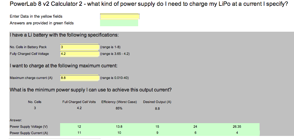

I have looked at those calculators and I have yet to convince myself I understand it.
For example I want to charge two 2200 3cell lipos in parallel at 2C.
So 2200 parallel = 4400 (I believe), * 2C = 8.8 amps? Is this right? So, how many amps does my power supply need to provide to be able to do this charge.
My power supply is: 12volt 47 amp 564 watt
Using the first calculator on their site, I plug in the numbers for one lipo and it says the max amps is 38. So is this saying I have more than enough to do the job of 2 in parallel or am I messed up on my numbers?
Seems to work just fine.
Ohio AV8TOR
Just Do It
Two 3S 2200's at 2C you are not even breaking a sweat for your PS and charger. I don't get 38A however I see it as 11A @ 12v.
The second calculator ( "what kind of power supply do I need to charge my LiPo at a current I specify") to determine the PS,
