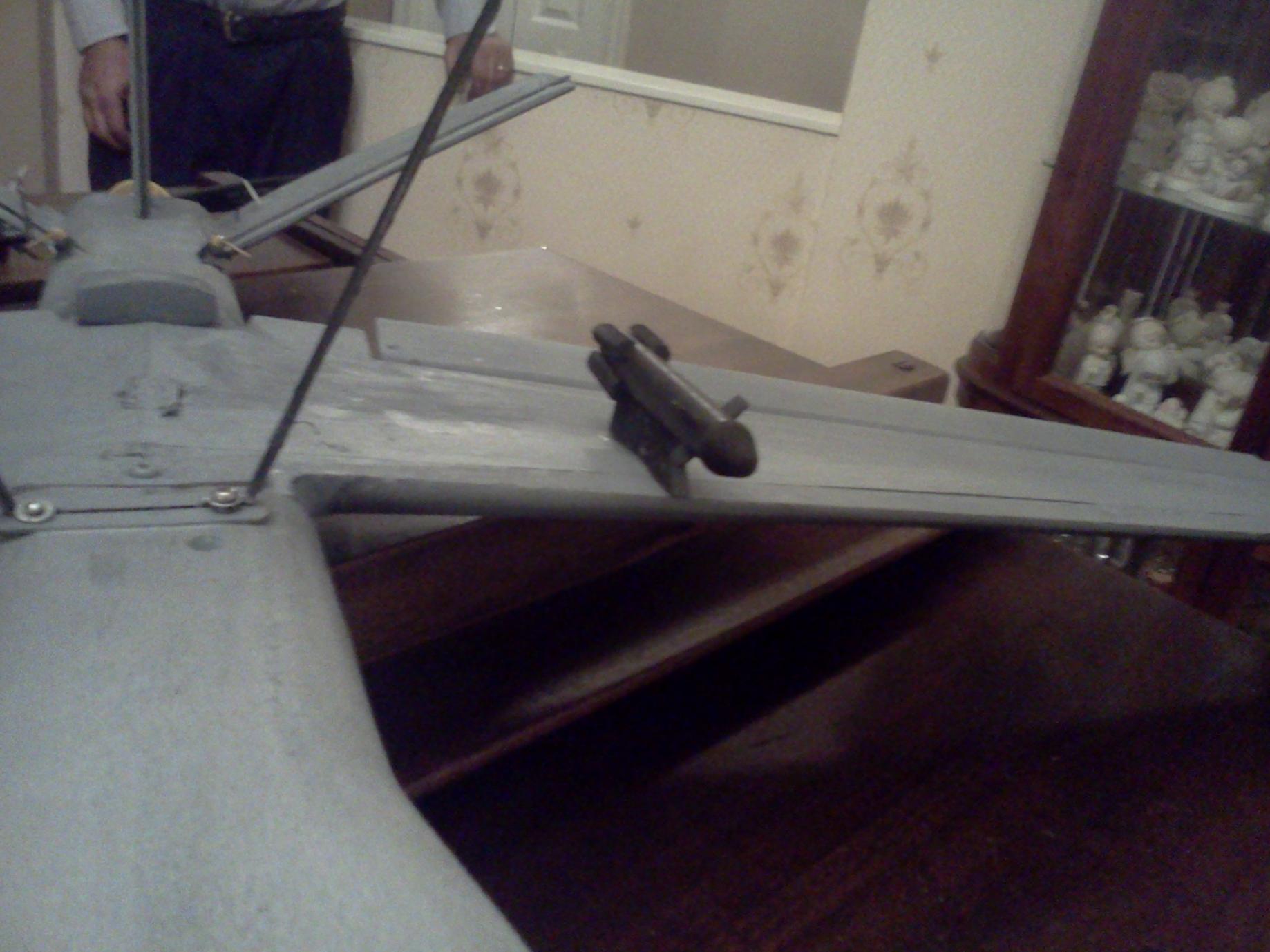

for sure i was thinking of putting something towards the nose since i had to add about 20 grams of clay...were did they sit on the wing?

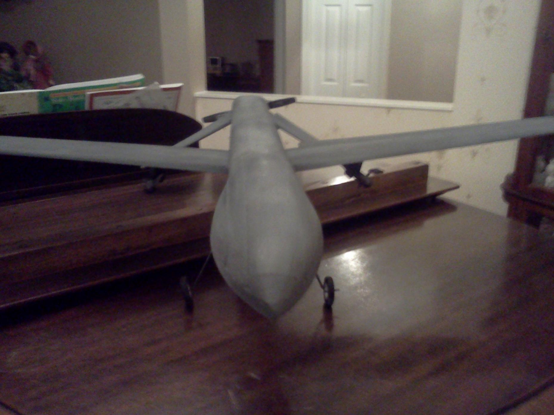

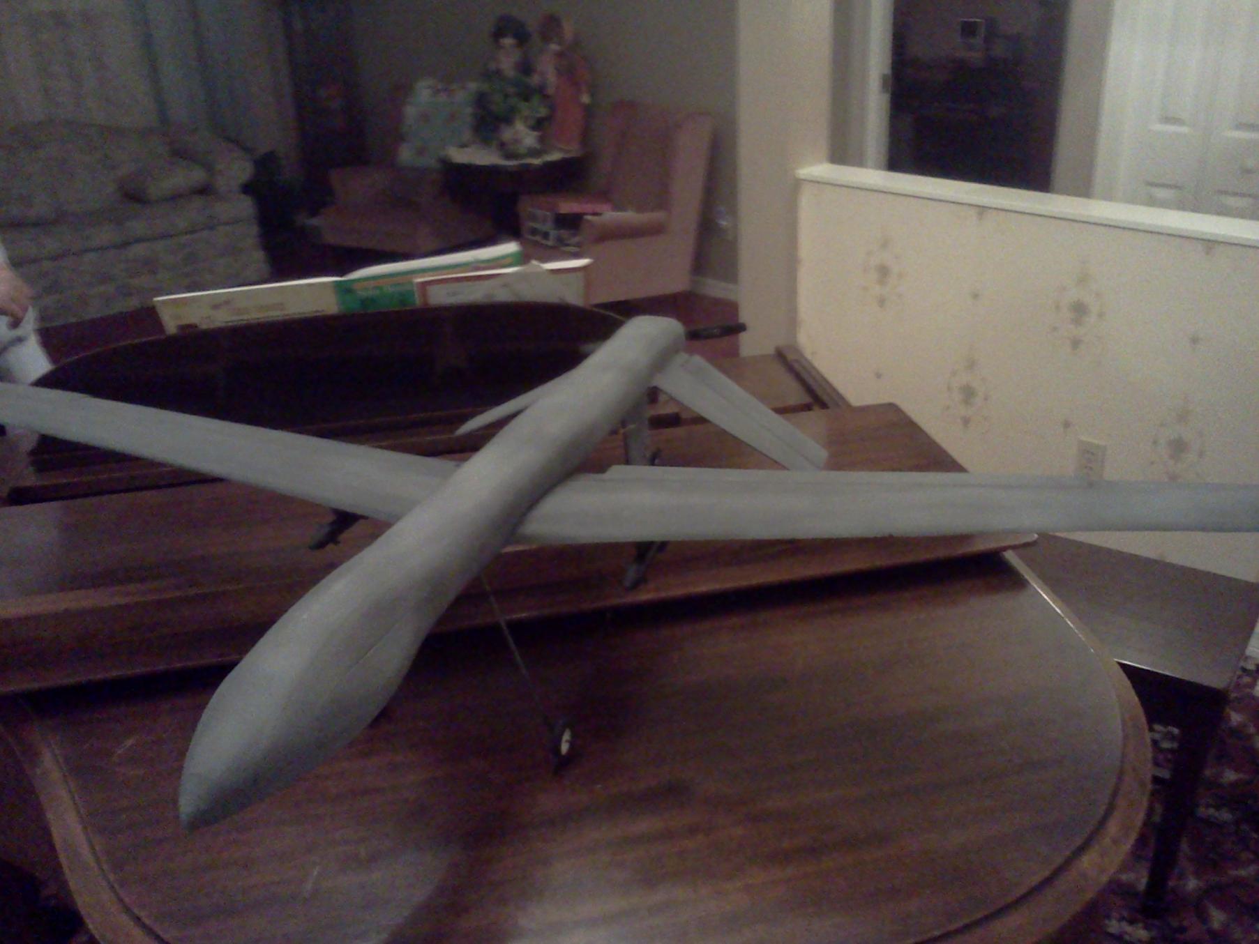

Either way, it's a nice looking replica! I've seen the real one pretty "up and close" and you did a good job :)

The OPs custom job is much more curvy and scale looking than the cheap ARF I used!
that looks great i almost went with a reaper but wanted the down v-tail I have never done it before...I agree its not all that fun to fly but it was a fun build. Next build will be a 3d-er just got to figure out what...when im out of med school im buying a 3dhs but untill then ill be making them lol NJswede you asked for hellfires well there you go :) not the best pics but ill get a re-maiden flight video when i go this weekend

That's some seriously nice custom shaping there!

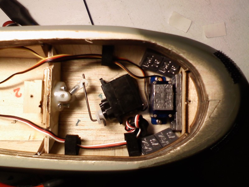

It was just a 480 line Sony PCB camera connected to some thin plywood by screws through nylon spacers... then another shorter piece of ply glued together perpendicularly in an L configuration. There is a HS-55 servo mounted upside down with the control arm screwed to the plywood, so I could pan it left and right.

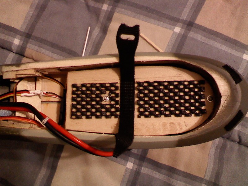

I don't have a better picture of the camera, but I do have a picture showing the pan servo I was talking about. The plane had fixed nose gear, so I made it steerable with a dubro kit. Then I mounted a piece of plywood to cover that and mount the 2650mah 3s battery. It was tail heavy... so you can see some lead up there.
