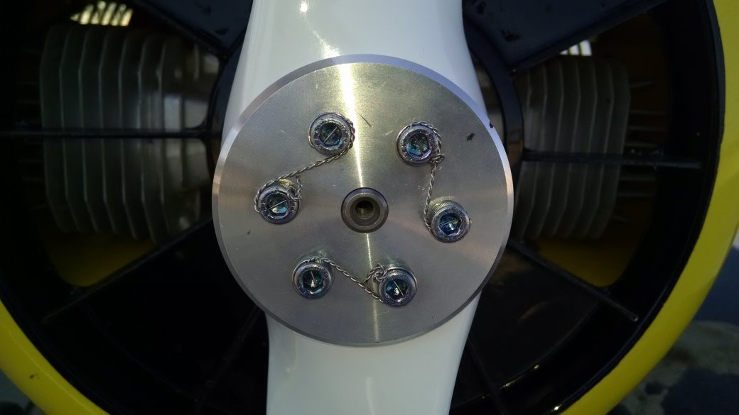

Here's my way of keeping prop bolts from backing out,,, ;)
