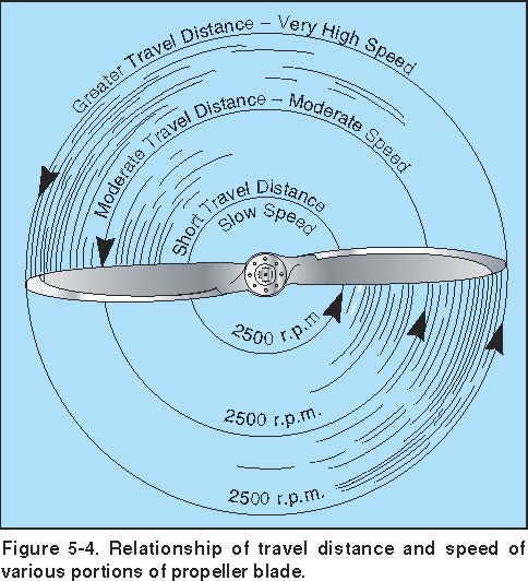

Which would you think would be better biela 30x10 or mejzlik 30x10? I'm looking for fast spool up but trying to keep the rip under control
Neither. Go down to a 27x11 Falcon CF or a Mejzlik 27x12TH. By going up in prop diameter, you are making it easier to bark a prop. 30" prop on a 120cc airframe and engine is not the answer to prop rip. There is a diagram out there in cyberspace somewheres describing what most are trying to give you advice on doing. I will look for it and post it here. Again, 30" props are not the answer to prop rip. You could load it with pitch, and it will be stupid sluggish. Heed our advices, and try a Falcon 27x11 or the Mejzlik 27x12TH. Both will offer instant spool up and making it harder to rip the prop.

Try this link too.... http://www.warpdriveprops.com/propspd2.html By saying keeping the tip speed under .7 mach is key for full prop effeciency.

Try this link too.... http://www.warpdriveprops.com/propspd2.html By saying keeping the tip speed under .7 mach is key for full prop effeciency is key.
