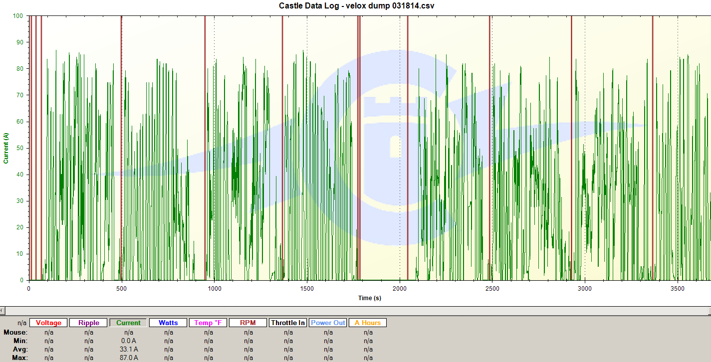

Hacker A50-12L Version 1 with xoar wood electric 19x10 prop, ICE100 and bec PRO on the 70" velox v2.
So it looks like the talon 90 should work. Max amps was 87 and max watts was 2016
