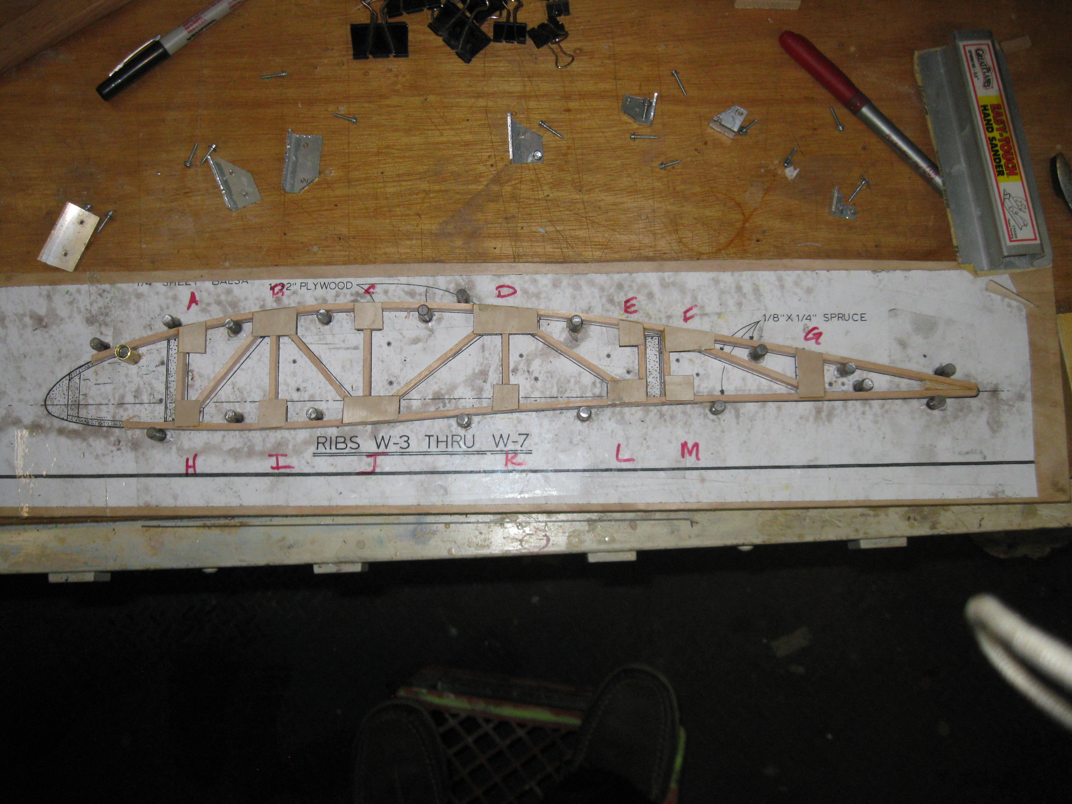

  1. IMG_2105.JPG My first build here on GSN, so let's get it started. I started building the ribs last winter while recovering from back surgery. There are a total of 50 pieces in each rib. I made is jig out of 3/4" plywood. I think the maximum ribs produced in a day was three since I was using Titebond II glue and I wasn't going anywhere.

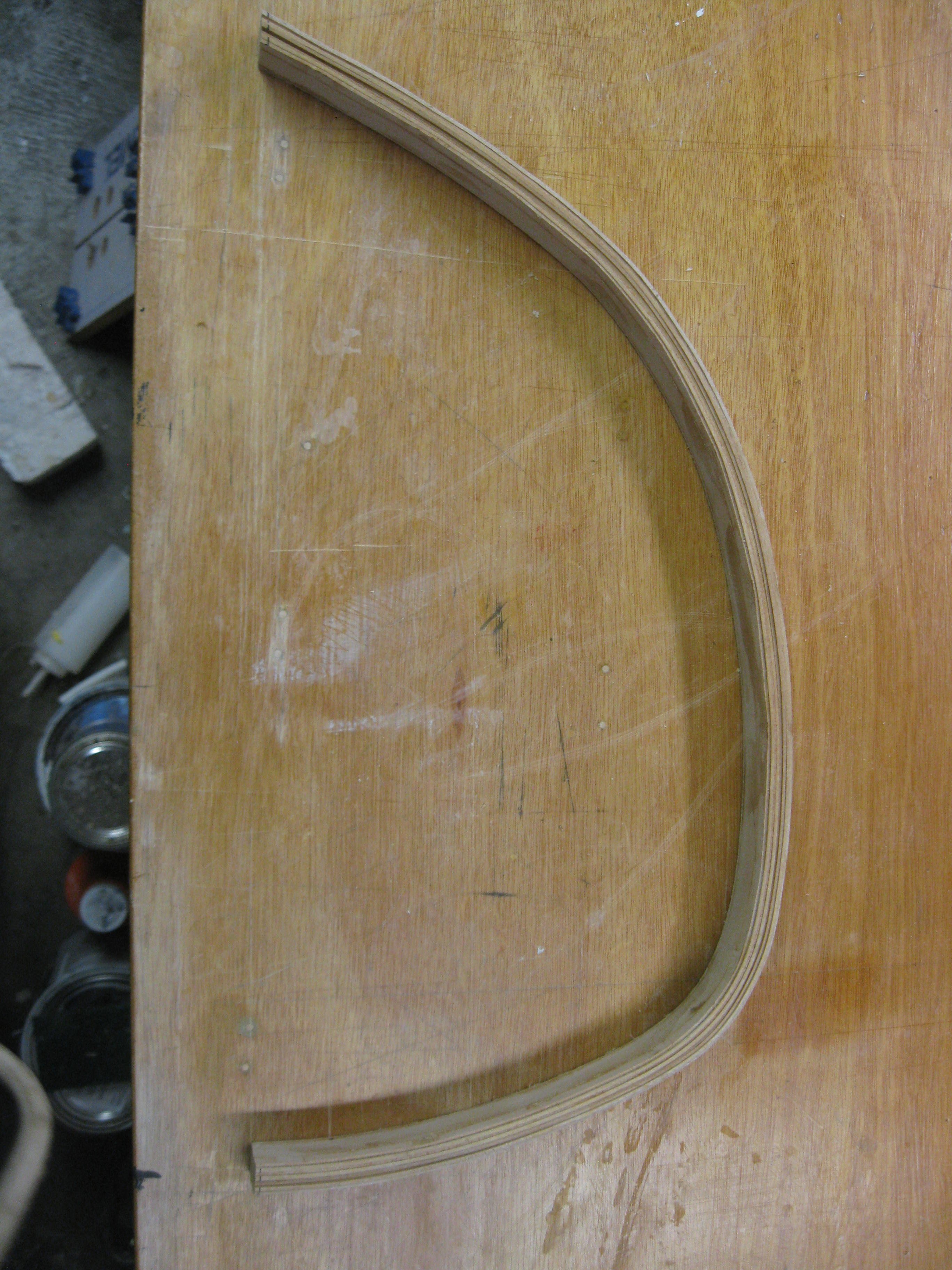

  2. IMG_2108.JPG For some reason the photo above is rotated 90 degrees? This one is the same view as my computer. Ready to come of the jig, the 1/32" plywood reinforcements still need glued to back side.

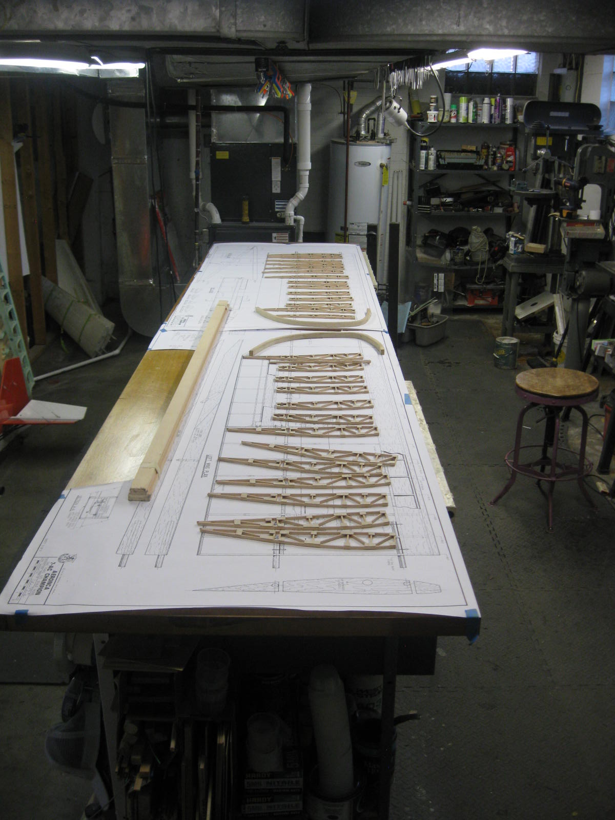

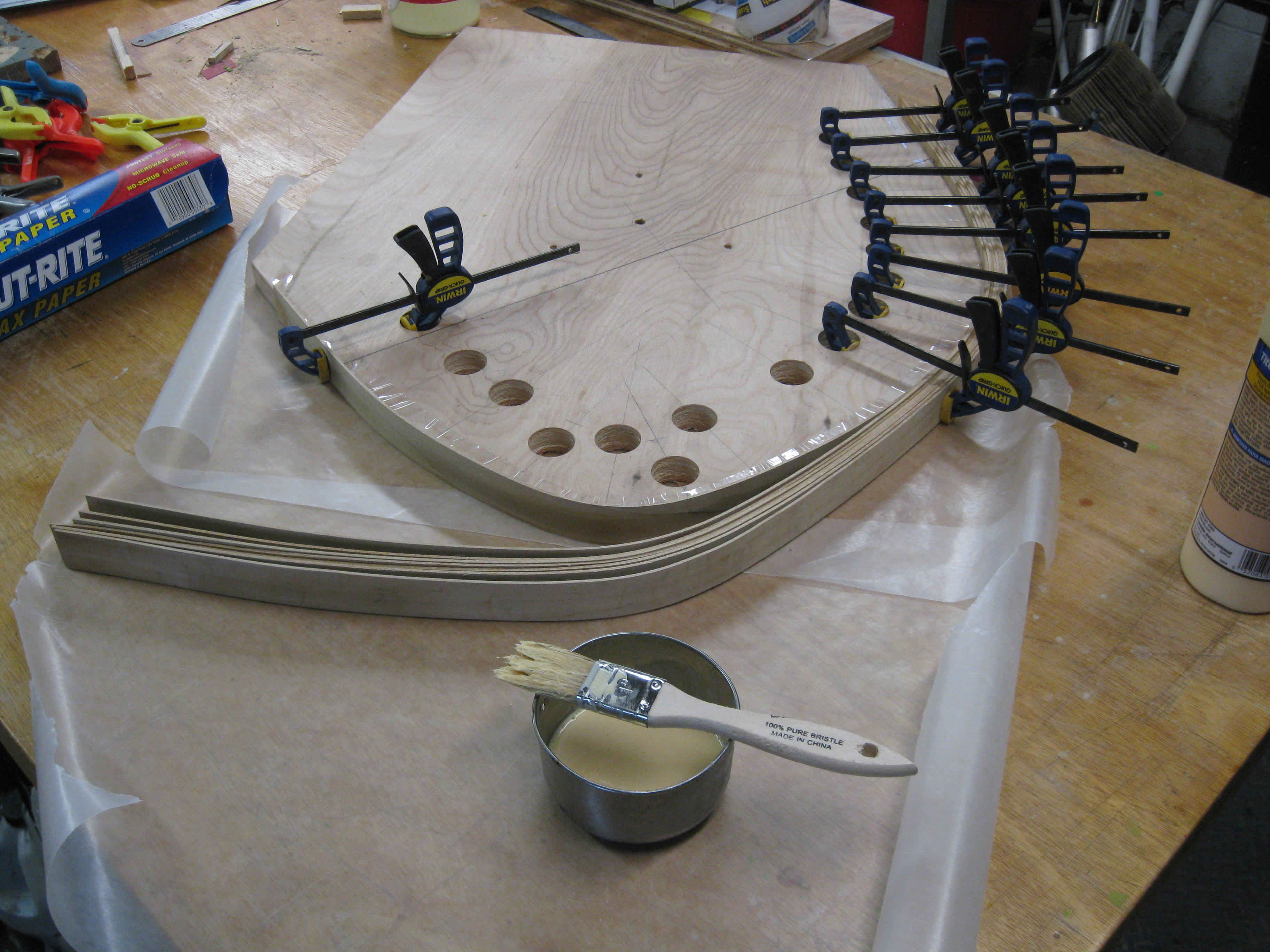

  3. The wing bow are laminated from 1/16" basswood, 8 layers. The buck is 3/4" plywood covered with package tape. IMG_2118.JPG IMG_2119.JPG

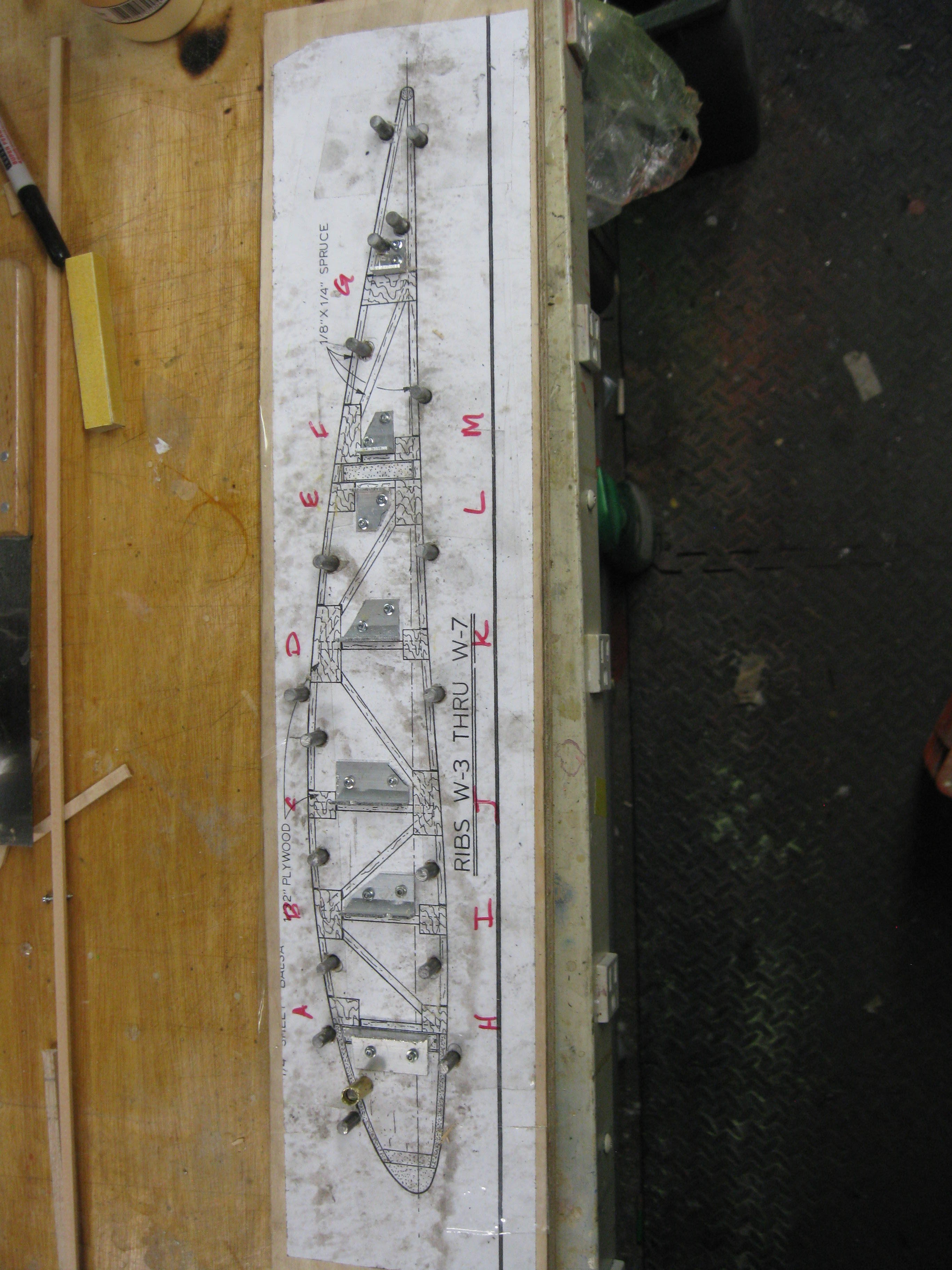

  4. IMG_2218.JPG I got the plans rolled out and ready start gluing the wings together. The spars are 5/16" x 6' that I ordered from Aircraft Spruce.
