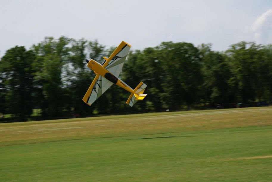

Thank you! It is really nice having my favorite Extreme Flight model for Real Flight. Both versions do big sky precision well, but I noticed something a little funny with slow-N-low flight characteristics. It's like there's a lot of drag on the plane and you can really feel it when doing slow-N-low 3D.
The following rework, uploaded to Knife Edge by Aurora, appears to have fixed all the slow speed handling niggles. It too requires that the original file be installed, so I'll include both for those installing this model in Real Flight for the first time:
Addendum: The reworked version is very realistic for both big sky precision and slow-N-low 3D. Feels very much like my real Extreme Flight 70" Extra 300.
