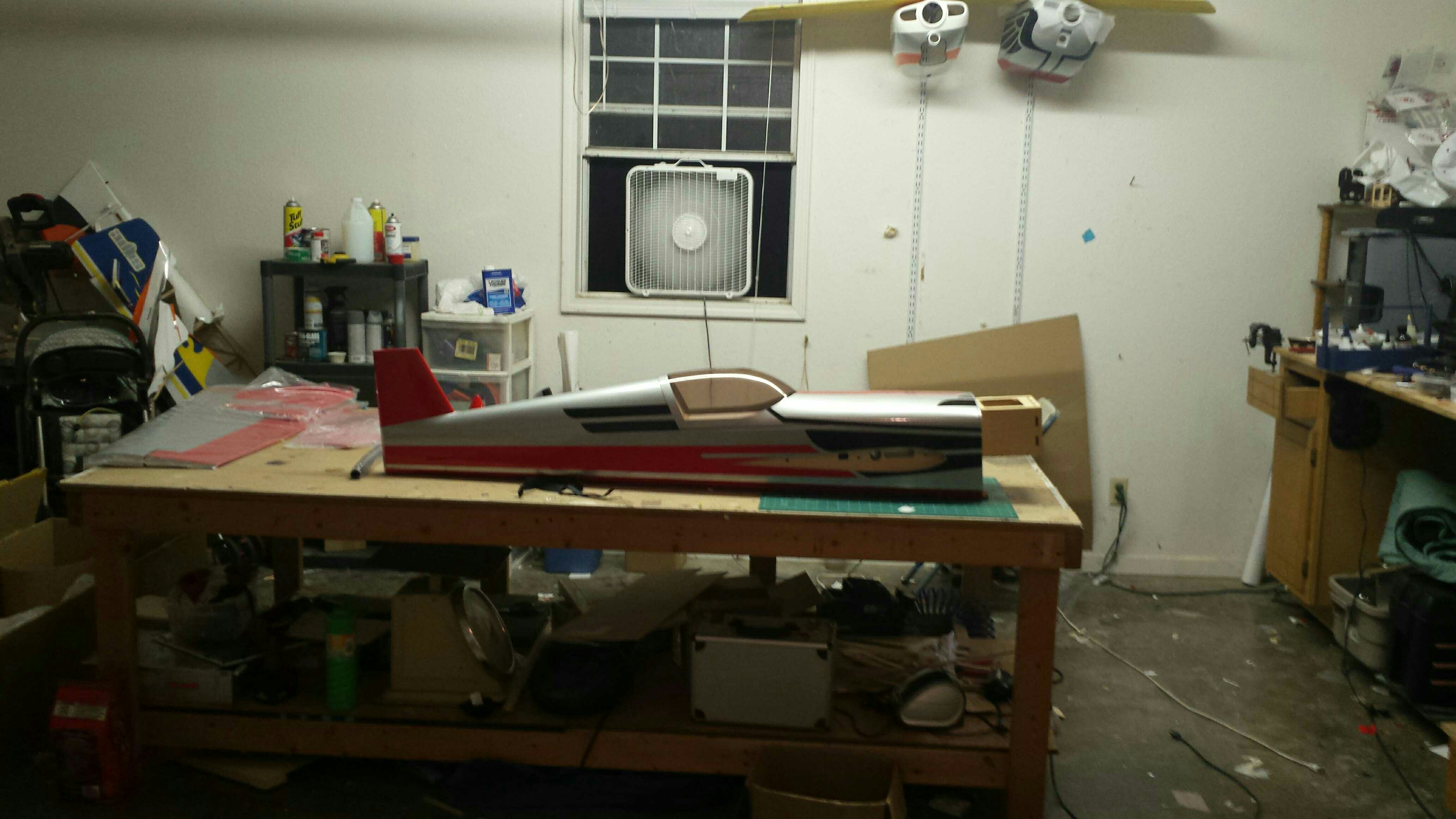

I don't have the plane with me at my hotel, however I used the stock arm, short servo arm on inner hole, and that worked fine for me. You can see the back of the firewall below:
http://www.3drcforums.com/showthrea...quot-Extra-330SC&p=67248&viewfull=1#post67248
I installed the throttle servo on the left of the motor box, with the arm vertical. Used about a 3" rod, small ball link on the throttle arm, adjustable crimp link (think 48" vyper style) on the throttle servo arm.
I also sanded off a little of the engine housing, about 2mm deep by 2mm wide, directly underneath the throttle arm. This allowed the linkage full movement.
One other thing I'd like to add: With my build and placement of equipment, the airplane came out dead neutral in flight: no climb/dive on 2/3rd power inverted up-line.
Batteries were placed on the sides of the fuel tray, just prior to the first former.
Wolverine switch placed as forward as possible. The Receiver was placed on a balsa tray, just behind the wing tube. Throttle servo placed at most practical forward location, about 1" back from forward firewall.
Bottom line: If you don't like a neutral setup (this plane flew great at neutral IMHO) then place your batteries further forward, such as strapped outside the motorbox, or add an ounce or two of nose weight.
