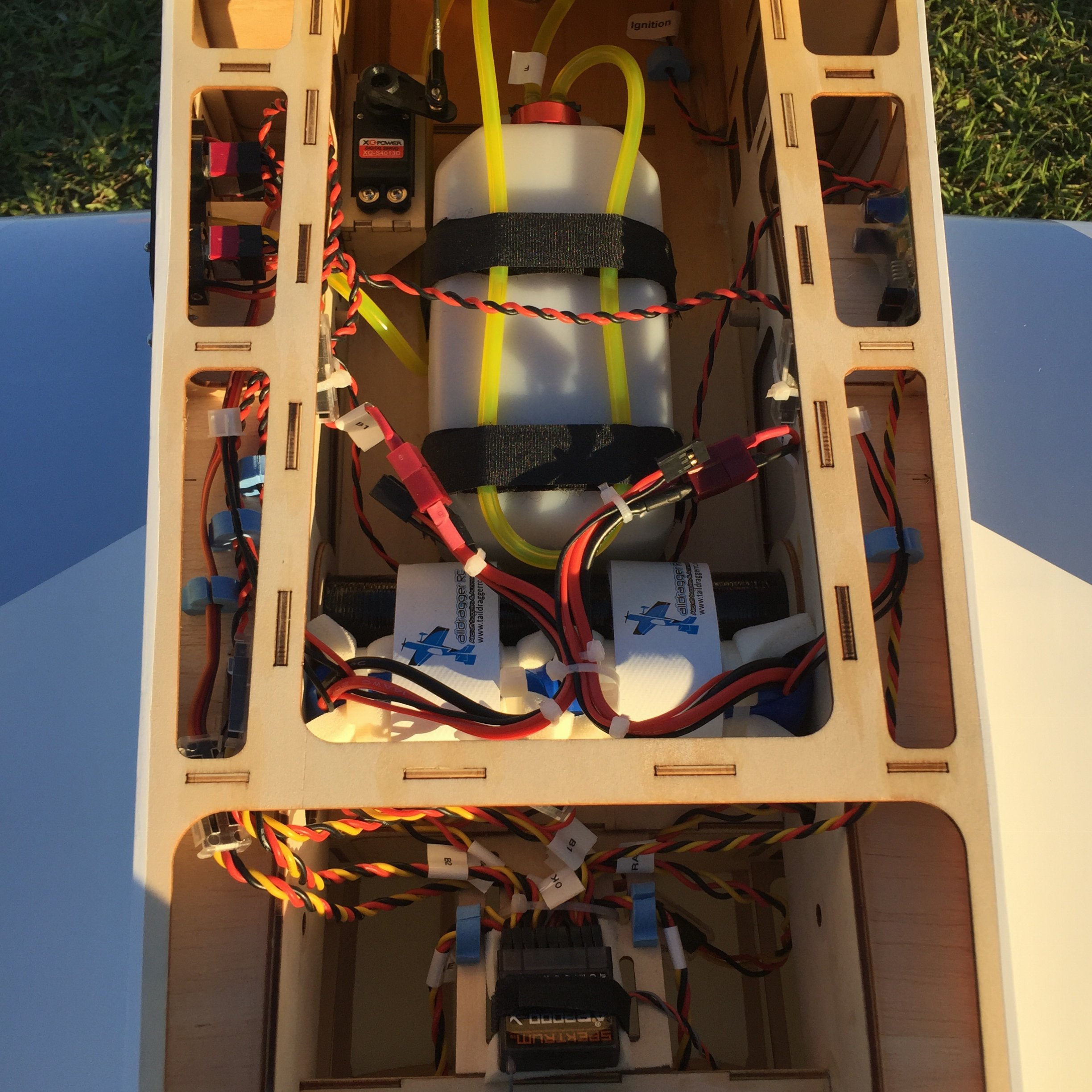

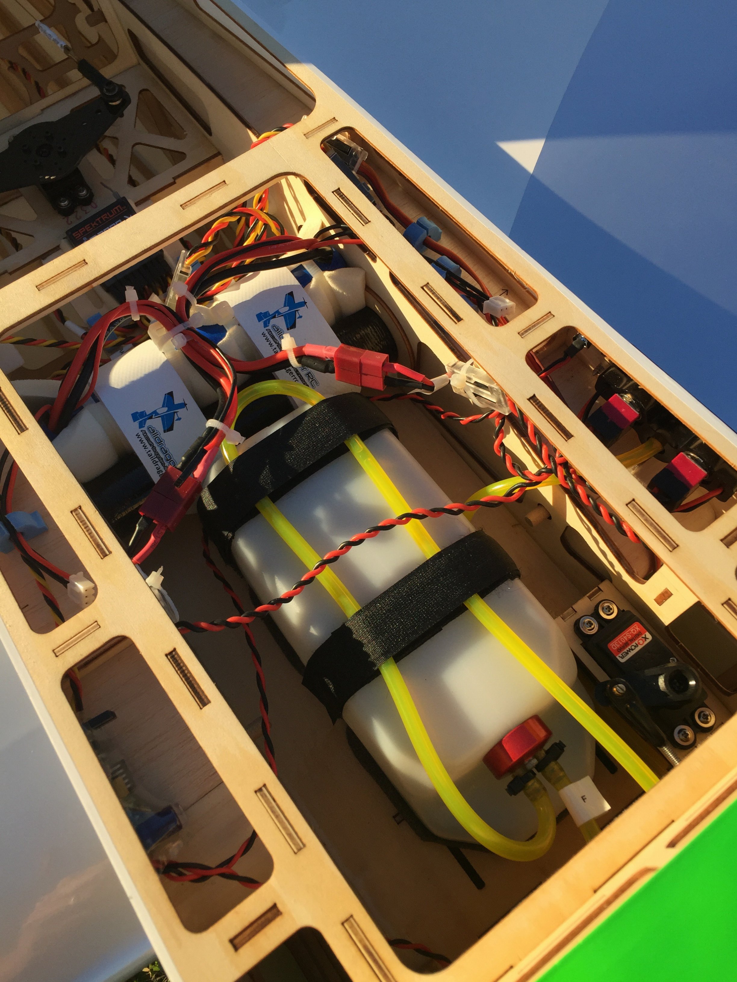

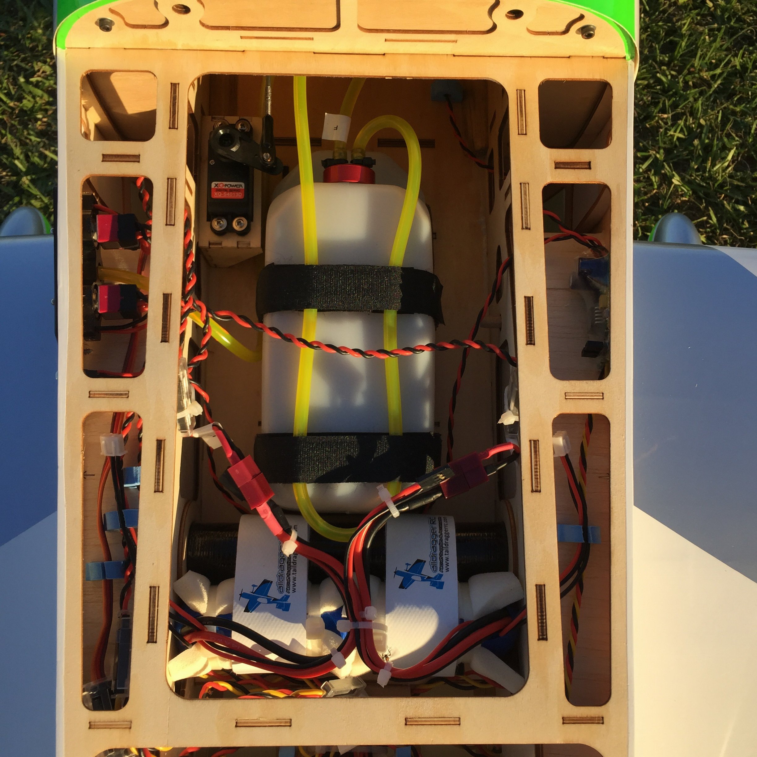

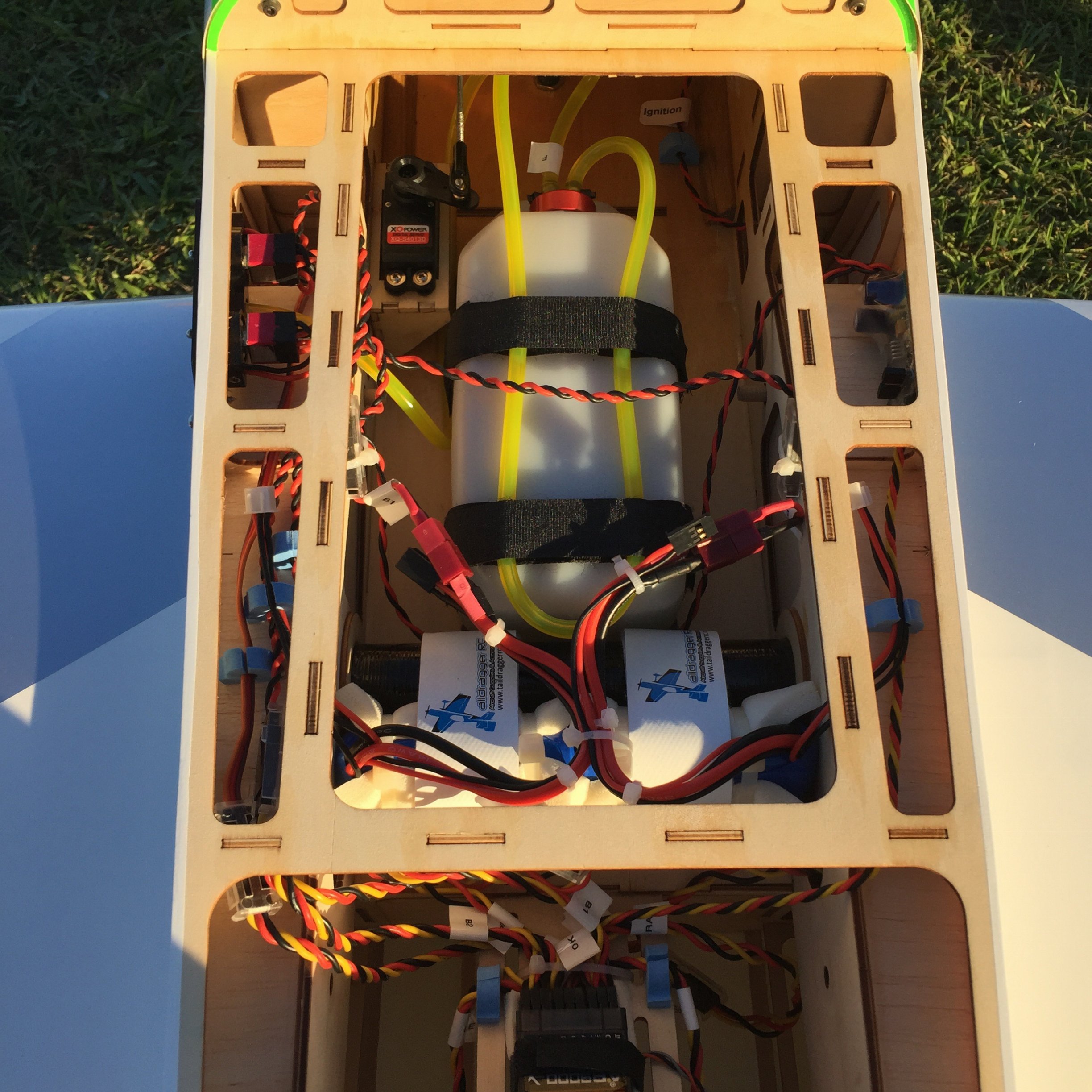

I have a friend who is having trouble getting it to balance at this location even with A123 batts on the firewall and a DLE-55
I have the same setup as your buddy and mounted 2) 2300 a123's behind the wing tube. Didn't have to change a thing. I'll post some pics to the thread.
