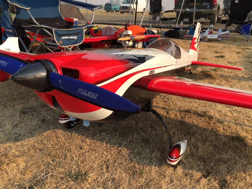

I also want to say THANKS to [MENTION=335]SupaTim[/MENTION] for bringing me a killer spinner and Falcon 23x9 cf prop from his new company NorthWestRC.com!

Hey [MENTION=2643]3DMIKE[/MENTION] are those wheel pants and gear cuffs plastic? If so are they pretty durable, or will they crack or break in taller grass fairly easily?

Hey bush... The pants are fiberglass and very durable. The cuffs are a very nice molded plastic that has the best fit I've seen yet. I'm running the savox 1268's all around at 7.4 but I am getting a lot of blow back at high speed (only on ailerons) which is my fault for putting the servo linkage at the farthest out in the arms. I will be pulling them in and expect much better performance!
