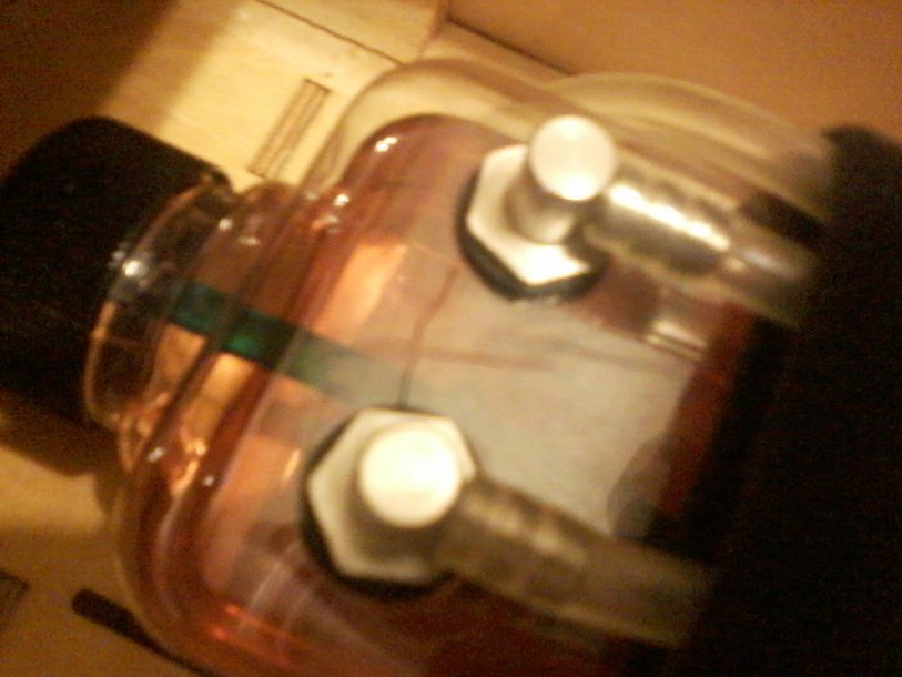

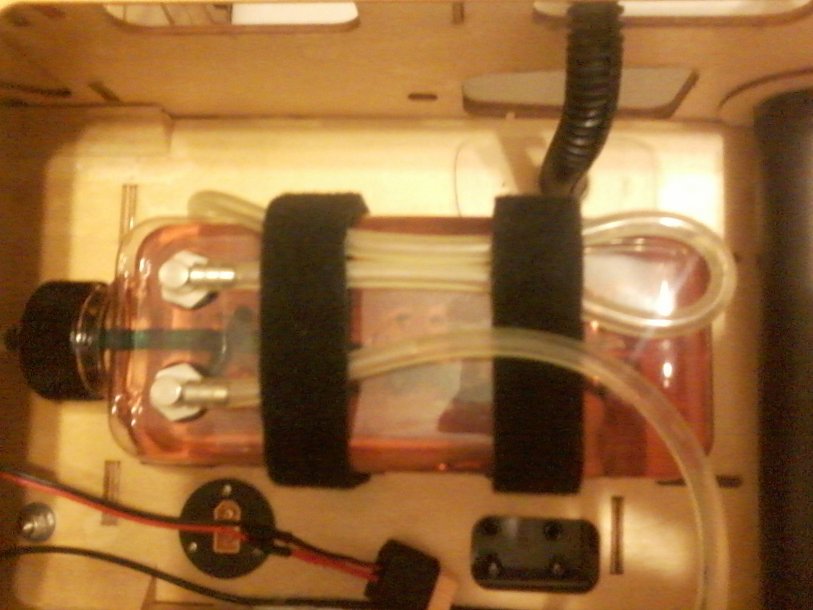

Speaking of tank leaks.... I pose a question to those that have been operating these water bottle style fuel tank / systems.
Any problems with the main cap keeping its seal nice and tight after the rigors of gas engine flight?
I find my self looking and checking for weeping at the neck of the bottle very often. Every thing seems fine but it's making me nervous thinking of a bunch of gas spilling in to my new bird. This is my "virgin" experience with these tanks. I have been a long time stopper tank operator.

No one ever has had a leak at the cap on these KUSA, SEACRAFT,PSP tank caps???
Kelly we been using them for sometime now, with no issues. I don't like the cheap colored fuel line, and have been replacing clunk line with tygon. I just installed one in my Sukhoi, an left the blue fuel line in, after adding the brass tube in middle. @emtp275 an I cut it short, because I knew it was gonna swell/grow, well it did. I get to pull it apart again, and redo clunk.
Thanks Donnie and @camss69 . As I had mentioned in my build thread the KUSA tank had a leak on the fill drain fitting itself.
I kept the "blue colored" tubing that came inside the tank and it seems that I need to replace it then. The yellow stuff you see in the pictures outside the tank is siliconized poly and I have been using it for 5 years now with no issues. I will re plumb the tank guts with that cuz I keep it on hand.

Never had any problems with leaking. Viton inside the tank, tygon outside.
