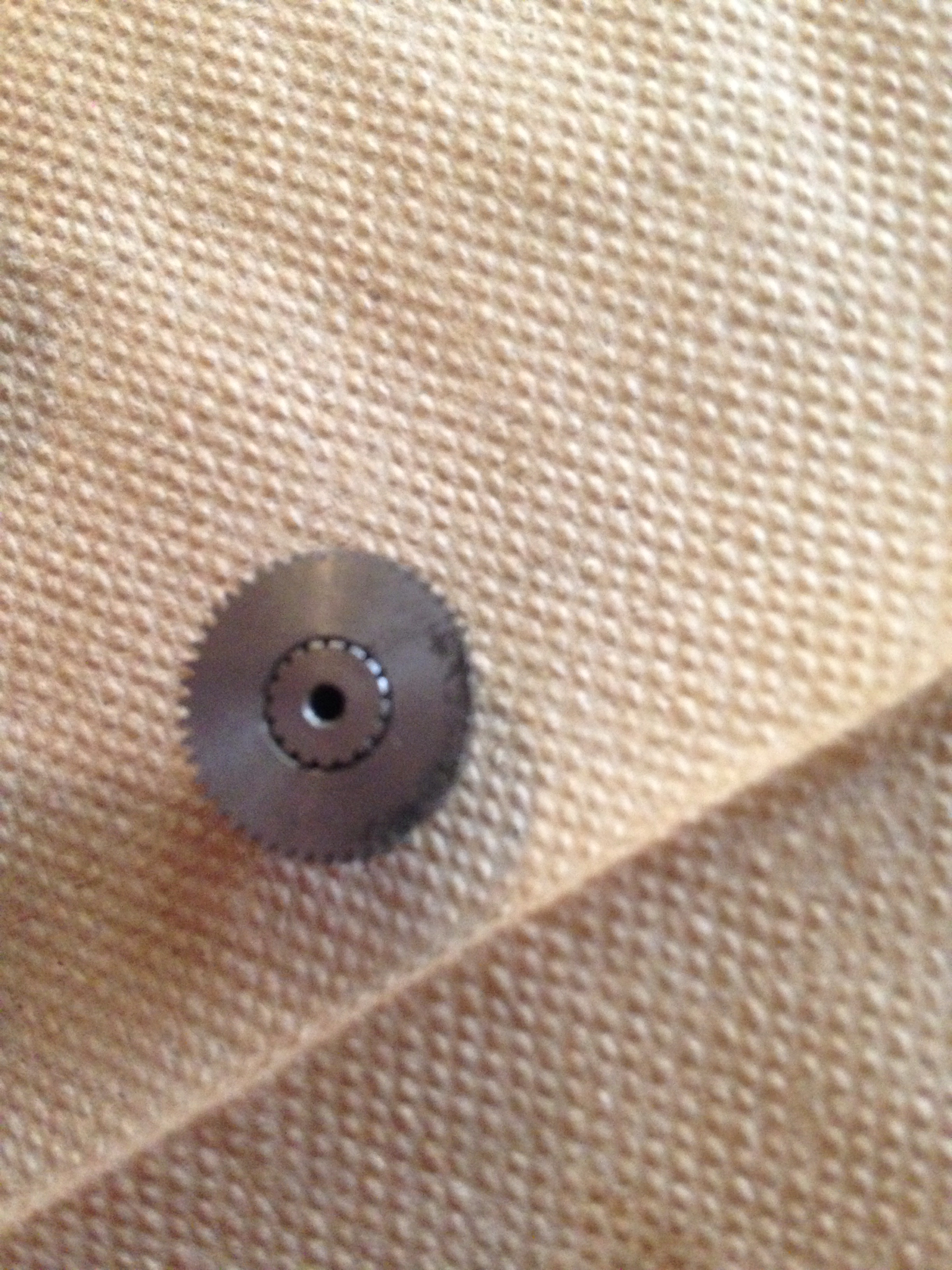

I'm at around 60 flights on the servos. I'm not as happy with these servos as I was previously.
Electronically, the servos perform great. Mechanically, not so much. I have had some issues with the center gear stripping and breaking. I've stripped two center gears, and actually broken one.
This is one of the ones that stripped.
The one that broke, separated where the two pieces meet at the center of the gear.

3 damaged servos gear sets. two stripped, one broken.
Half IMAC flights and half freestyle. Never really flew them all that hard.
I wish the gears were titanium. The 1270's in my edge have hundreds of flights with zero gear wear...
I've developed a little slop in all the 2231's. Nothing major, but a little bit. I think I'm going to swap out the gears before I put them in the PAU extra that I'm building in a couple days. I Might just sell and buy hitec brush-less, not sure yet.
