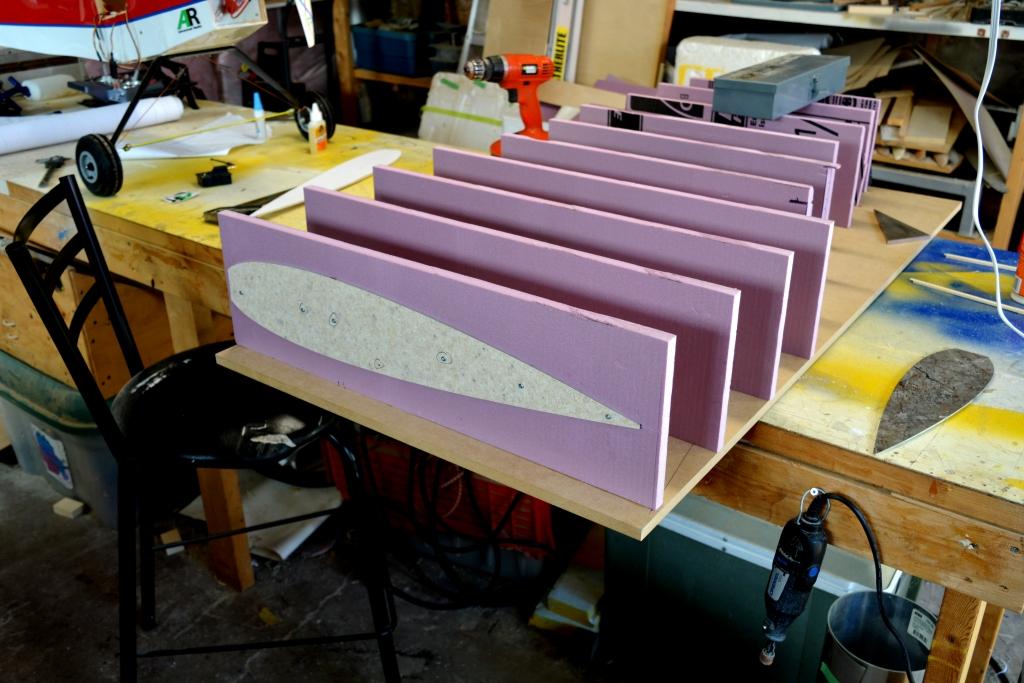

I have had trouble with aluminum templates in the past, raising the voltage will heat up the rest of the wire as well making the rest of the too hot. There were local cold spots where the wire touched the aluminum which crumbled the foam rather than cutting it. I believe you will be ok if the aluminum is not in contact with the foam, but I expect your templates will be touching the foam. I use Formica for my templates, doesn't melt, sands easy. smooth as silk when sanded with 400 grit. I personally like separate top and bottom templates, the wire is supported for both cuts which you need for foam ribbed wings. The single template works well for foam core wings as long as the blocks are square, then you can flip it over while cutting the bottom. Sorry for the long winded reply and I'm sure you already know this.View attachment 111211
You can write as much as you like because we can all learn new tricks, and although I have done this a lot, I will look for formica, not a bad idea, thanks for the tip

You know the old saying, " I have always done it this way" Well I vowed many years ago not to fall in this trap, so here you go with formica lol

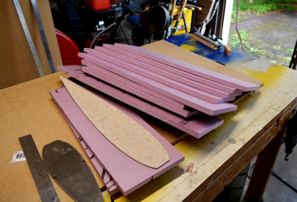

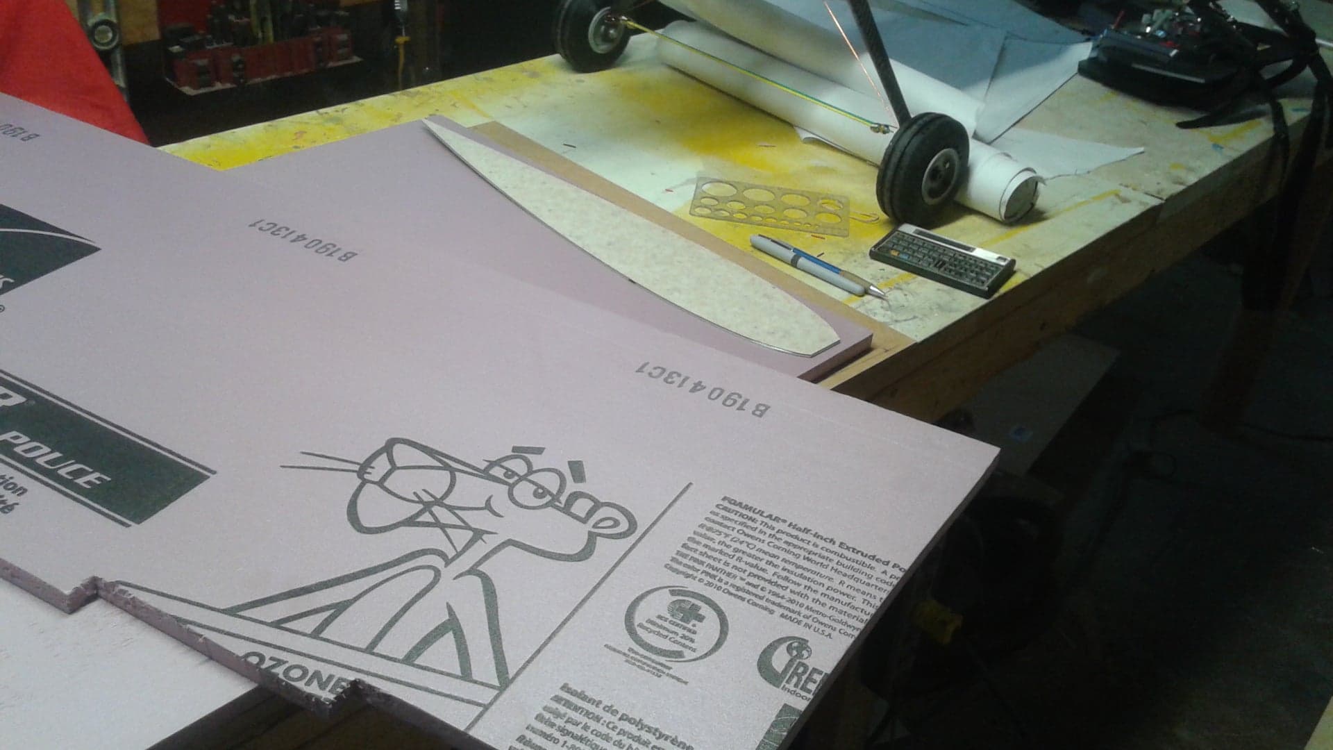

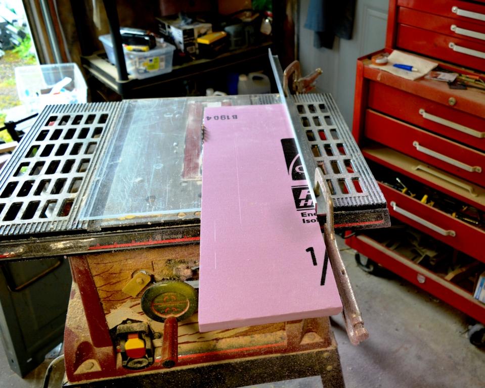

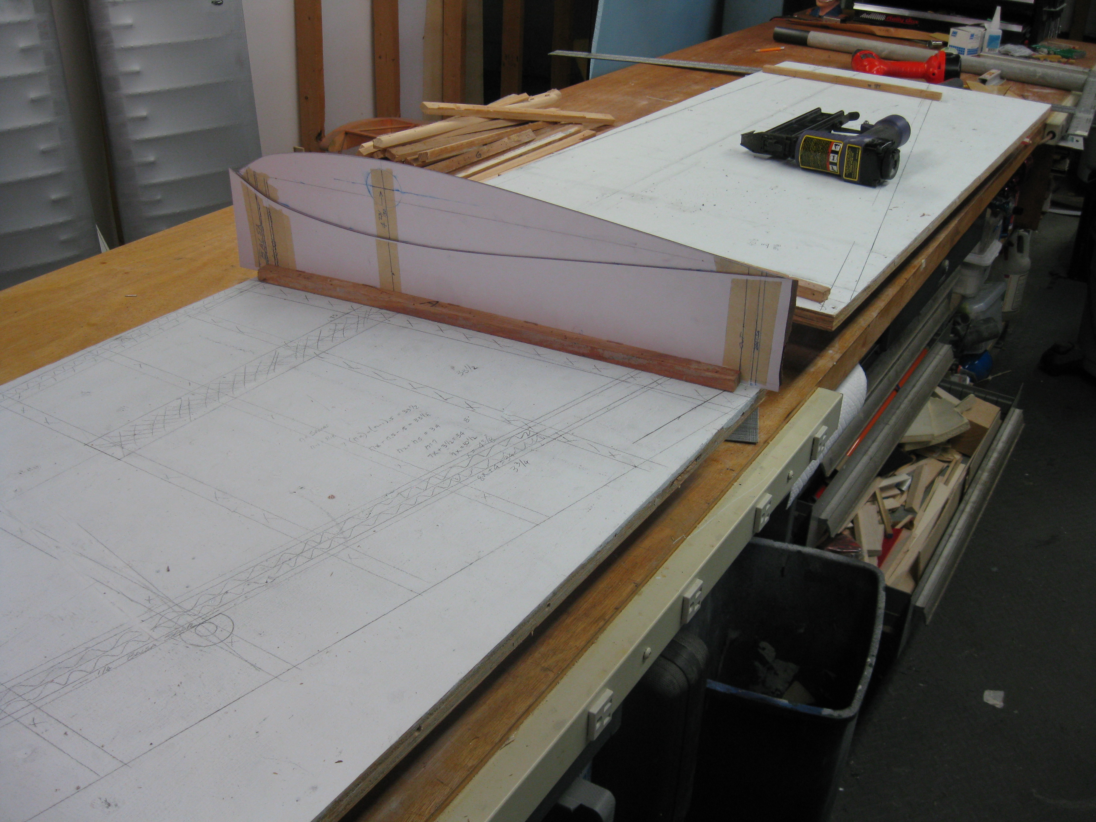

cutting the wing ribs takes only a few minutes, but to prepare everything to come to that stage takes a bit longer

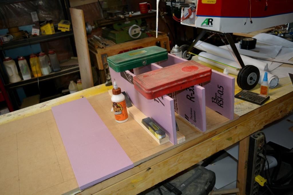

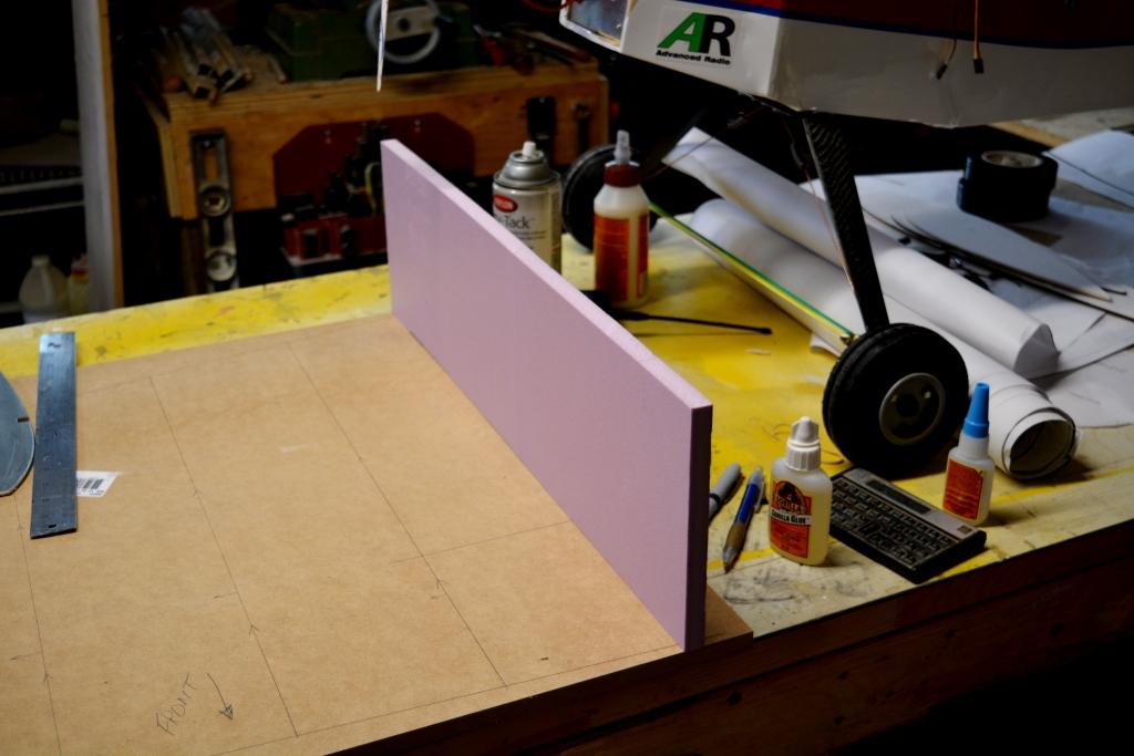

started to cut the rib blanks , once all glued in place, the mirror board will be glued on top to make a sandwich, then the precision comes, by placing the templates at the exact point where need , more photos will follow
