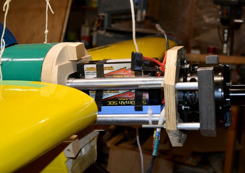

by putting the power batteries under the cowling as in the photo, I was able to remove the weights which are still in the photo but gone now, Not only balance , but less weight also,

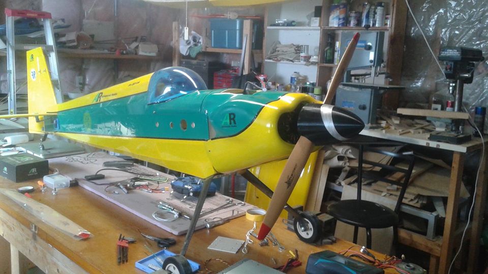

Hey Tony, not sure what you mean by pipes, since this is an electric motor. as for FrSky , ya I love them and the little blue one you see here is the X9 Lite , about $70, , 24 channels, open tx . it can do more then any radio on the planet including those super expensive Core, and even the new Futaba 32.
Testing everything for fit, working properly, like voltage sensors installed and working perfectly in the motor battery compartment, running the motor with this 27*10 propeller but only to about 2500 rpm to check for any vibration so far none, and perfectly balanced and true, as well as the 3D printed spinner, with no issues whatsoever,
The laser is in the trailer waiting for the new esc, and it is ready for maiden flight once the weather is correct.

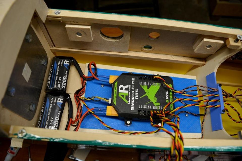

The Dalotel is being readied by changing the flight servos to the upgraded BlueBird H51B , also the flight/power controller will be changed to the AR SmoothFlight and should also see its maiden flight in early summer , and hope to have good videos of both.
