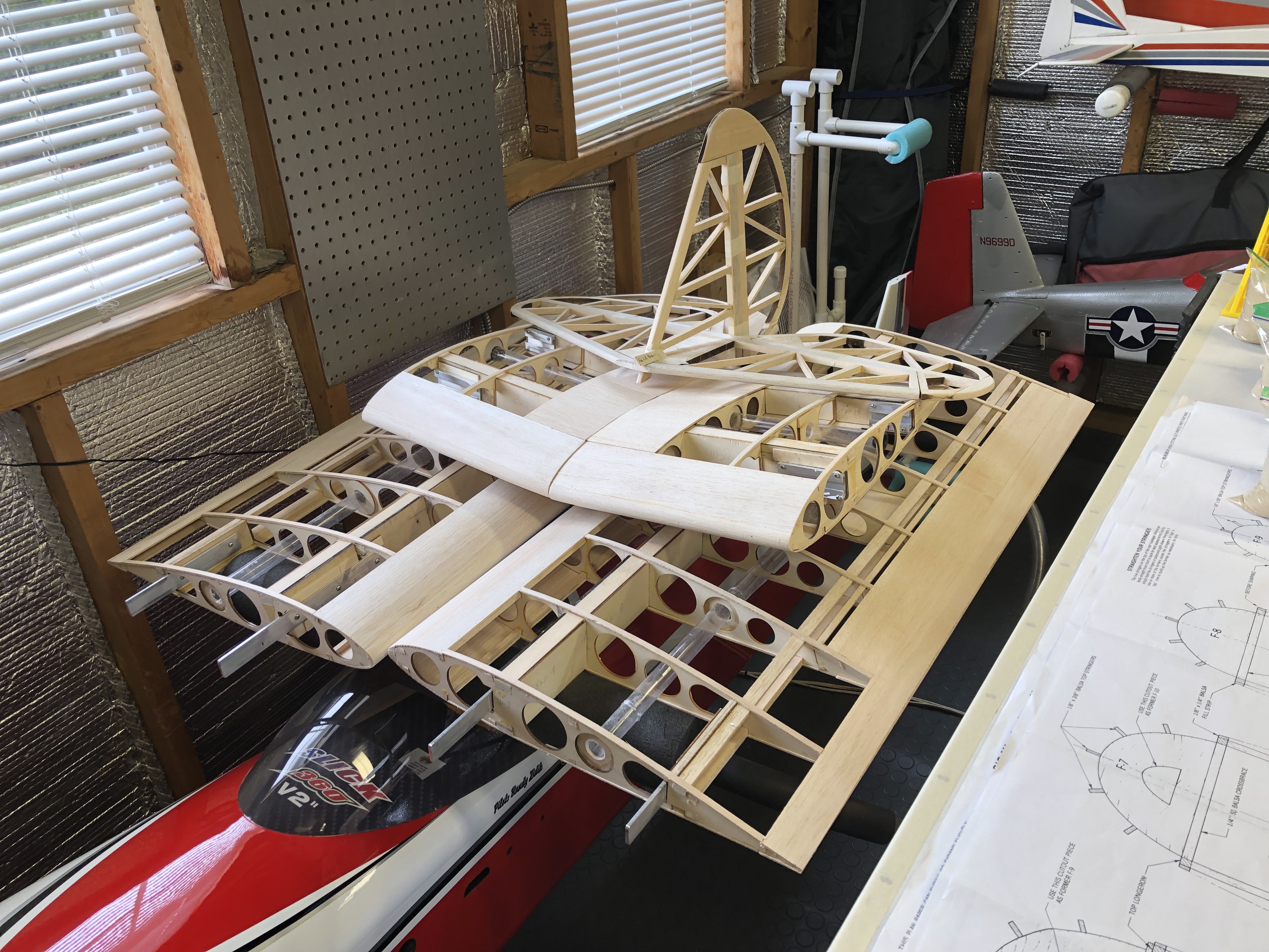

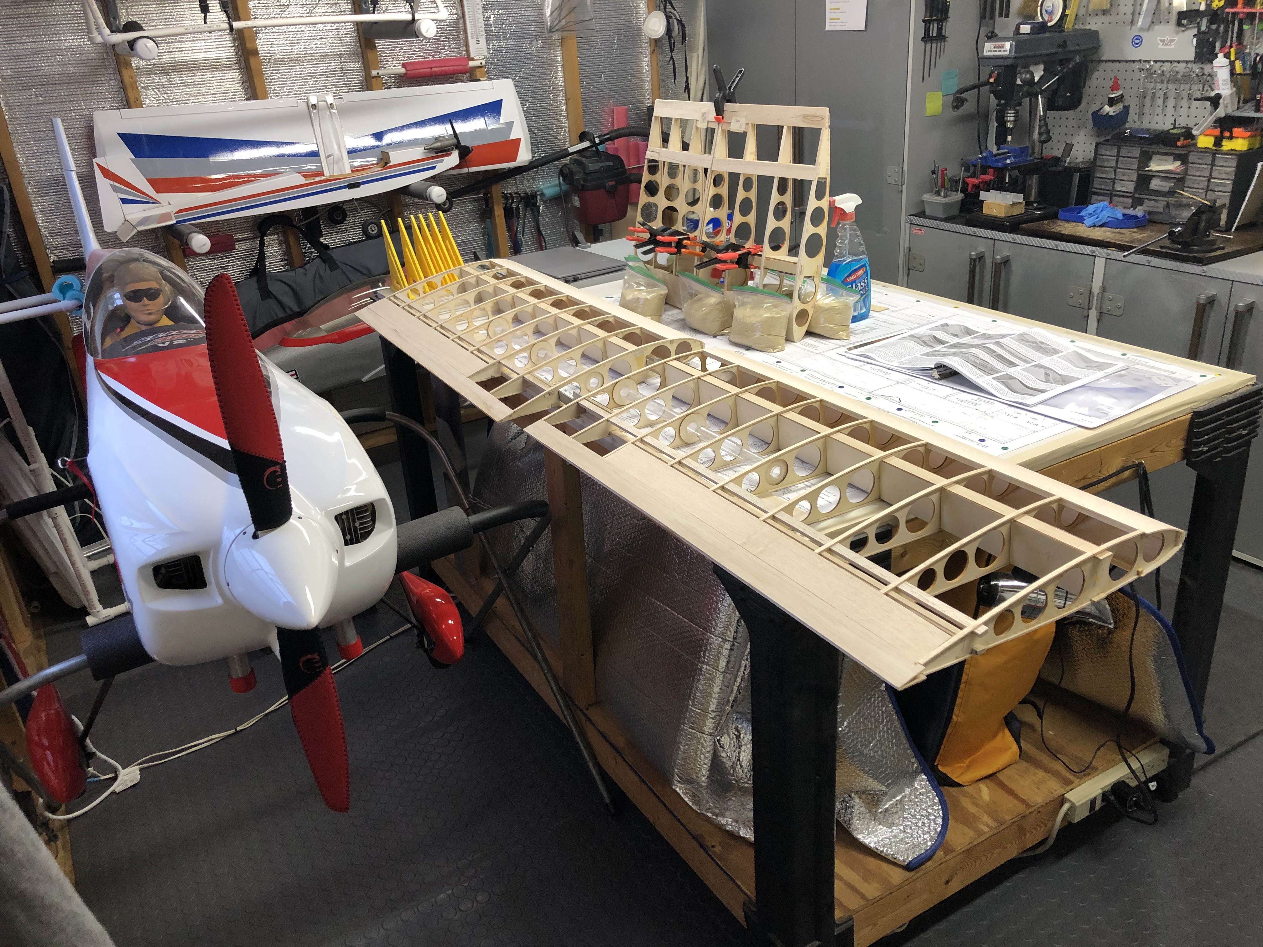

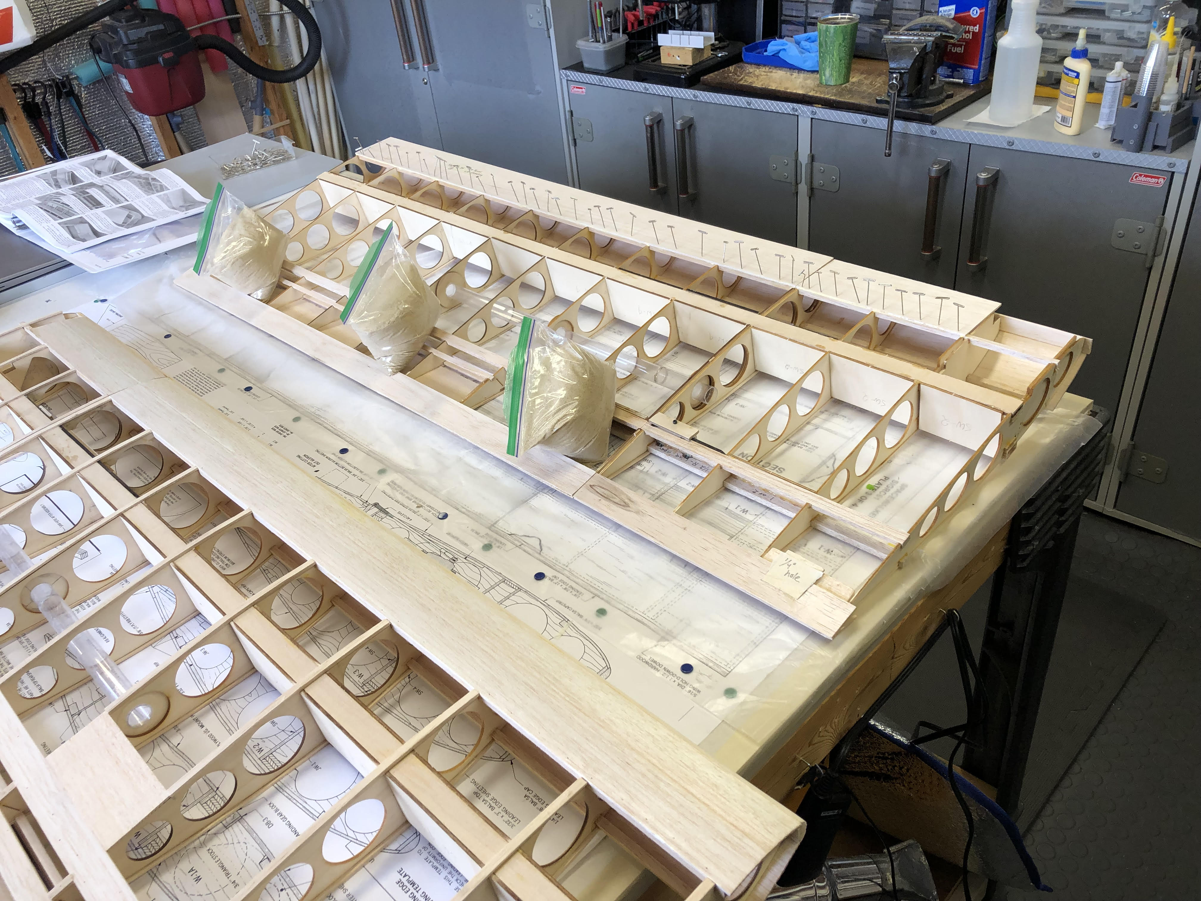

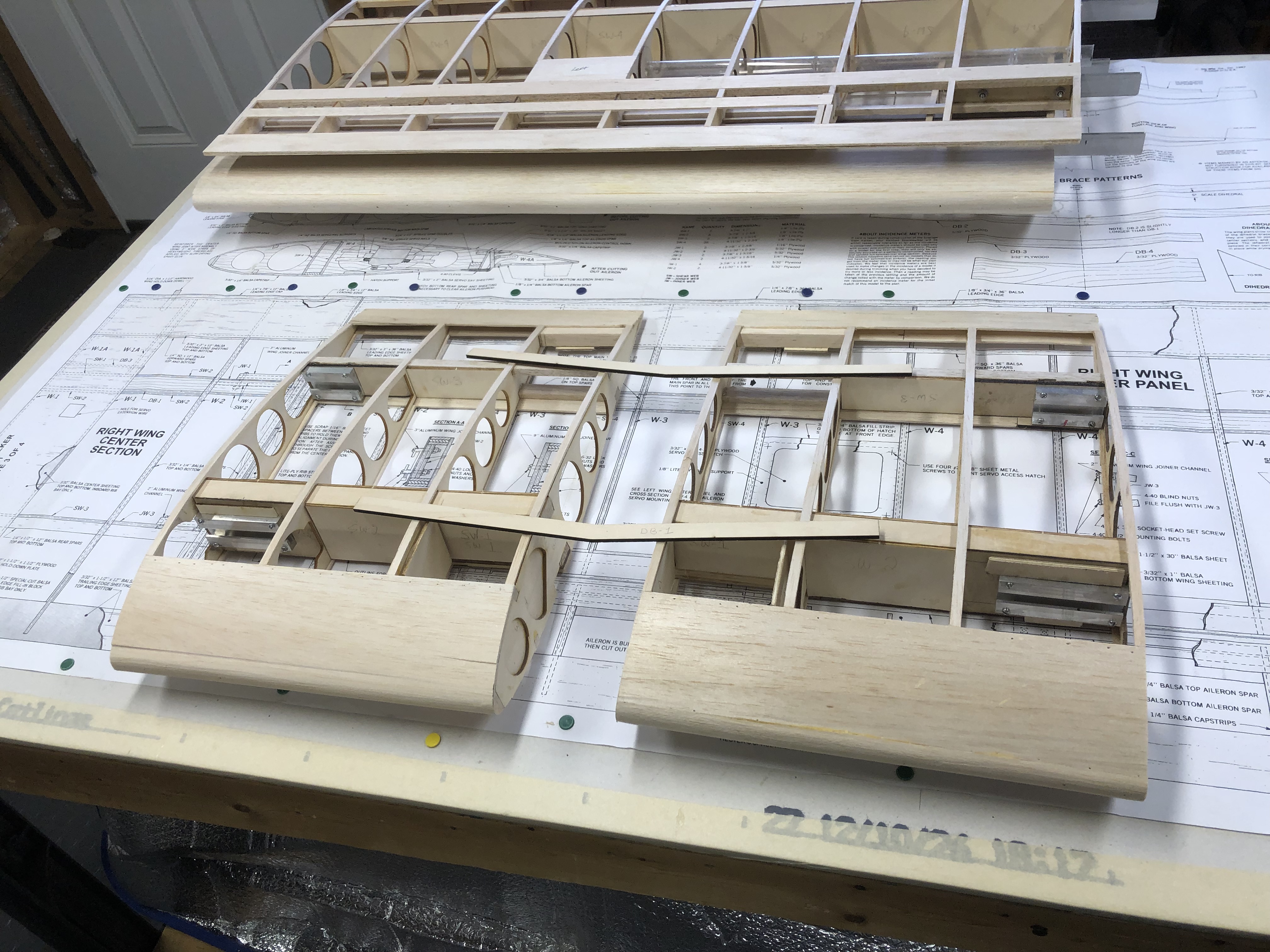

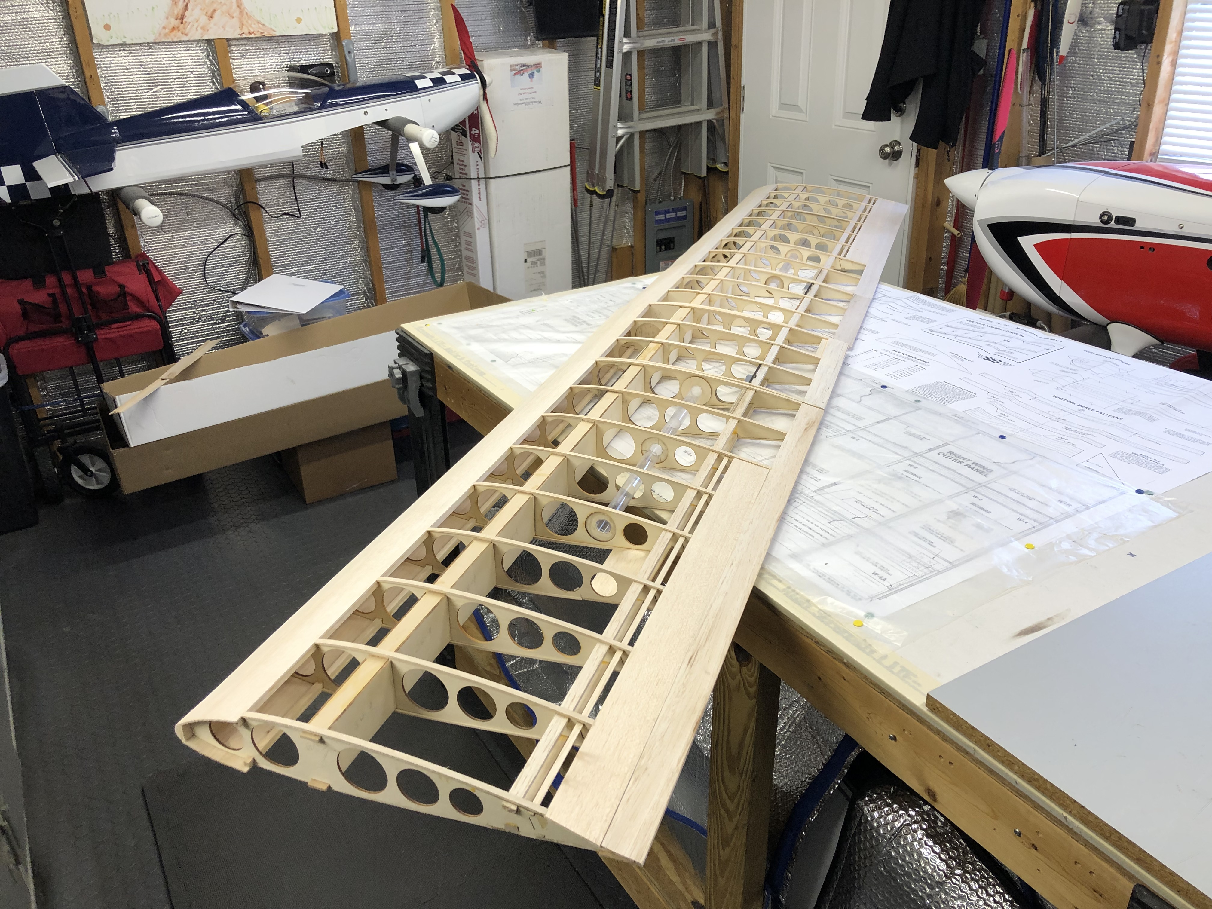

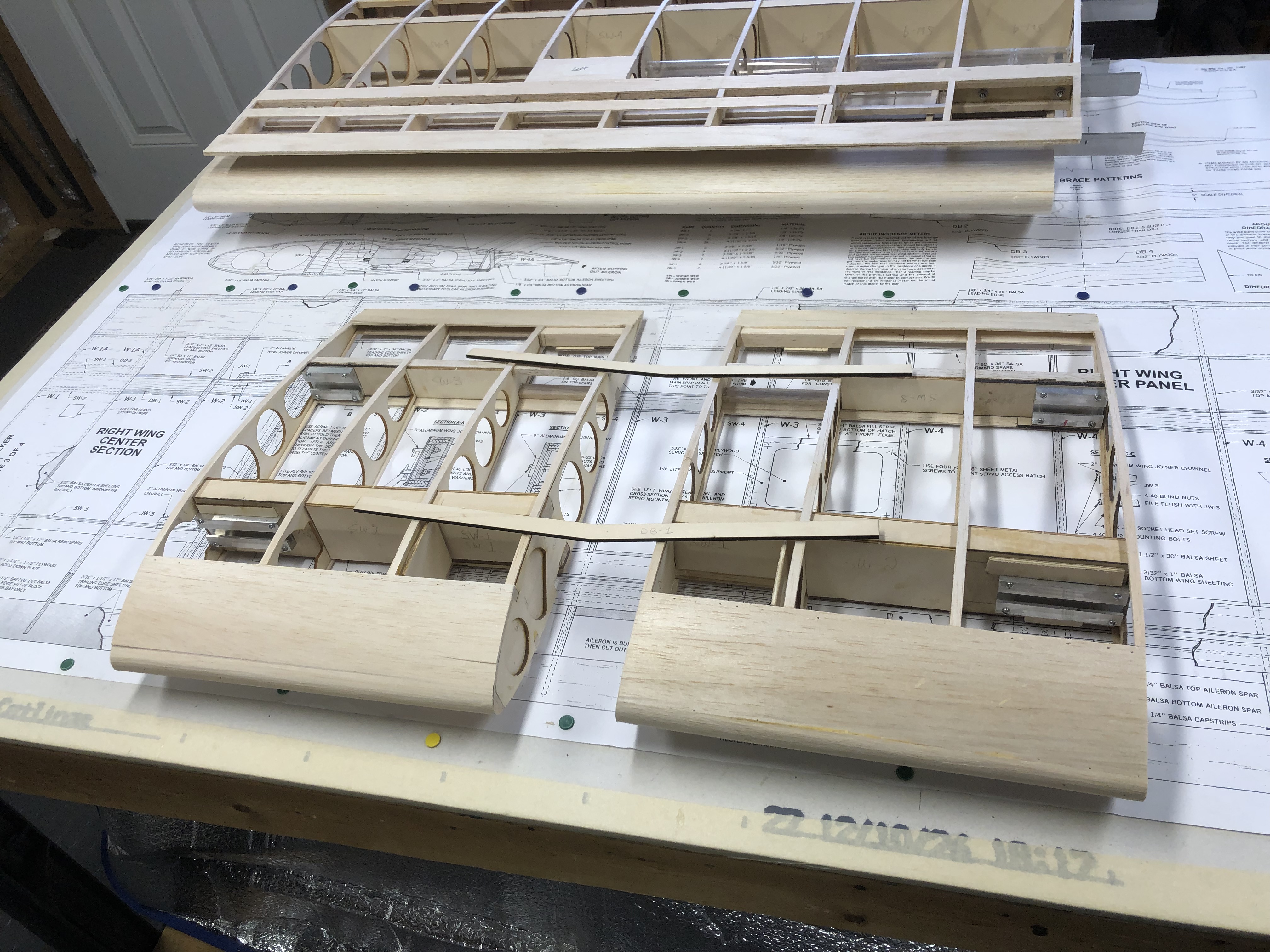

Randy, is the center section sheeted and glassed as well? I was expecting to see a full depth brace. Looking real nice. I love looking at all the lightening in straight alignment.
Tony, although the plans and instructions don't call for the center section to be sheeted and glassed I know some builders have chosen to do so. I will decide after I follow the instructions and then evaluate how strong this sections appears to be.
