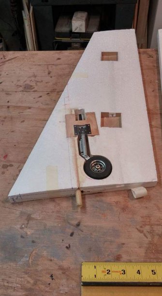

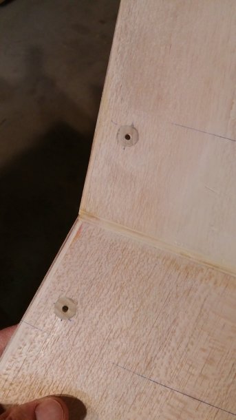

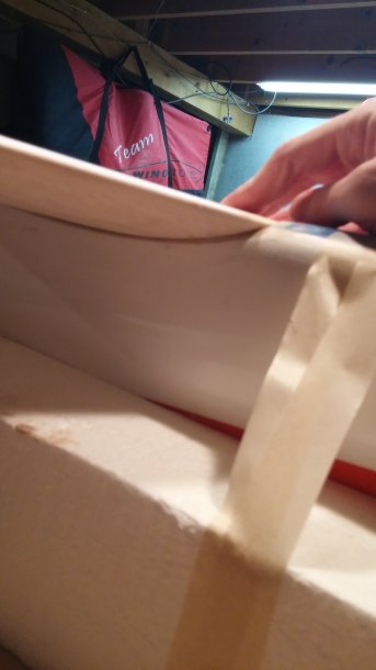

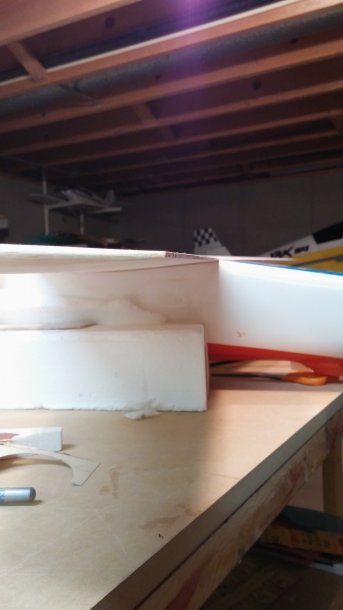

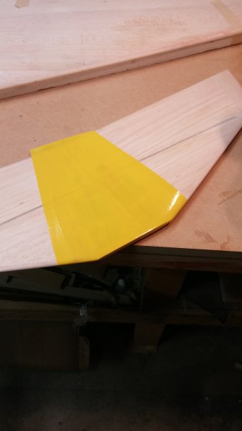

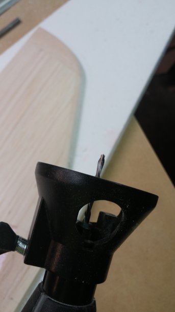

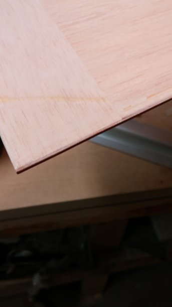

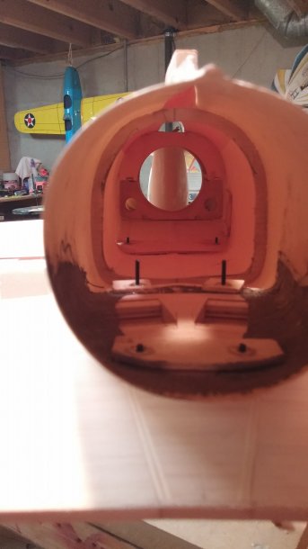

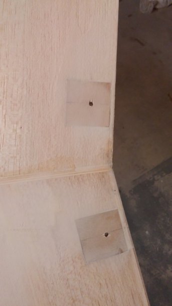

A little progress has been made. My wings didn't fit the fuse as nice as I would have liked. But after checking the factory neither did theirs. I covered the center section of the wing with some ultracoat. Waxed it and brushed on some pva release. So I mixed up some West systems epoxy and some filler and made a fillet. Now there is a perfect fit between the wings and fuse. I also Drilled some 1/2" holes for mounting the wing. Once the dowels had dried I sanded them smooth and on the bottom side of the wing I recessed in some 1/16" plywood. This will help prevent the dowel from being pulled out. I will eventually glass the center section with 4 oz glass. Probably overkill but I don't want to loose or fold a wing. The last thing I like to do on all my builds is add a piece of 1/64 or 1/32 plywood on my trailing edges. The first time you hit it on the door, trailer, the steps you will thank yourself. 20160323_204145.jpg 20160323_204344.jpg 20160323_204411.jpg 20160323_205031.jpg 20160323_205846.jpg 20160323_204520.jpg

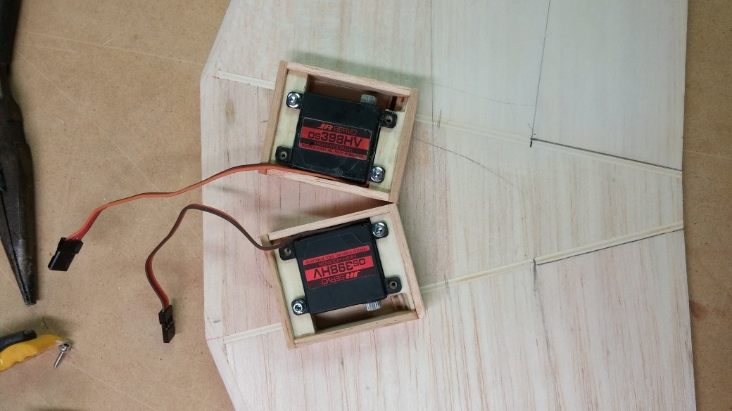

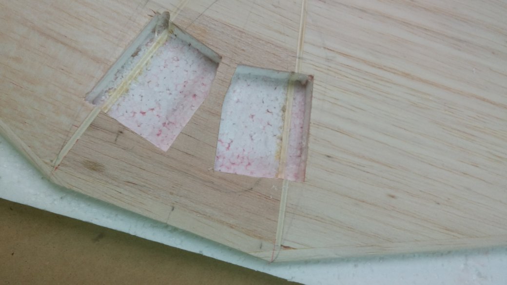

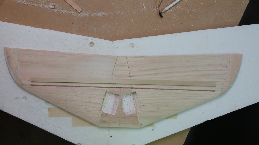

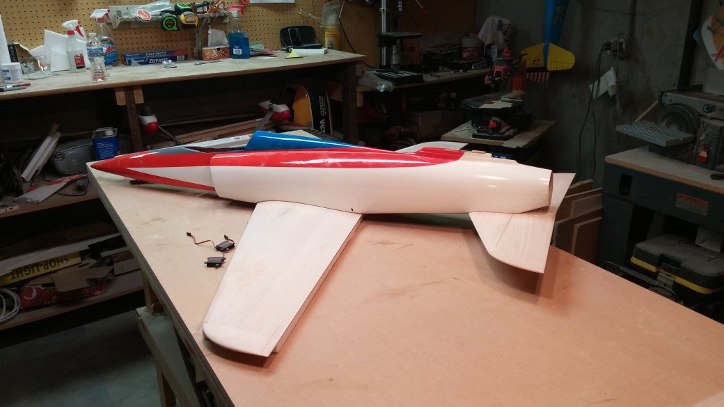

The wings are mounted so I'm turned my attention to the Stabs. Servos are mounted and main spar glued in.

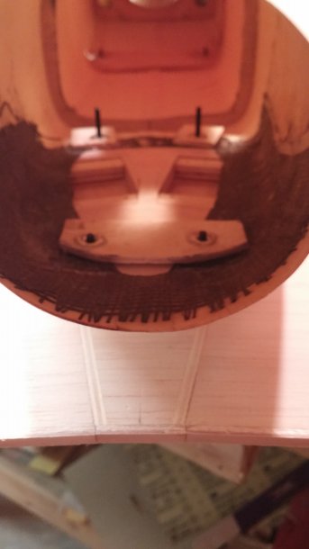

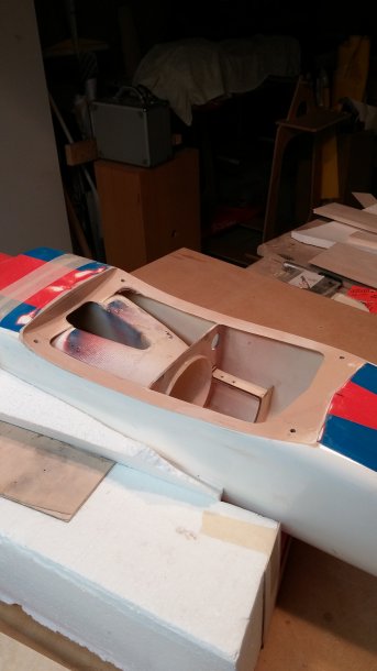

I was able to get the stab mounted. I had to stiffen up the back end and luckily my dad had the dirty work done for me before he gave me the jet. He made up and glued in a 1/8" aircraft grade plywood former. He also laid in some carbon fiber on the inside of the fuse.

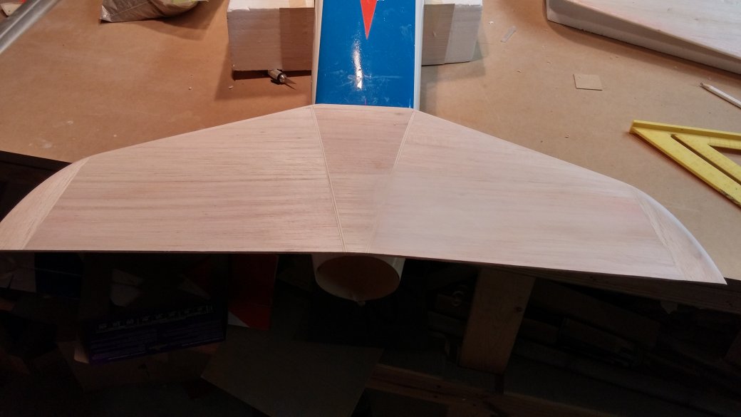

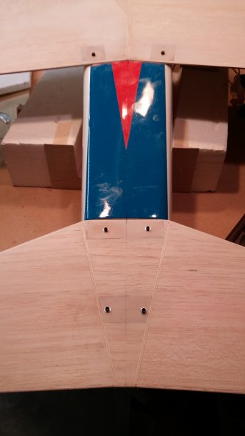

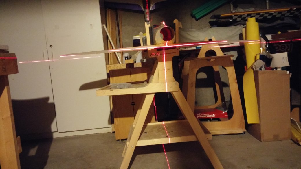

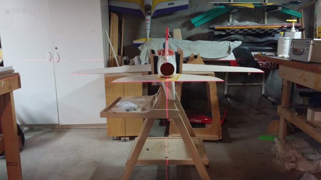

I had some issues with the stab. I was square to the wings but they weren't level and I had a full degree of negative incidence. I broke out the laser level and went to work. I kept on adding 4-40 washers until everything was where it needed to be. I followed the same protocol as the wing. I covered the stab with Ultracoat, waxed it and brushed on some pva molded release. Using West systems epoxy and some filler made a fillet to fill the gaps and have a perfect fit. I came back at it today and glued the vertical stab on using the laser. Everything is perfectly true and this one should fly straight.
