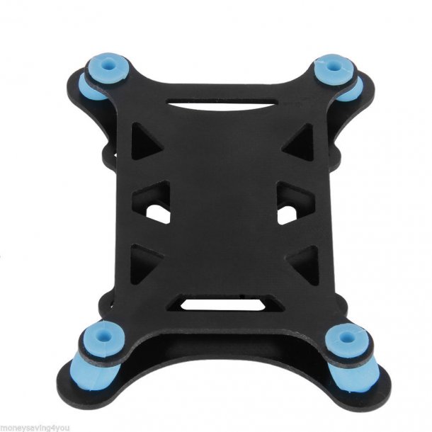

The next issue for us is to find an easy way to mount the tag on aircraft that doesn't trip the scene marker feature. I'm working on an elastic strap and a bit of foam rubber under the tag to isolate it some from the engine vibrations on big gassers. Last week I tried a bunch of foam under the tag and I think that allowed too much p and down and actually tripped the scene marker more. This weekend a thinner piece of rubber to soak up some vibration without allowing the tag to bounce, hopefully.
Try a flight control mount from a quad. I bet this would rock!
http://www.ebay.com/itm/like/161667363013?lpid=82&chn=ps
I need to come up with a mounting system that can be moved from plane to plane without having to modify the planes. That all hinges on this thing actually working though. If it gets to where it will track general airplanes reliably we can look at coming up with mounts for the tag.
Those mounts are $5, get a few of them and use that super velcro (the clear stuff with the stick and ball instead of loops) probably cost ya $30 for a pile of planes!
I am working with some elastic hook and loop material. I want to figure out a way to mount the tag without sticking anything to the covering or paint as that always seems to pull up what it sticks to if it is strong enough to keep the tag in place. Plus the tag holder is tough to hold with anything other than a strap. I hope that eventually SoloShot comes up with more mounting options that might be easier to adapt to more vehicles.
