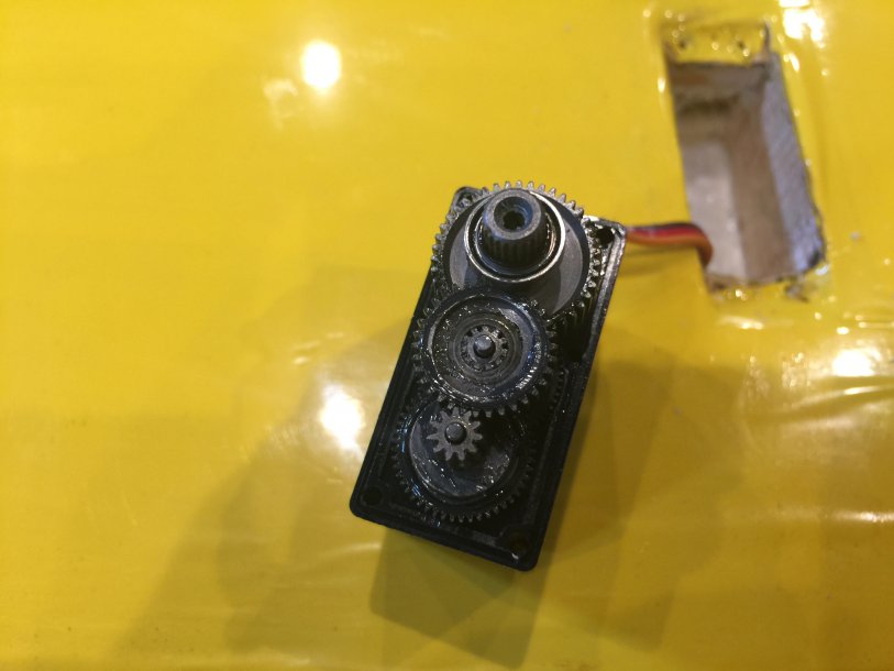

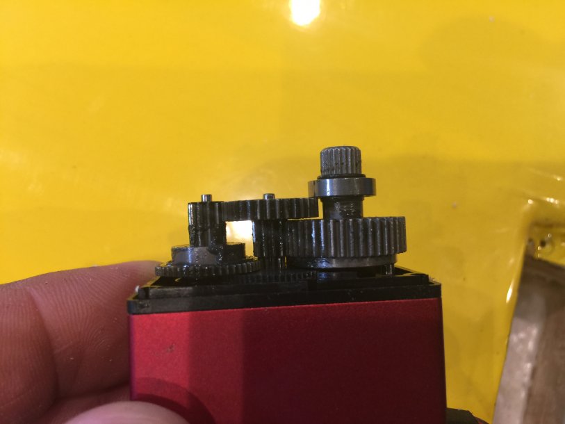

I posted this question in February, and after 200 flights and over 40 hours of flight time, I determined the source. It was not the ball links, and it was not the hinge points. It was one single servo on the right wing. It would squeak anytime i did a 2 point roll or a 2 of 4. I could hear the squeak from 400 yards away!!! LOL!!! It actually sounded cool.
But, all kidding aside, the squeaking came from a JR MP 82T servo, and not from the gears. I opened up the servo, and there was no wear, no slop, no bearing problems. The actual problem is the core less motor. When i spin it, it makes the squeak sound.

i will post pictures soon of the servo inside.
Here are the pics:
