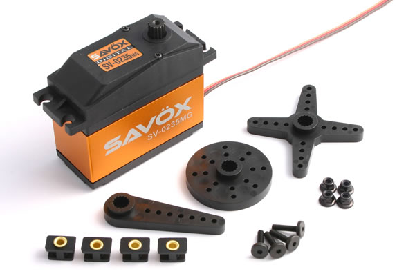

I found a perfect screw for the wing tips on the 3DHS 92" EDGE. The screws that come with SAVOX servos have a huge head on them fit perfect in the wing tip holes. The only negative is that they are metal screws that can be victim to vibration where the nylon seam to deform a bit and hold. Not sure if i forgot to tighten or vibration got one but my left wing tip twisted up so I landed. The SAVOX screw was still in the tip!! I like how they maximize the contact area.
I will let you guys know how they work in long term...

I've used them before on a SFG that I didn't remove... Worked perfect with some loctite.
To help keep them on, a small neoprene washer might work to stop them from vibrating loose.
