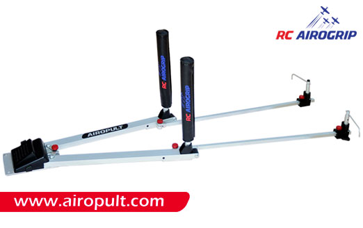

I use one of these for ground testing in my garden. Very helpful and stops the plane going forward OR back. Can comfortably restraint my DA120 at full bore and on paper can restraint 60Kg of thrust so suitable for much bigger. A nicely designed bit of kit.

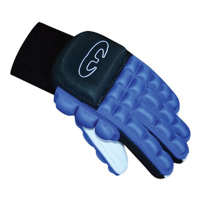

For starting, I wear one of these. Field hockey glove - very well padded in right places - but best of all, available to purchase single as you only wear one while playing :)
