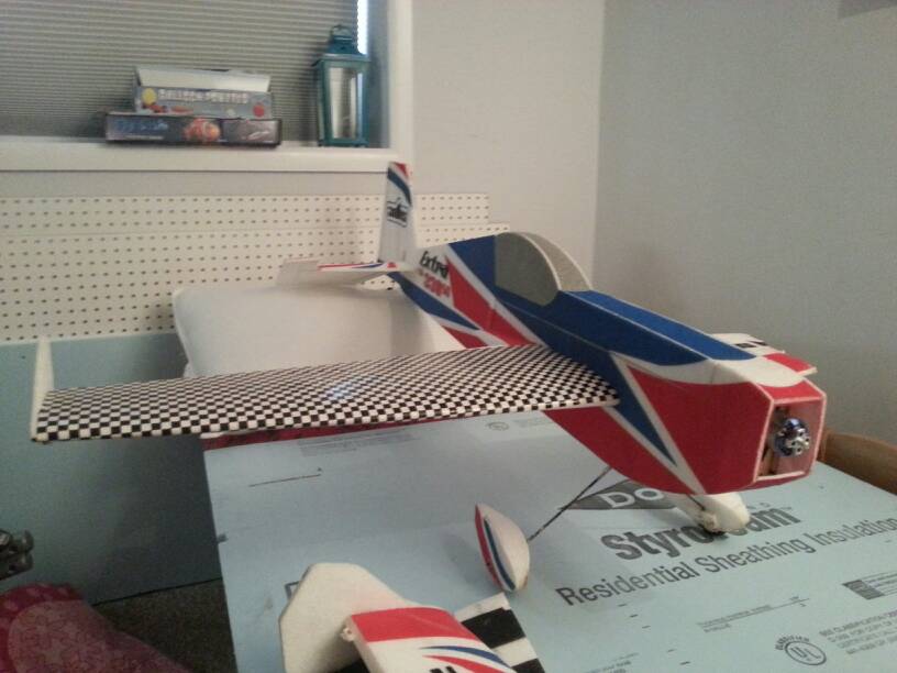

On another note, made a little progress on the extra
Glued wing w welders and covered with duct tape. I have the bottom untouched as the joined section now has a soft spot that I need to fill before covering and I'm wondering the best thing to fill with. I'd love to use expanding foam, just don't know which and worried it will over expand and cause more damage than good. Any ideas?
Also may have to recover as I read after that you should spray, 3m 77 adhesive on before taping since duct doesn't always stick to epp well. I'll check adherence and do that on the other side..

Houston we have a problem..... Apparently welders is reacting w something inside the inner wing which is different material from the outer epp wrap and that's why I have a cavity around the carbon shaft and area I glued....what's a good injectable filling foam? Help ;)
Gorilla glue. But I'm not sure if it is safe with all foams.
I think it was mentioned somewhere once that those planes have a depron core, and that's probably what is being eaten away.
I think its the same as a wattaplane, with a eps core in the wings. welders, shoe goo, and regular ca can seep down and melt the foam.
This is why I use gorilla glue on these bad boys.. it will expand and fill that gap where your foam melted away...
