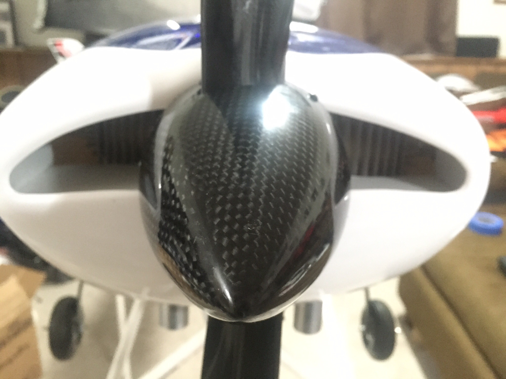

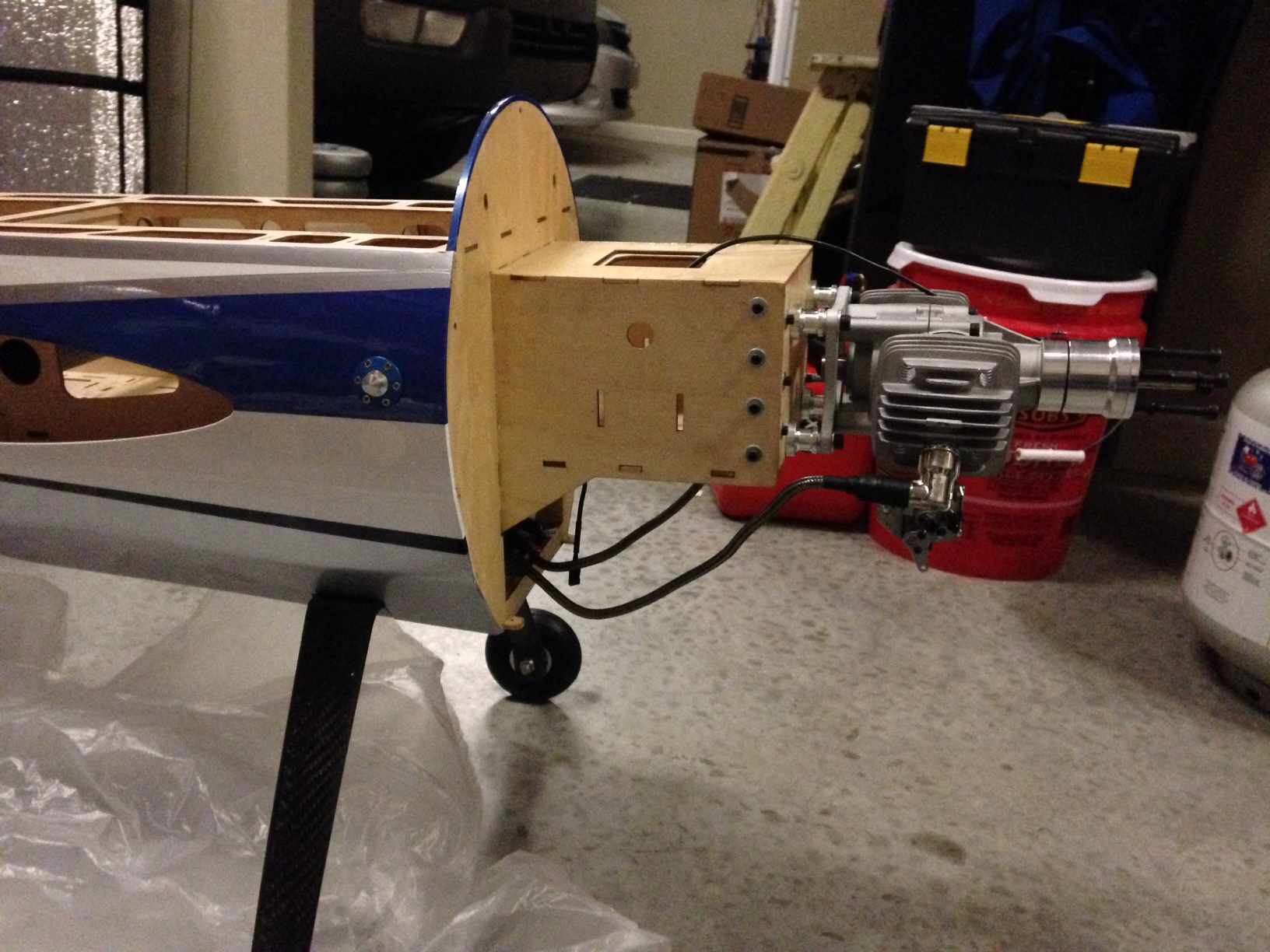

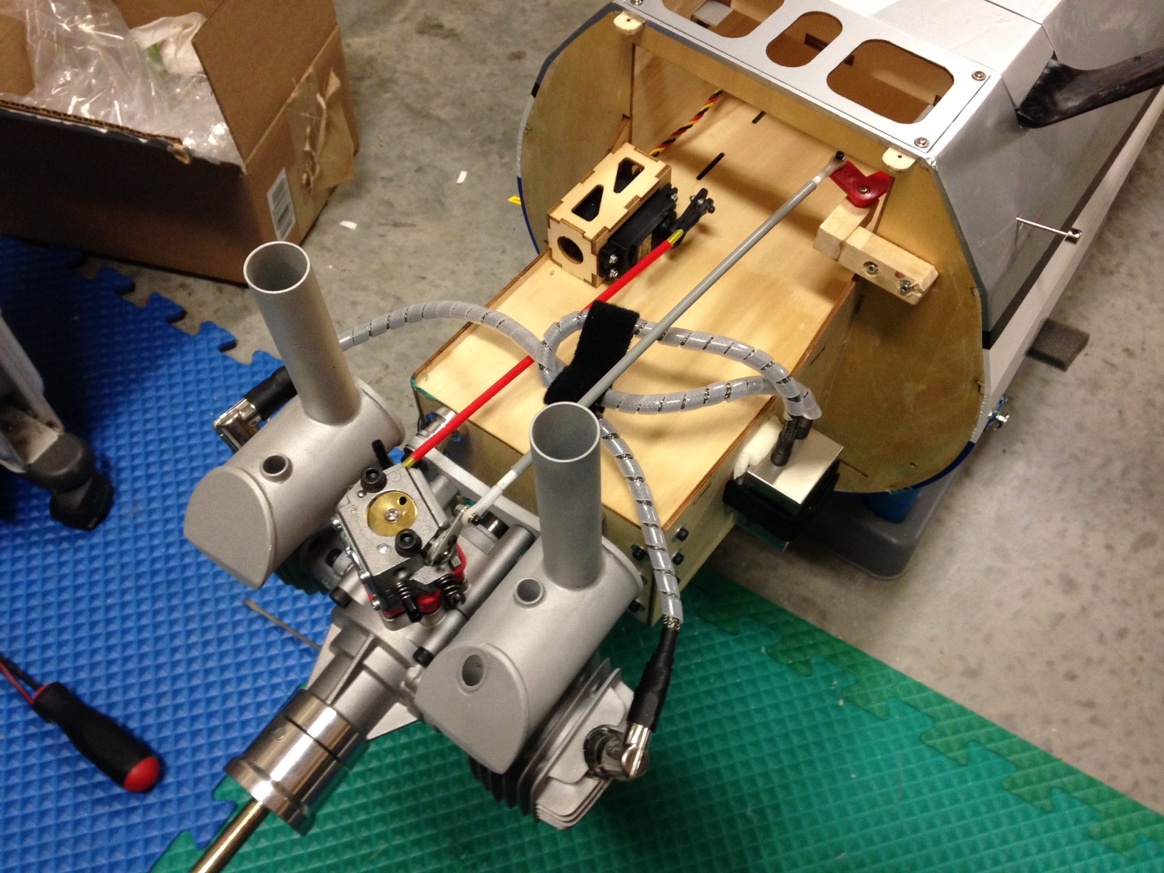

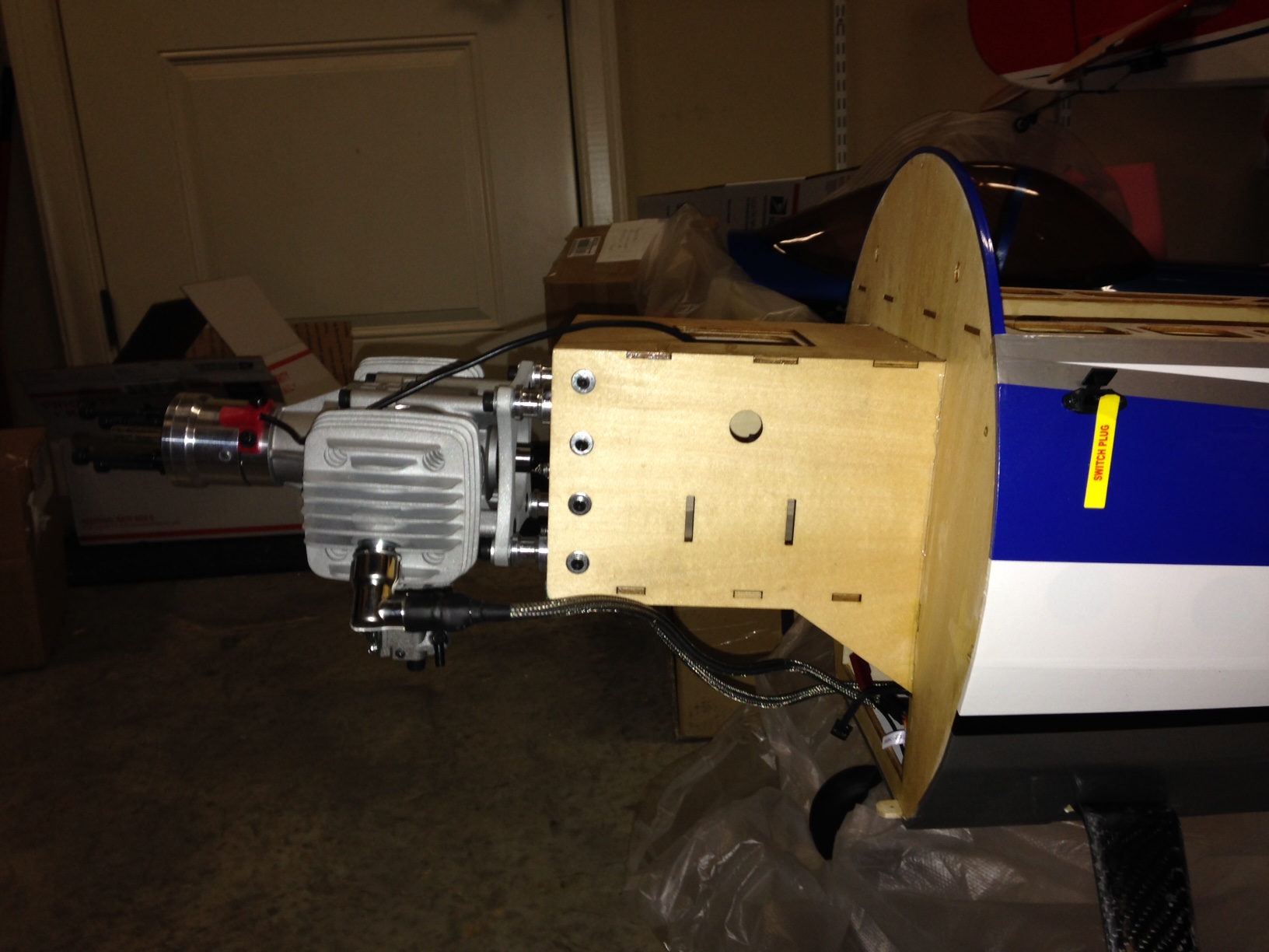

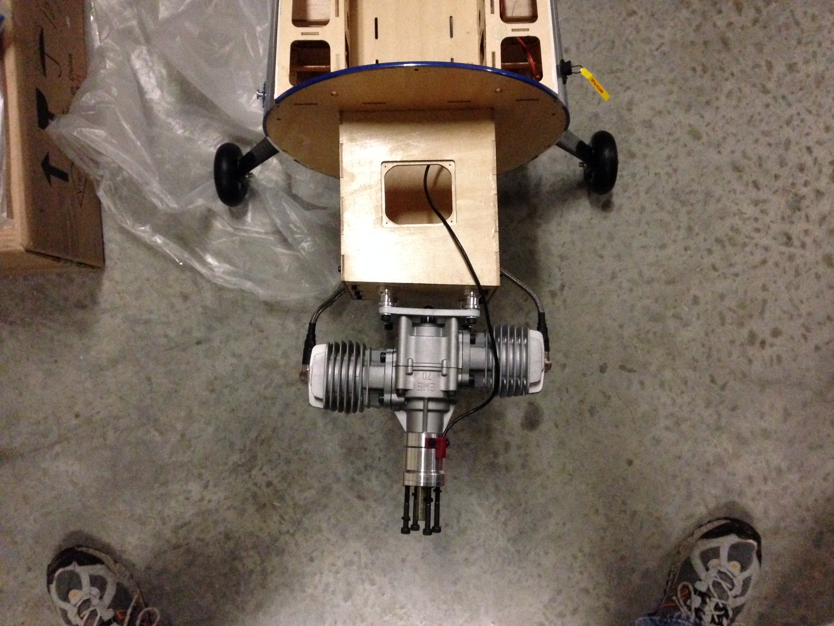

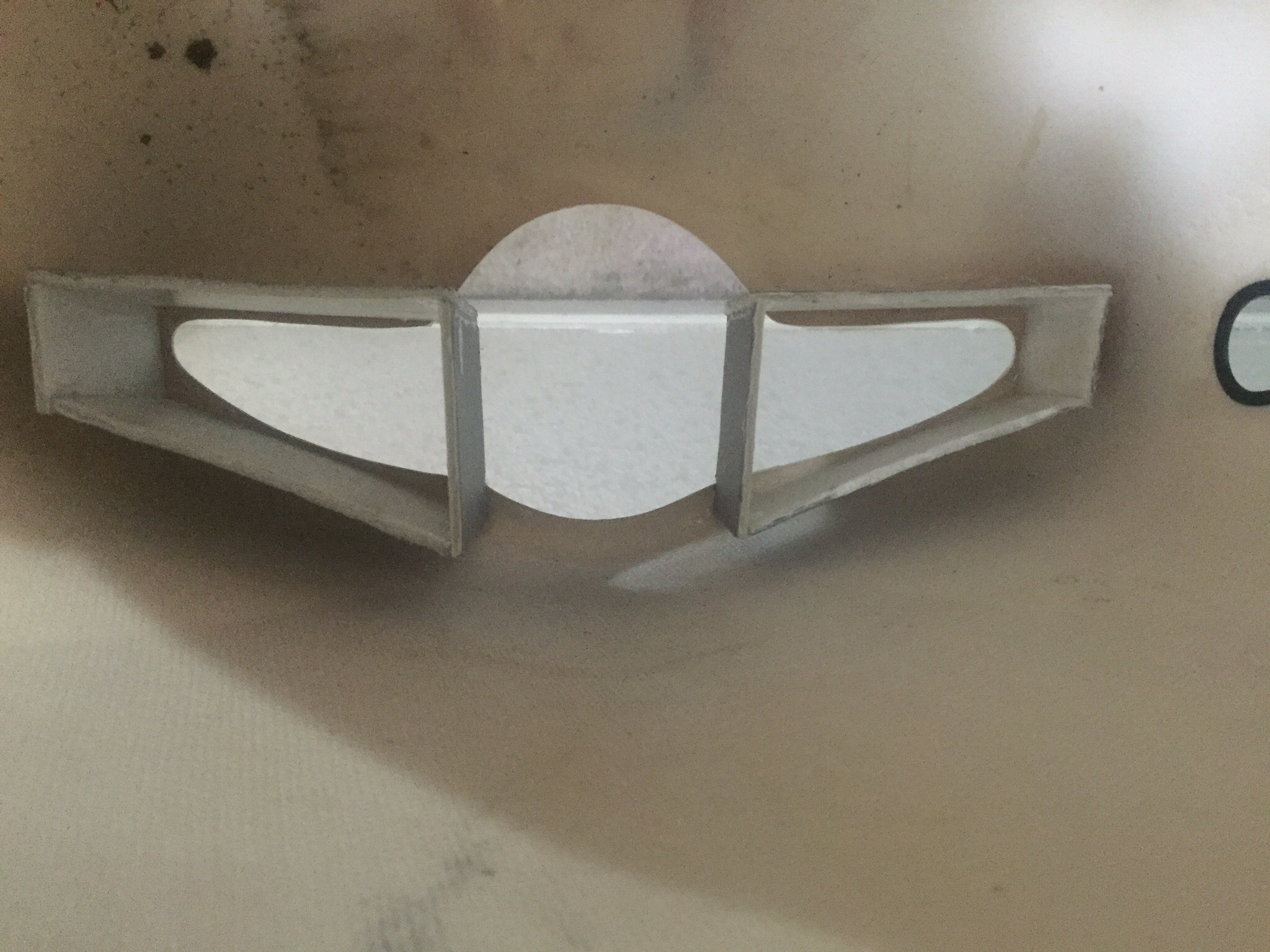

I was having some temps reaching 330°F with throttle management on the DA70 until I baffled it. Now temps are in the 230-285 range no throttle management needed. It's getting pretty hot to dead stick. Temp sensor proved handy to me.

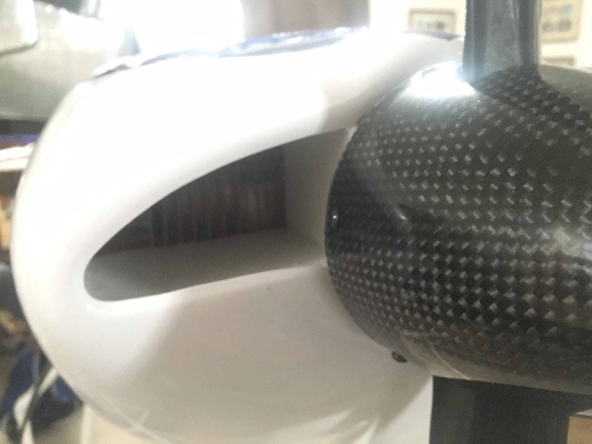

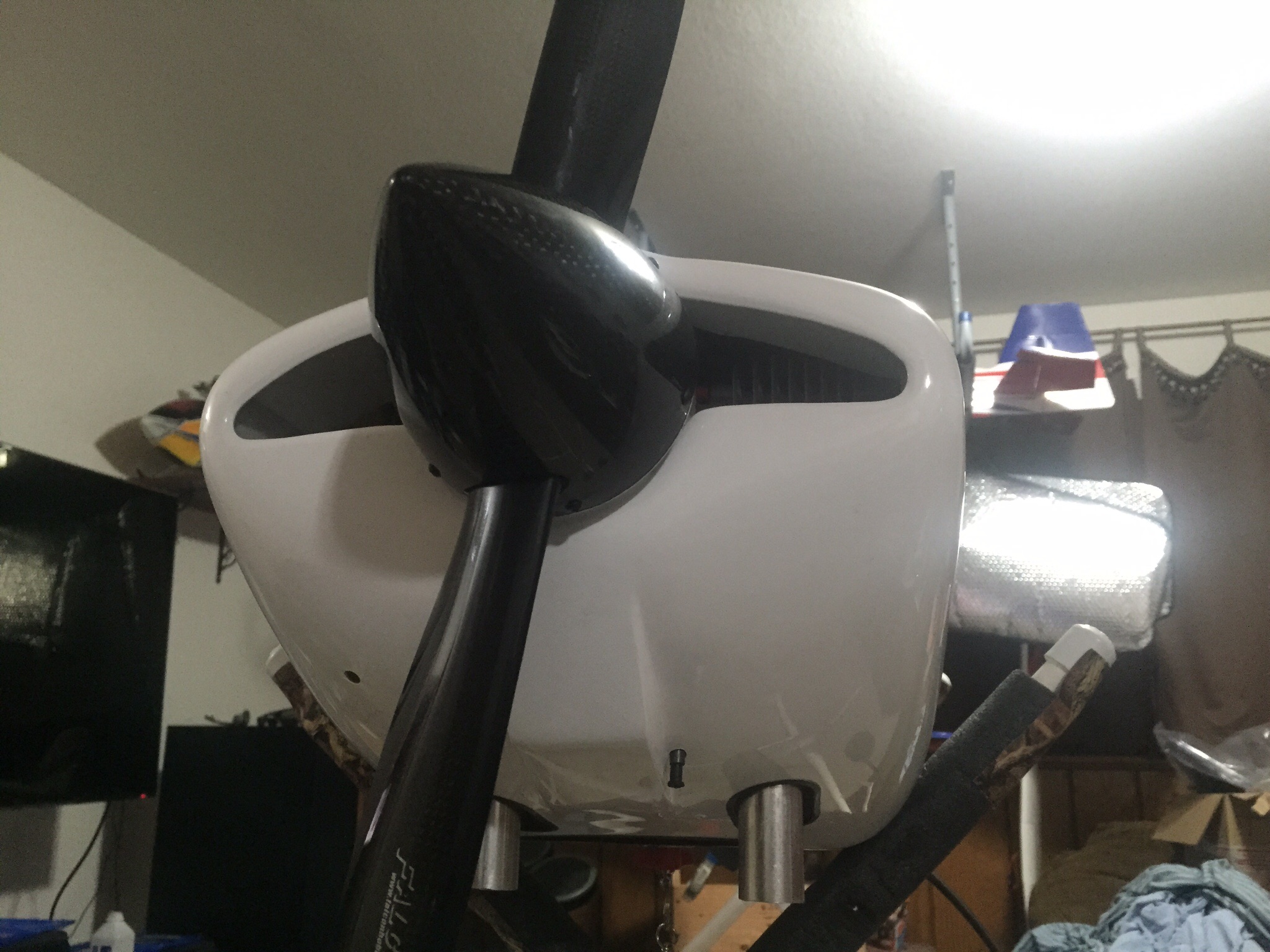

Hmmm... don't know what the temps were on the back of my cylinders, but the front was 185 about 5 minutes after it landed from the dead stick. So I figure the front was 200-210 in the air, and back of the cylinder likely 275+. Doesn't sound like that temp is too much for you, but I was having extremely noticeable power issues, wouldn't spin up, and then died. I will be baffling it this week. Bought some foam today, and ordered the EF cowl insert from their 88" Yak. Hopefully I can make it work and not look too bad.
